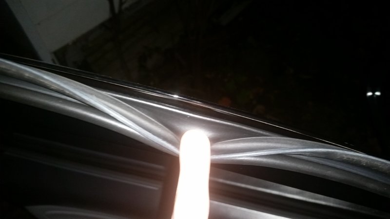

    Thanks a lot for responding OP. This is a bad pic due to it being dark, but was hoping you could confirm this is where you taped the seal to the door before I went taping up my truck?
    Thanks again.

    I put the tape on the door itself, the inside skin, not the outside, but it's important that you diagnose where your leak is coming from, then seal that area. Find a road with little traffic, get up to speed, then press on the gasket until the sound stops. That's the place you need to seal up.

    Sorry just having hard time figuring out spot you're referring to. For me, it does not stop the noise by me pushing on the seal. I have been trying that while driving for a few days.
    I still believe its the issue you're talking about because it sounds exactly like wind is just able to "wush" under a seal. If you get a chance and can take a picture of where you taped it, I'd really appreciate it.

    It's the top of the window gasket - not the door gasket. I followed directions on page 2 of this thread and was able to eliminate wind noise right away. What remained is an annoying squeaky sound, gasket rubbing against the door. I tried clear silicone, it didn't bind well and squeak was bad. Removed the silicone, replaced with 3M gasket adhesive, still squeaked. It took me a while to figure out that I needed to glue the entire top edge of gasket to the door. As soon as I applied the adhesive I used a bunch of masking tape on the inside of the door to keep the gasket pressed against the metal and let it set overnight. No more noise. I'll try to get pics.

    Really appreciate the additional details. As you know this is such a frustrating thing to be dealing with on a new vehicle, so it's good to know there are solutions working for others if the dealer can't do anything.
    Is the spot at the top of the door that you applied the adhesive to?
    (this is the top of open door)

    Sorry, it's hard to tell what I see here. Is this "upside down" view?

    yea sorry about that. This is the birds eye view of the door with the door open.
    So my finger is in the seal at the top of the door.

    Mine was leaking through the TOP of the window gasket. Your picture seems to show the bottom of the window.

    The gasket that the window glass slides into? Or the one that seals window/door to the cab?

    My problem is I can't get the noise to stop by putting pressure anywhere inside the cab while driving. So I'm having hard time pinpointing where I should do this and don't want to put a bunch of mounting tape in the wrong areas.

    Yes, that one. It needs to be permanently attached to the door, preferably to the inside edge of the door.
