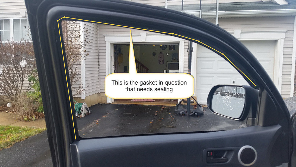

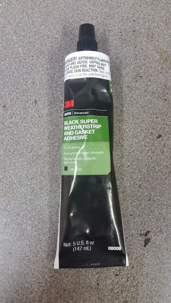

    Ok. So I tried a few different things and had mixed success. What worked for me was the 3M black weatherstrip adhesive. Double-sided tape did not, possible because like many of you, I wasn't clear on its use. I did the top of the window with 3M and it eliminated the whistle, but later I developed a squeak on the side portion of the gasket where rubber rubbed against metal every time truck hit a bump. These are not the smoothest riding vehicles. So today I applied it to the side part, which makes the gasket pretty much glued to the door all the way around. This is the adhesive I used:
    This is the gasket that you are working on. You can do it from the inside or repeat the procedure on the outside if you want extra seal:

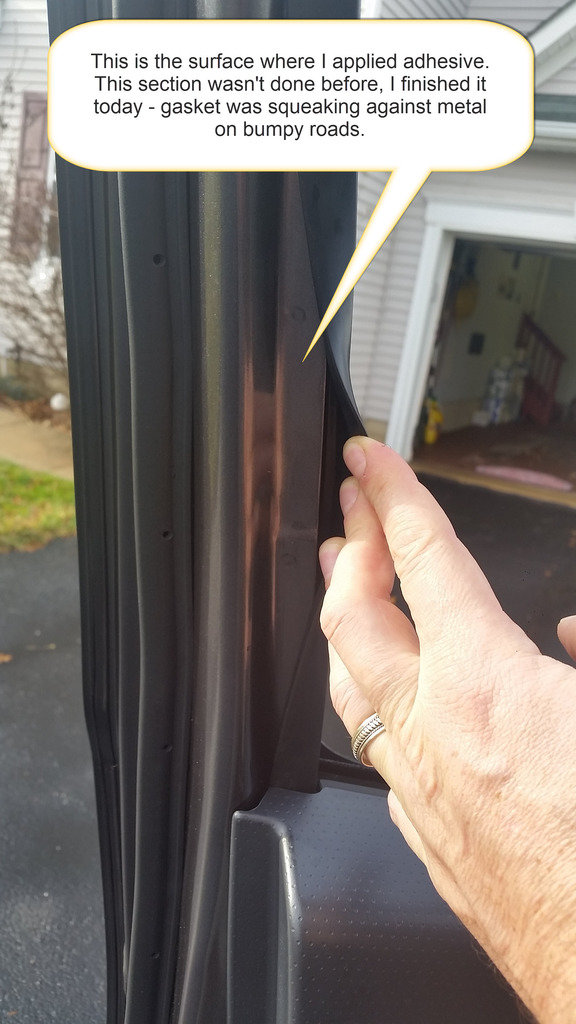

    Peel back the gasket (it's not attached) and applied adhesive. In my case, it was needed all the way around and previously I only did the top half - so I finished the job today:

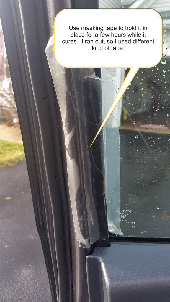

    Roll up the window as soon as you apply adhesive. Put some tape, or something better to hold it down while it cures. It's 70 degrees in NJ today so it shouldn't take long.

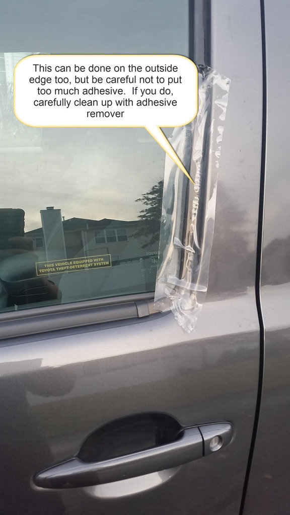

    You can do the outside too, if you want.
