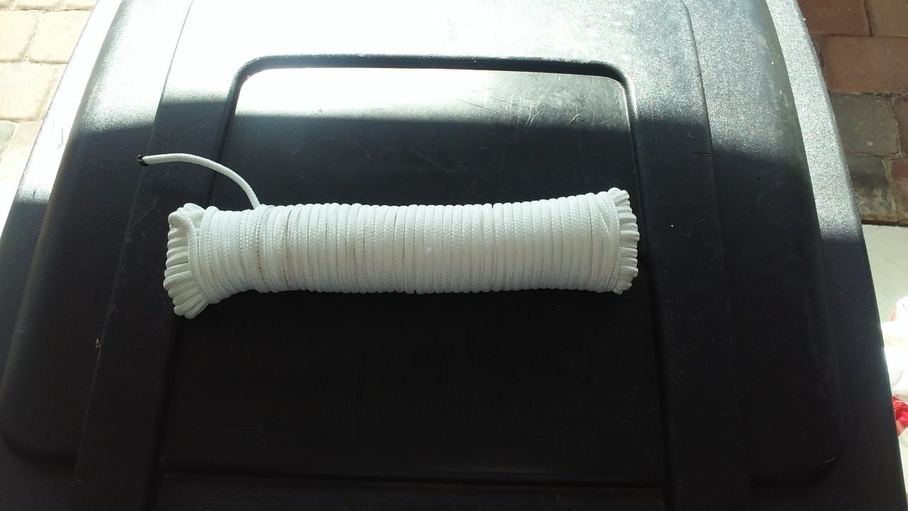

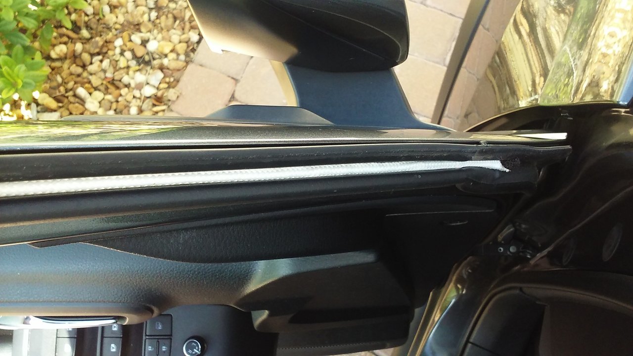

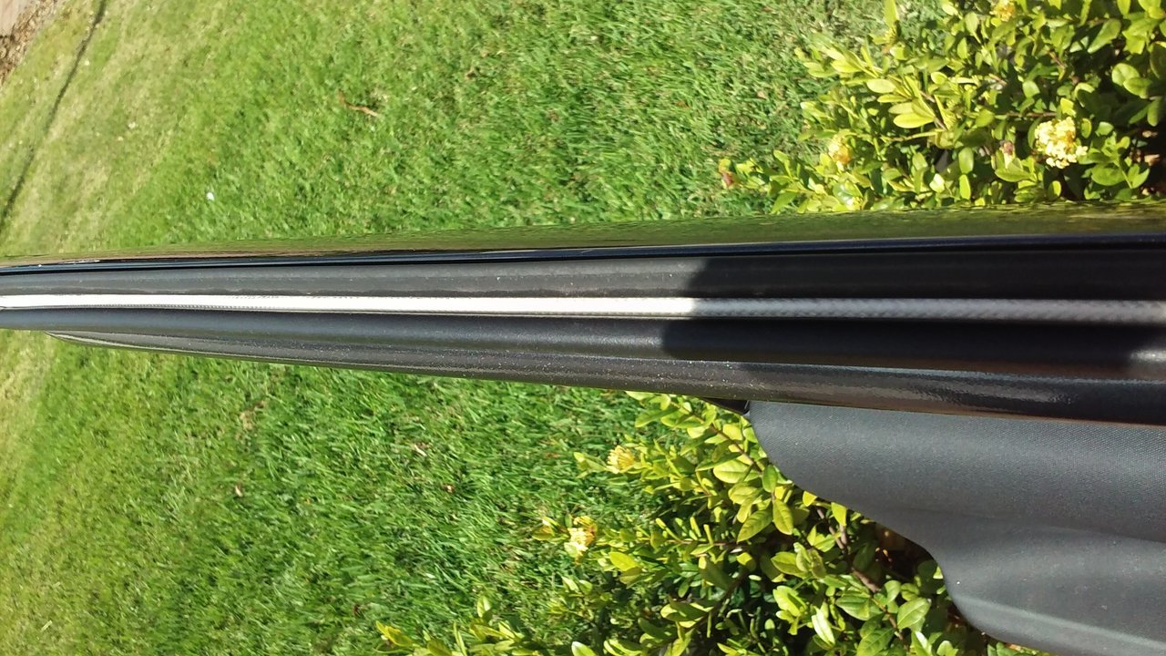

    I also have a wind noise, especially if it is a windy day. I had some 1/4 " cord in my garage so I decided to experiment. I put a length of the cord in the drivers side door seal. no glue or tape, just the cord. I have not heard the annoying kazoo noise since. On some occasions I think I hear a slight noise. Nothing like before.
