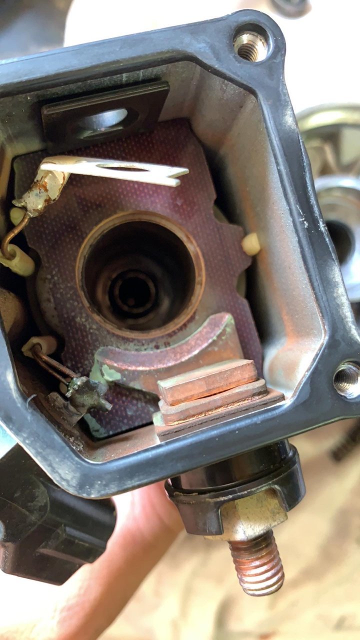

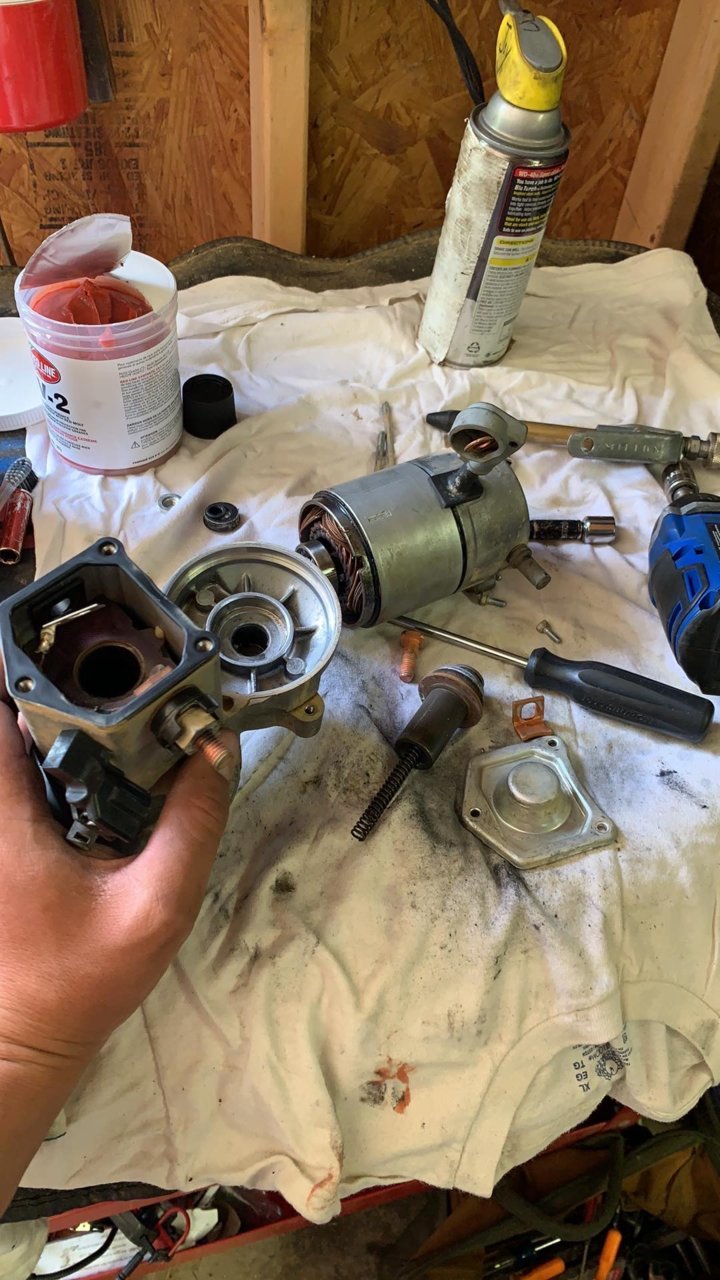

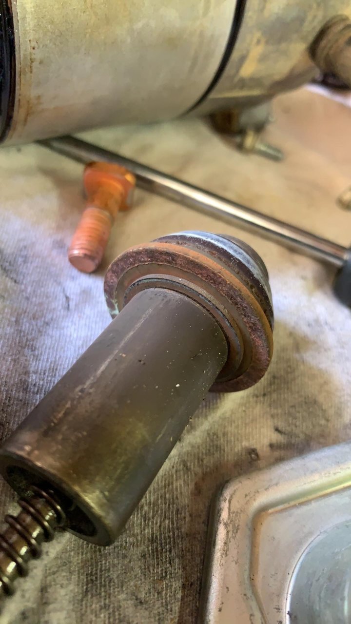

    HappyGilmore
    HappyGilmore LambTek Innovations
    Dec 24, 2018
    #276792
    2,978
    Huntsville, AL
    2013 SC’d DCSB TRD OR 4x4 | 2012 Lexus IS-F
    Yes
    I will say.... last time I was there when the water was a foot higher than it was when we went last weekend...
    8 out of 10 Toyota's (including mine) had starter issues. Everyone had to replace or rebuild. I opted to open mine up and clean the copper contacts off with a wire brush and it fixed it perfectly.
    I've noticed that the water in that creek has some different minerals or something that reacts with the contacts in the starter and creates a lot of corrosion very quickly. @Brian422

    well shit, thats most likely it. That helps big time. What did you use to clean?
    cubie and HappyGilmore[QUOTED] like this.

    That's what I am thinking. I used a combo of wd-40, brake cleaner, and a small wire brush from HF and possibly a brush that can go in the end of a drill.
    Threw some grease on the appropriate bearings, slapped it back together and haven't had a single issue since.
