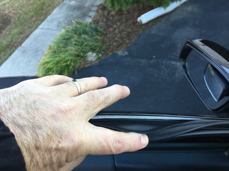

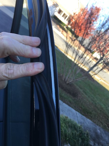

    Truggin
    Truggin What a long, strange trip it's been
    Jul 14, 2016
    #191997
    8,496
    Don
    39.15737720308645, -77.92212986904099
    Black 2016 TRD Sport V6 4x4 Access Cab
    It's a work in progress. See my build thread.
    So... I took this idea to a slightly different level. I thought about it and decided to simply use some clothesline rope instead of grocery bags. Installation took about 5 minutes per side, and after a test drive (at ~80 over a mountain with a fairly strong crosswind - no noise! It is only one test drive, but I made the same run this morning prior to the rope, and the noise was nearly constant. Since I used cotton rope, I will monitor for wetness, and replace it with nylon if necessary.
    Here are some pics:
    2016Tacoman and buzzkill911 like this.

    Update... I'm declaring this a success. No more noise. Fixed in 5 minutes (per side) with about $0.50 worth of clothesline.
    EDIT: 2 weeks later... I just got home from a 100 mile drive up I81 in Virginia. Very windy today, and I noticed it does still make the noise. But at a greatly decreased volume, and only when both speed and cross wind were excessive.
