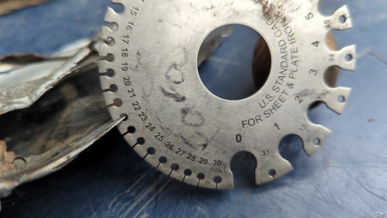

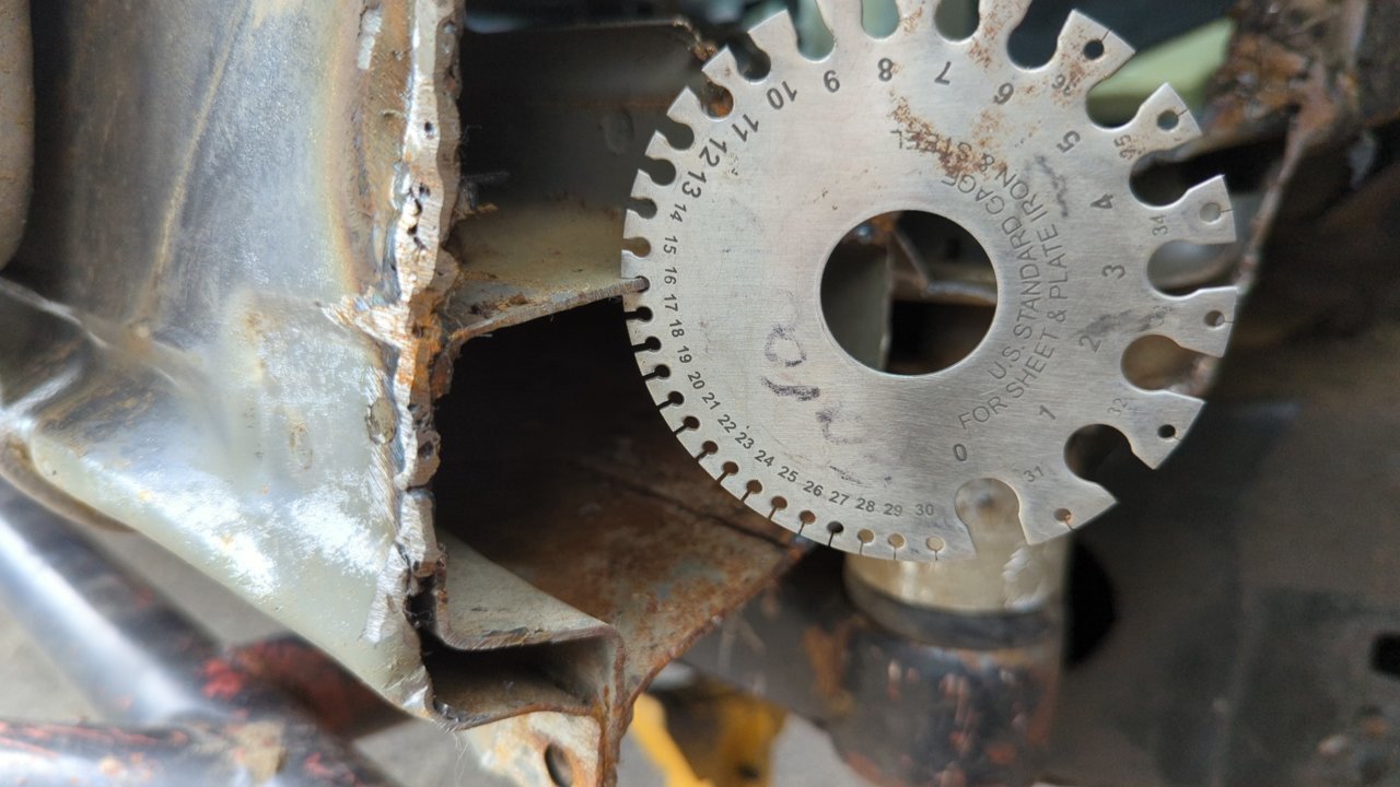

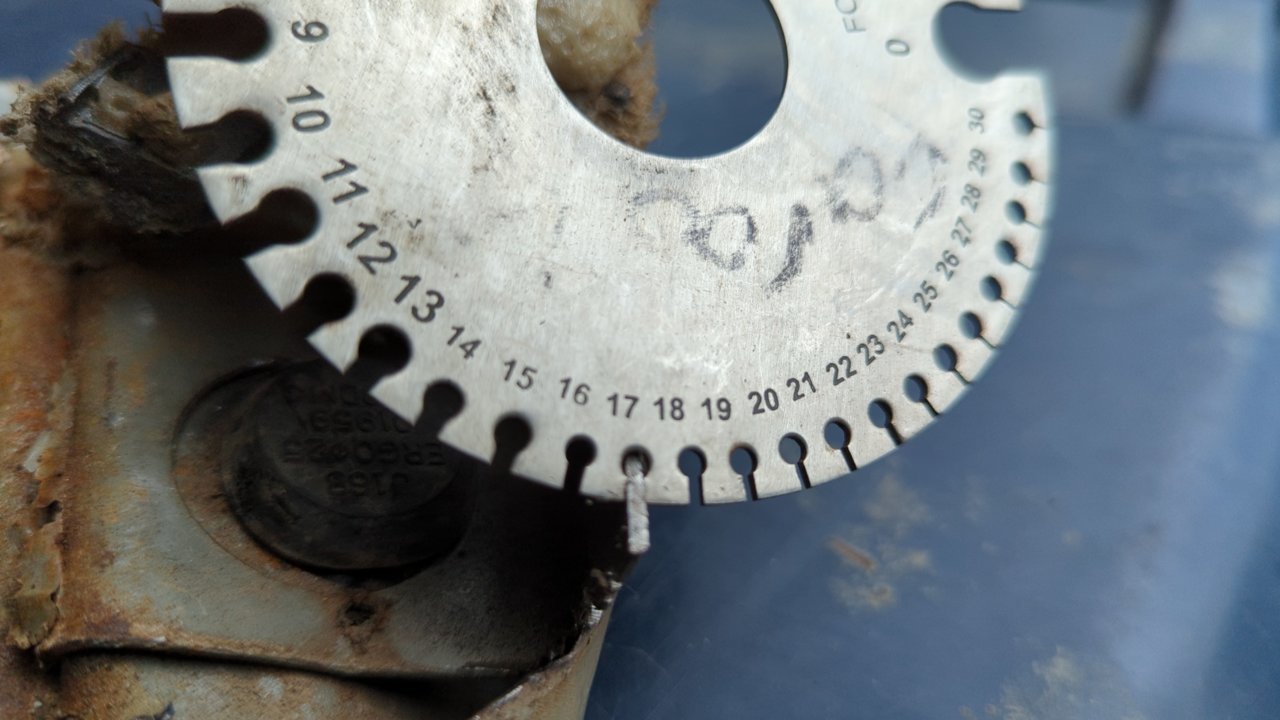

    Welded up some seams and now figuring out what thickness metal I need

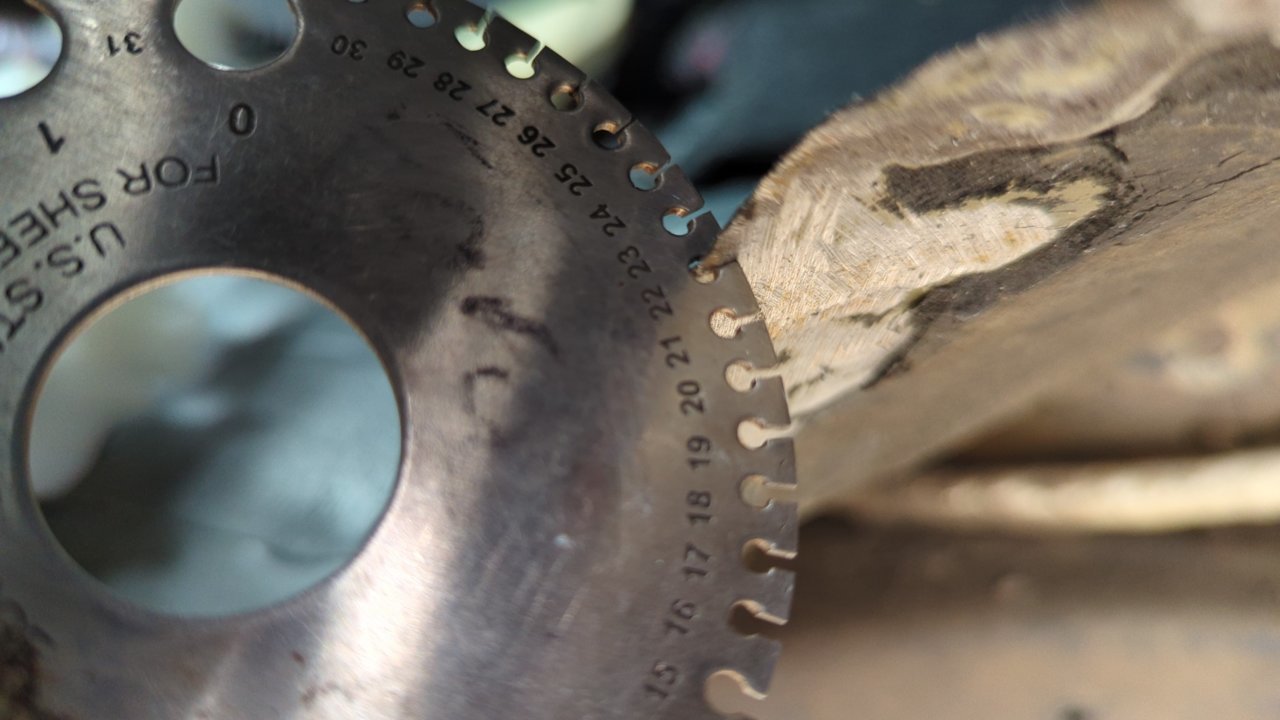

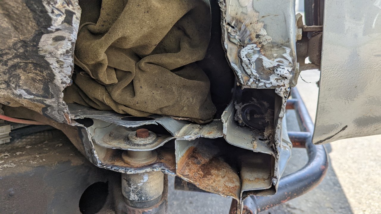

    The pinch seam metal

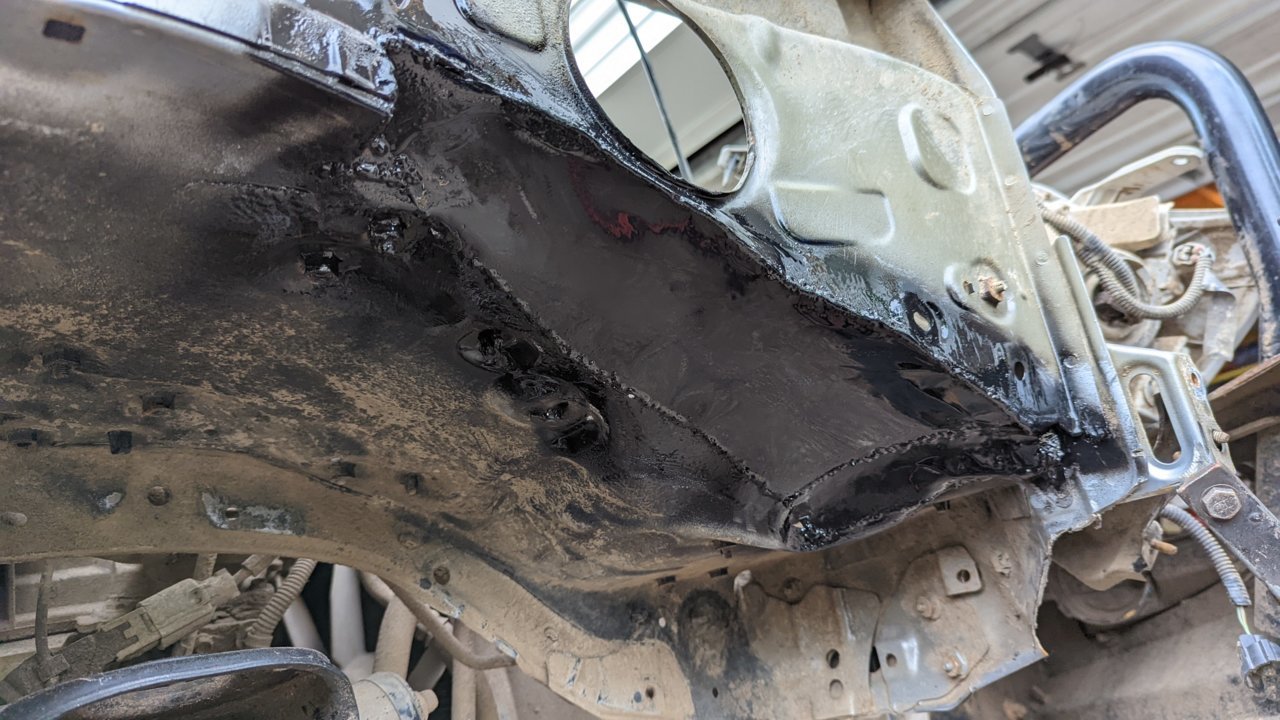

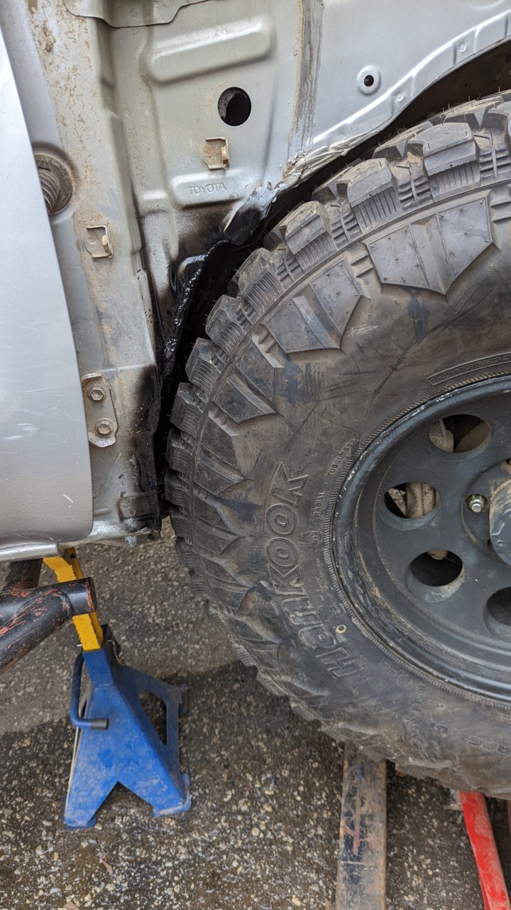

    The wheel well area.

    Went right to the wheel well this time. 22.

    And again pinch seam area

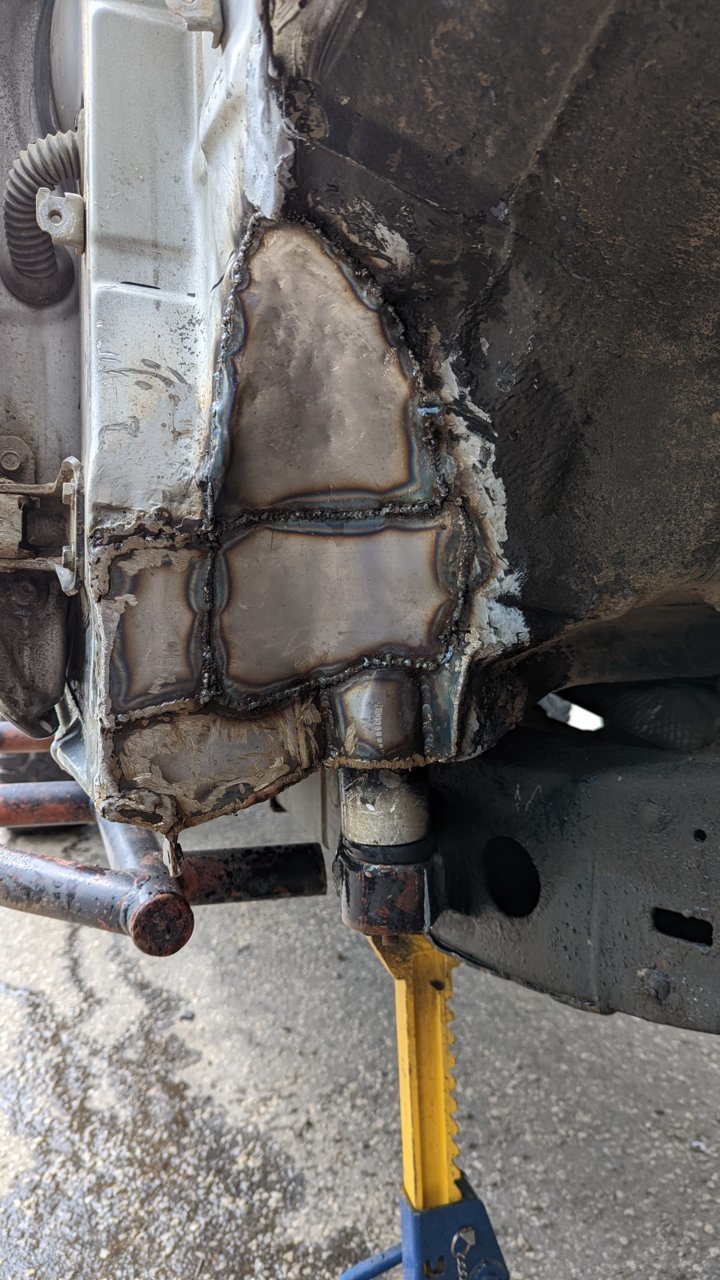

    Not the prettiest but right side done
    first pic is of the right front neer the headlight
    2nd pic is the right side wheel well area 16ga on the bottom and 2 pcs of 22 ga. on top.

    test fit a wheel to make sure it did not rub, well it dose on the uca, oh well I'll figure it out
    but lock to lock its very close but no rubbing, of course when on the trail under load who knows cause its very close.

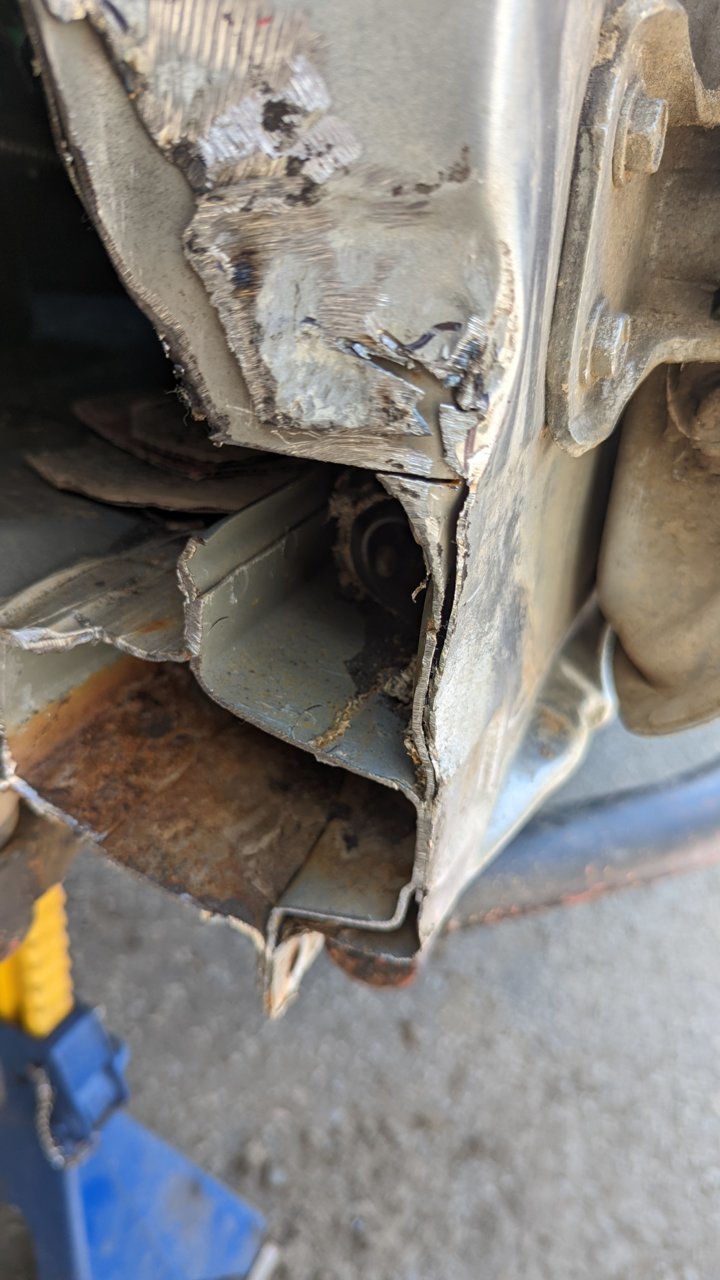

    Repairing some cutting wheel mistakes.

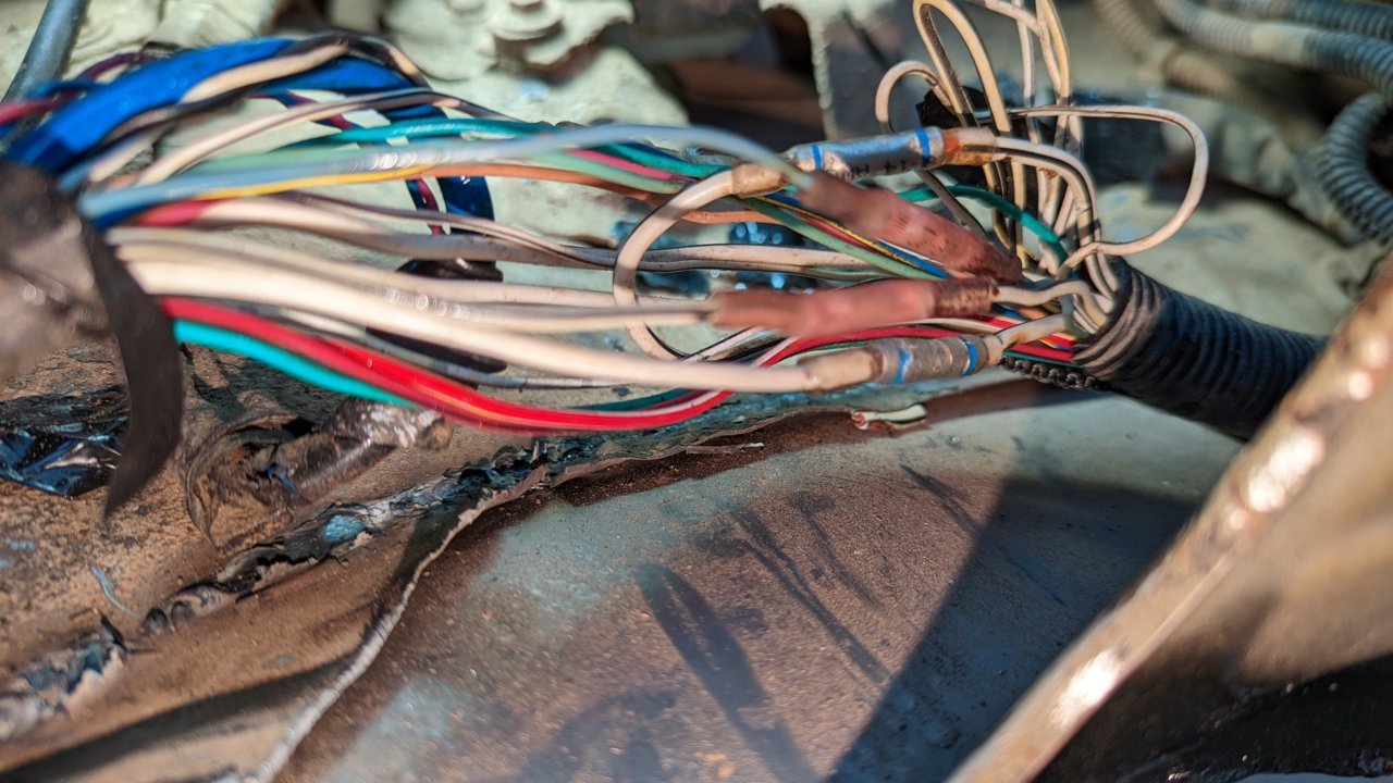

    Just a note to let everyone know what you loose.
    you windshield washer bottle will not bolt up any more
    your floor space will be lost both sides
    your carpeting will not fit right
    your side kick panels will not fit right
    our wiring harness behind the kick panel left and right will not fit right
    your battery tray will not be supported as well as before it will shake
    right side wiring harness will not be clipped in anymore
    if you have a snorkle and want to keep it you have to cut out the round hole where the rubber hose goes through the fender
    the intake tube from air filter to fender is affected
    when you drive your left foot is up a bit and the foot rest pad left side will be non exhistant
    if your truck is standard like mine check clutch engagement at the floor when cutting its a little to close but mine is ok
    after I get some 37's I'll honestly let you know if it was worth it.... jury is still out on this mod...
