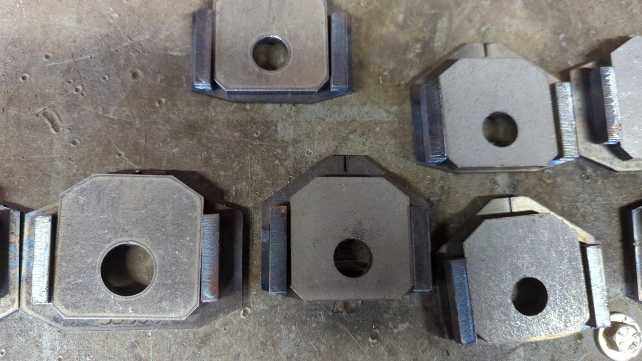

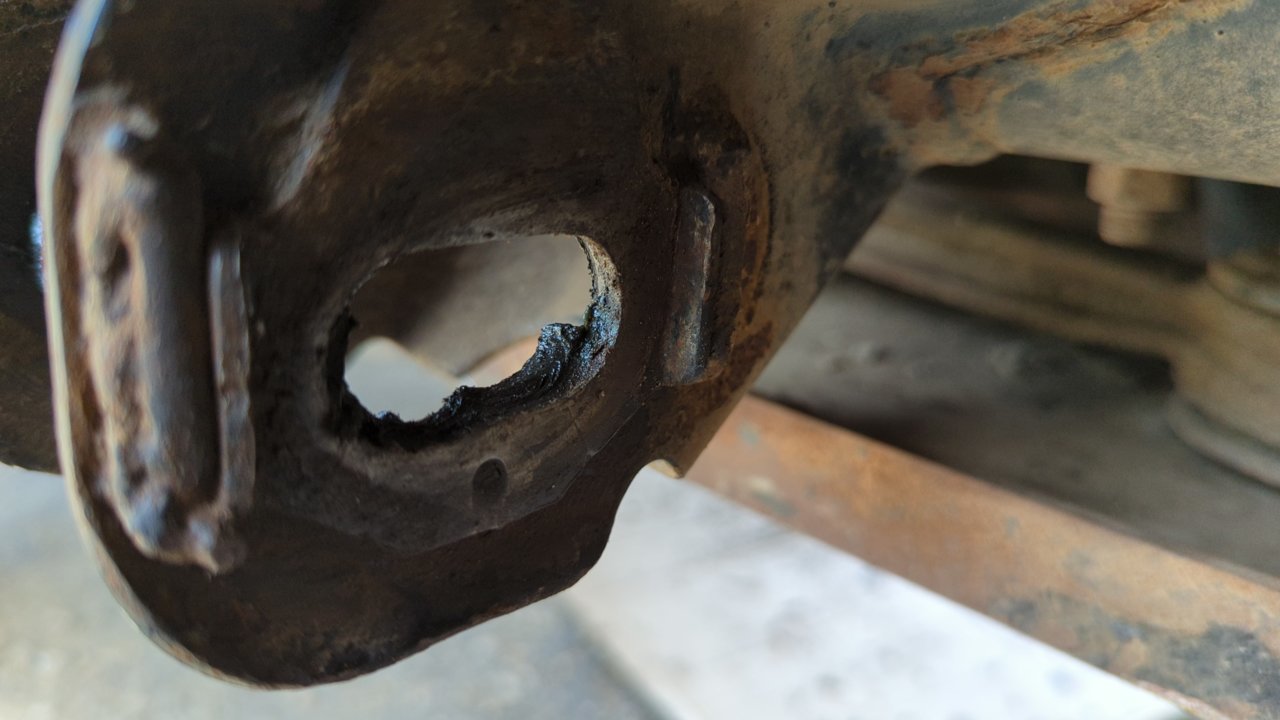

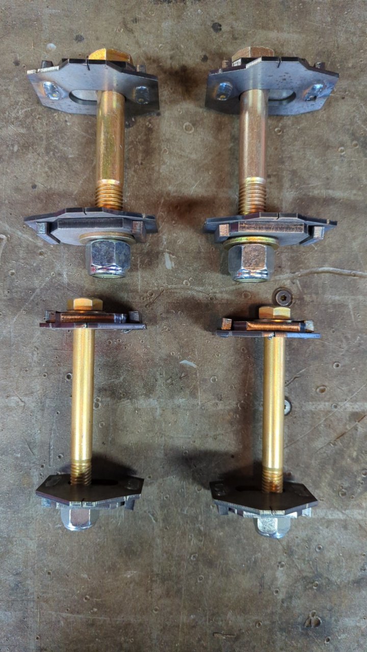

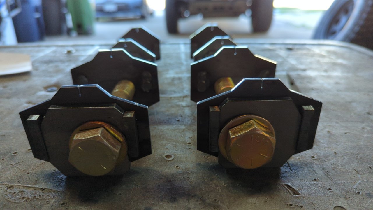

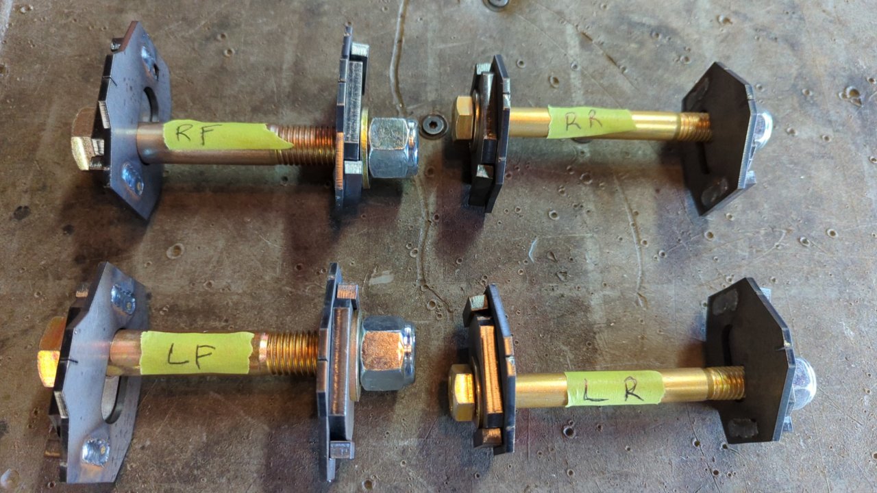

    Not ready to install these but just wanted to see what they look like.
    This is so I get another set of eyes on it so I don't make a mistake....

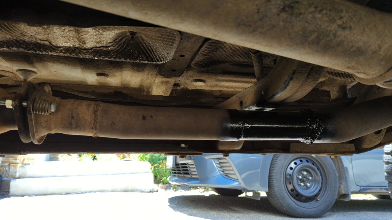

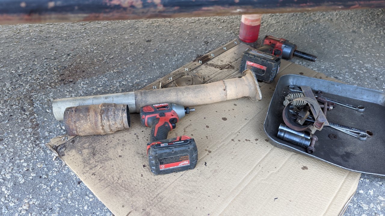

  3. Aug 12, 2022 at 10:07 AM
    #263
    Windigo
    Windigo [OP] Well-Known Member
    Dec 21, 2019
    #313884
    4,099
    Farook
    Toronto Ontario Canada
    '14 Acess Cab

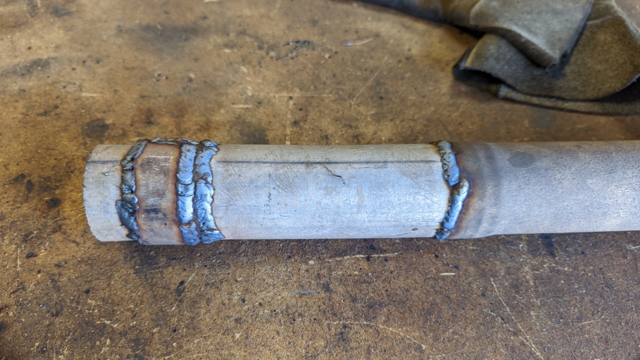

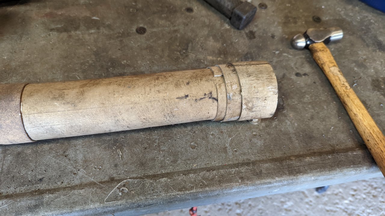

    I think 2 years ago my exhaust fell of on the trail, I had some wire holding it up then some hose clamps. I decided to bite the bullet and just fix it today.

    Looks good!
    Those cam tabs are solid.

    They fit sloppy at first but I think the trick is to squeeze the gussets and cam tabs together in a vise to get raid of Any play. Hopfully it will stay like when I install them. Thanks for the comment.

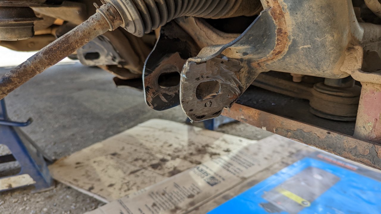

    Back at it again.

    And off they come.

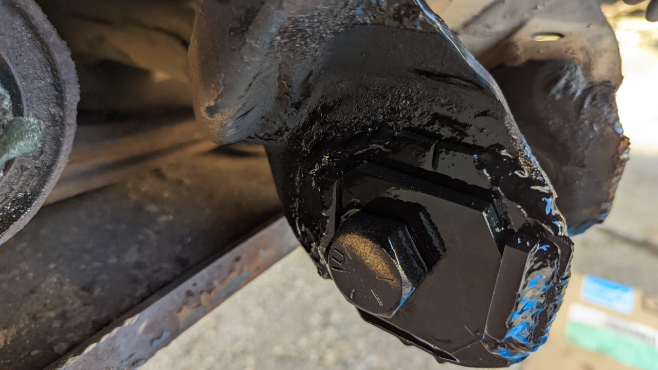

    That was fun. :) paint looks funny because I didn't wait for it to cool, just figured it would bake the paint in. lol

    Looks like that gap was taken care of, if it moves now I’d start worrying about other things.

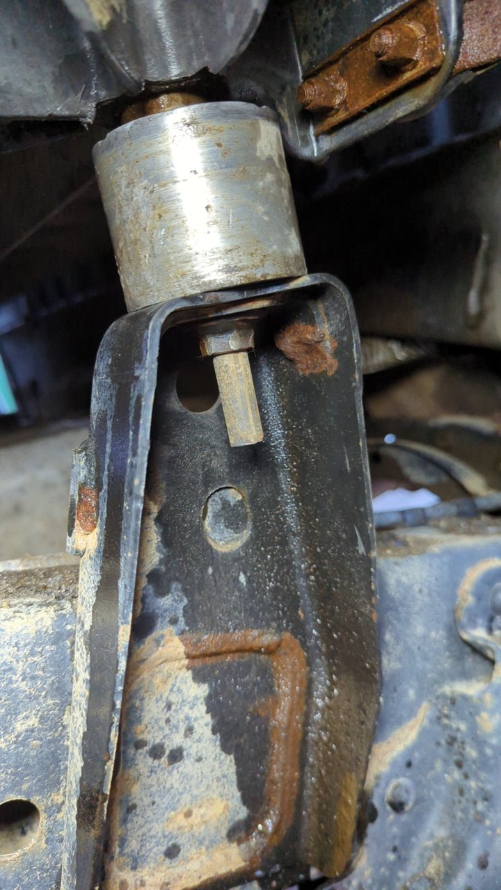

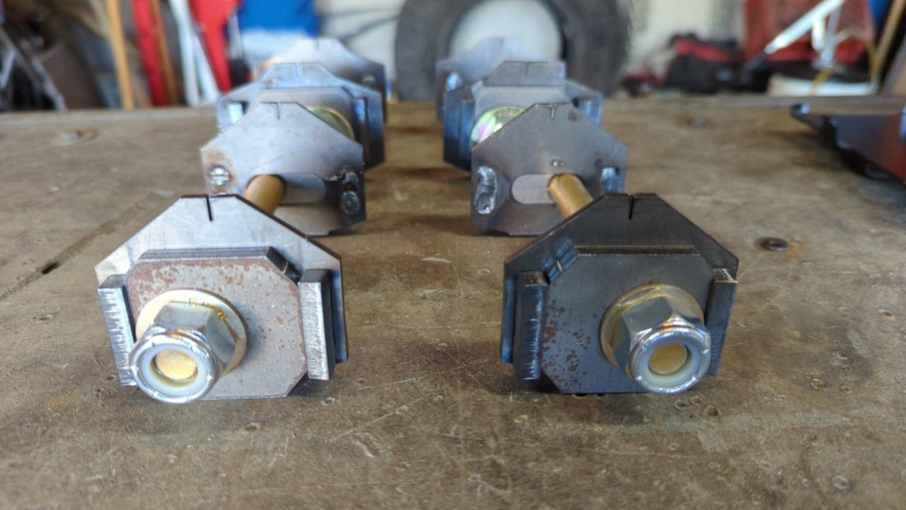

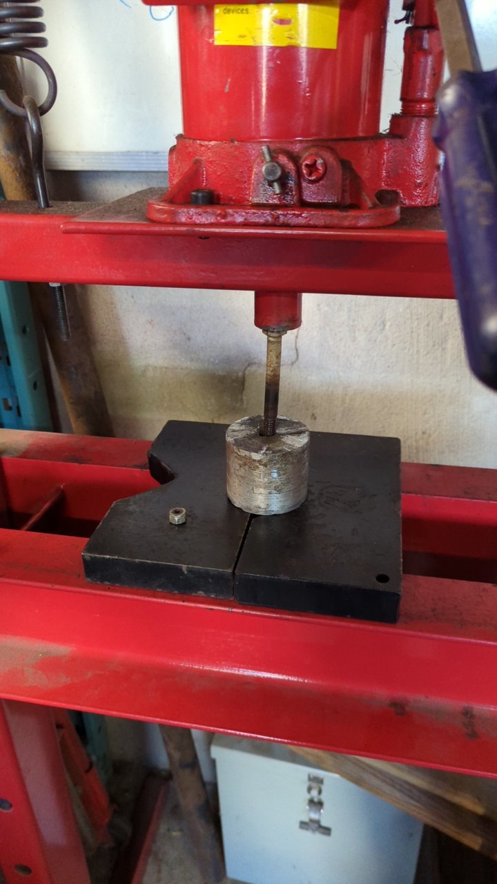

    so these cam eliminators tabs will not work with whiteline bushings. Period.:frusty: ugh... more problems

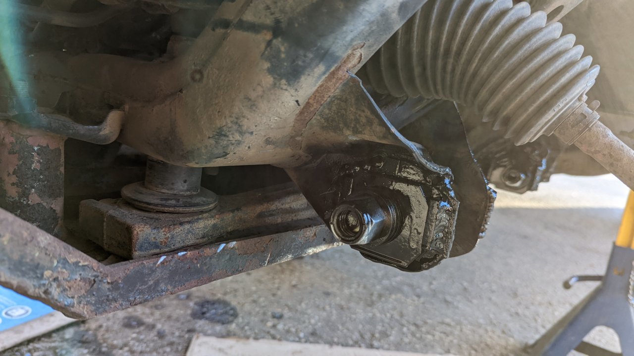

  13. Aug 16, 2022 at 5:13 PM
    #273
    Windigo
    Dec 21, 2019
    #313884
    4,099
    Farook
    '14 Acess Cab

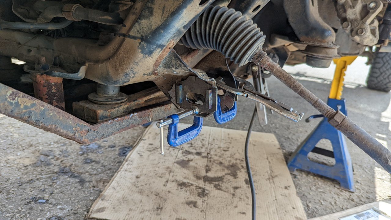

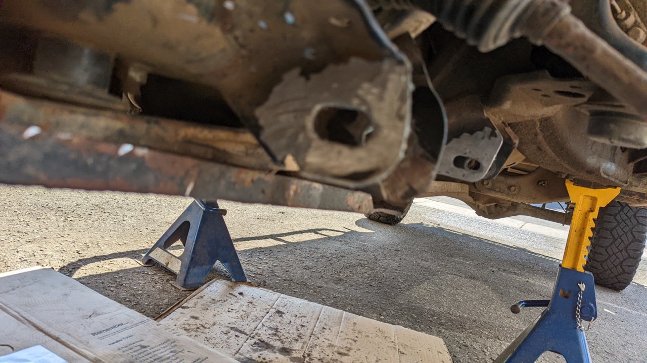

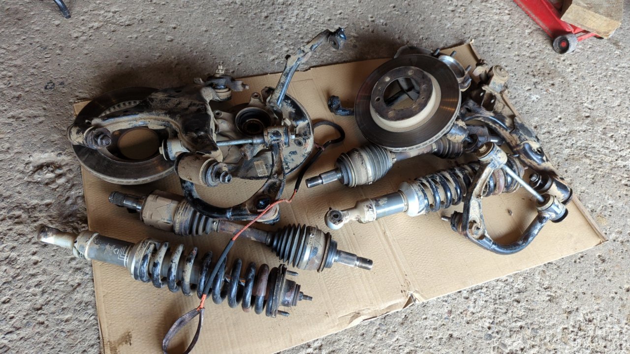

    so quite the eventful day:)

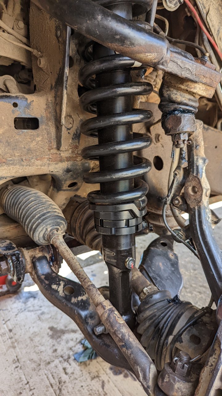

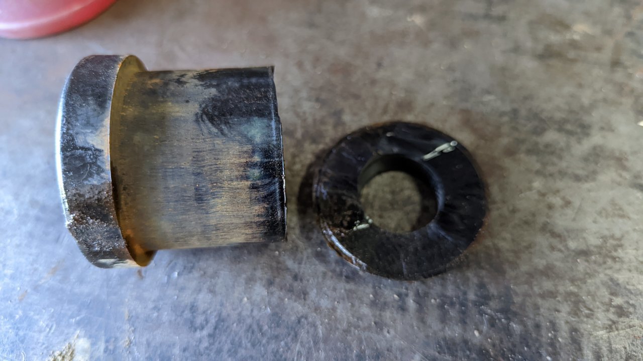

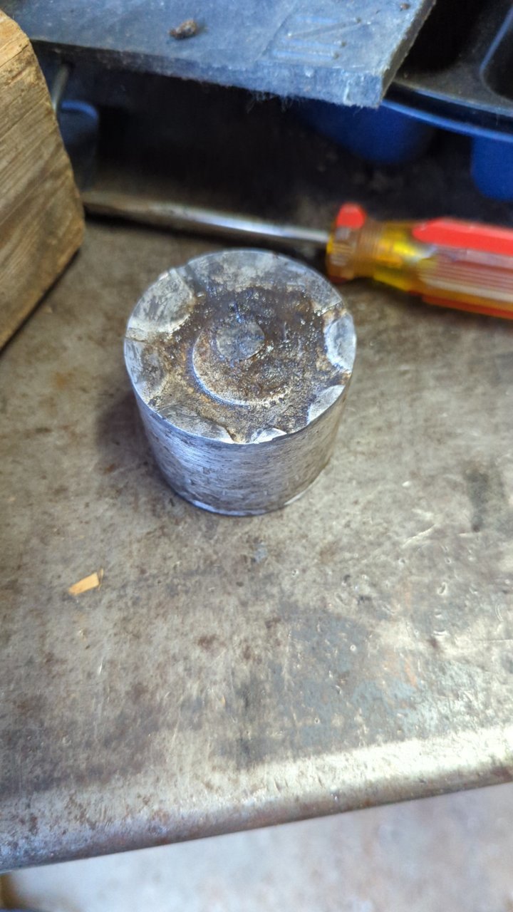

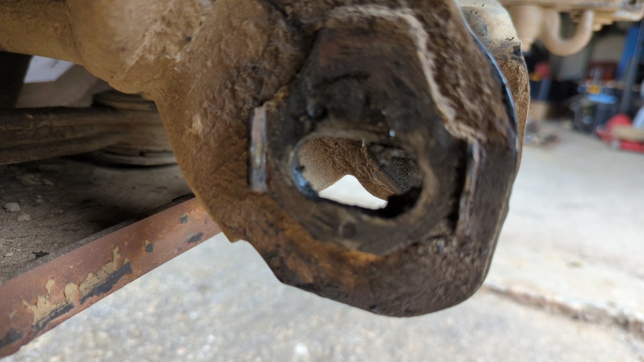

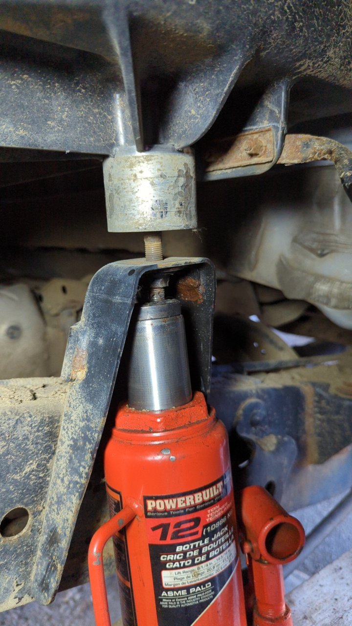

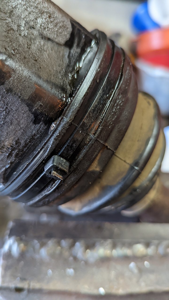

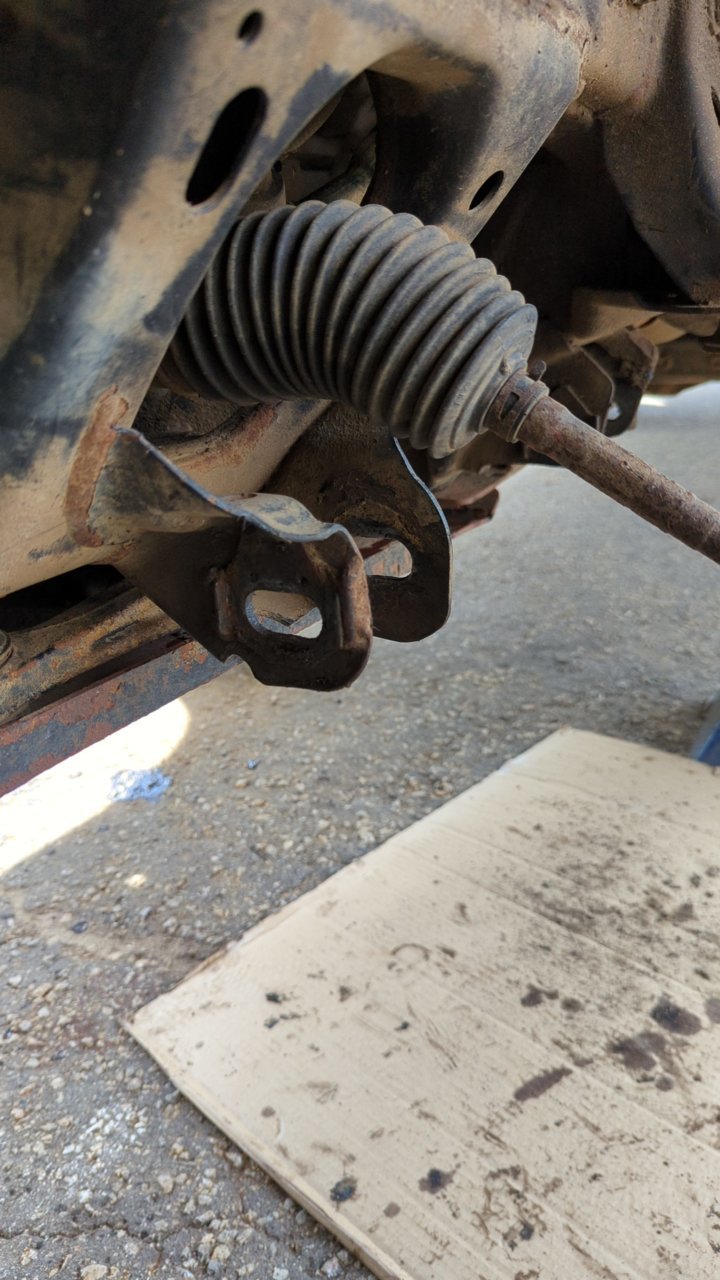

    pic 1 did not have a cv clamp so improvised lets see if it holds
    pic 2 did not know you have to cut the spc control arm bushings out...

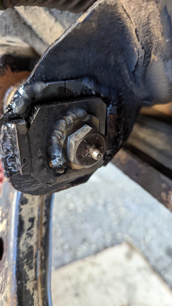

    pic 3 had to reuses my lca greasable bolts with the 333 tabs. problem is the hole in the tabs are to big for thoes bolts but those bolts fit into the white line bushings. so ended up welding a washer to the tabs that fit the bolt. just a pain but I may be old but still think quick...lol

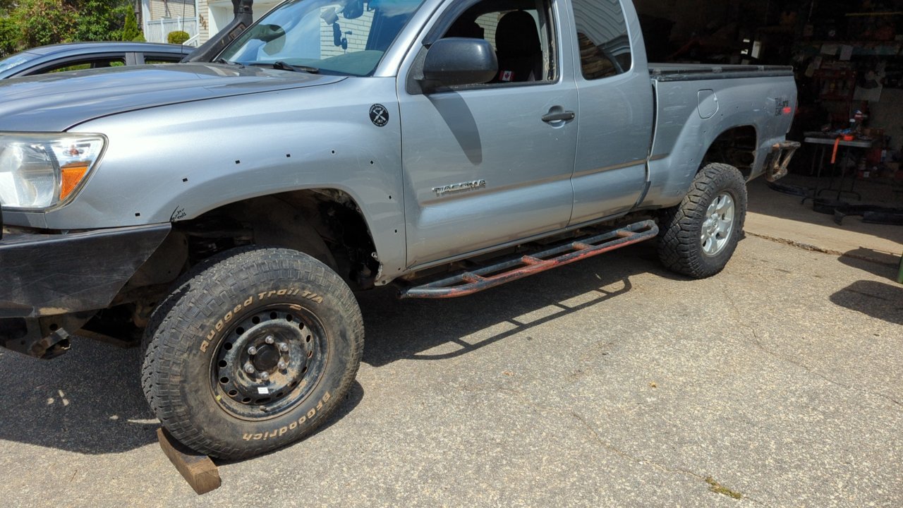

    pic 4 full droop the ims with ome 886 springs set at 8" even from center of eye to bottom of spring seat. did that because i wanted to have the control arm as leval as possiable( sacrificing lift but eh) also wanted the cv to run level. might add some height later on..

    so 333 e mailed me back and said it will work with whiteline bushings
    so look backed at the build thread and found out I used small steel sleeves on both front and back of the control aarms adn just drilled out the front one fro the bigger greasable bolt. somewhere in my garage are the big sleeves that go in there and will accept the 333 big bolt.. oh well at least there greasable now..:)

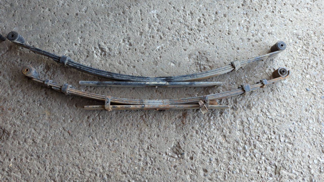

  15. Aug 18, 2022 at 8:37 AM
    #275
    Windigo
    Dec 21, 2019
    #313884
    4,099
    Farook
    '14 Acess Cab
    Today I decided to put back my old leaf springs on. They weren't good enough for the cap and a drawer system and all my junk but now that the bed is empty they should be good enough. I wasn't sure about changing them back but then freebird came on the radio and I knew I was on the right track. Lol :):):)

  16. Aug 18, 2022 at 11:02 AM
    #276
    Windigo
    Dec 21, 2019
    #313884
    4,099
    Farook
    '14 Acess Cab

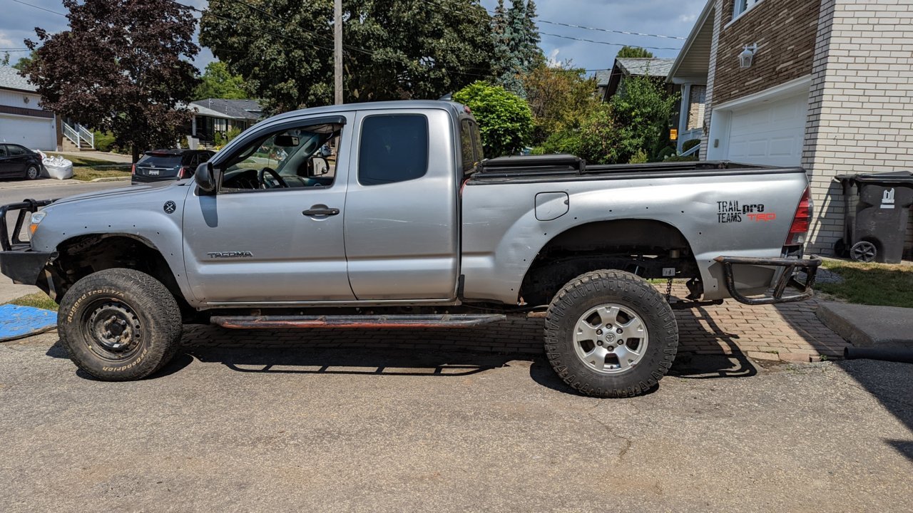

    Stock leafs back on and getting ready to cut fenders

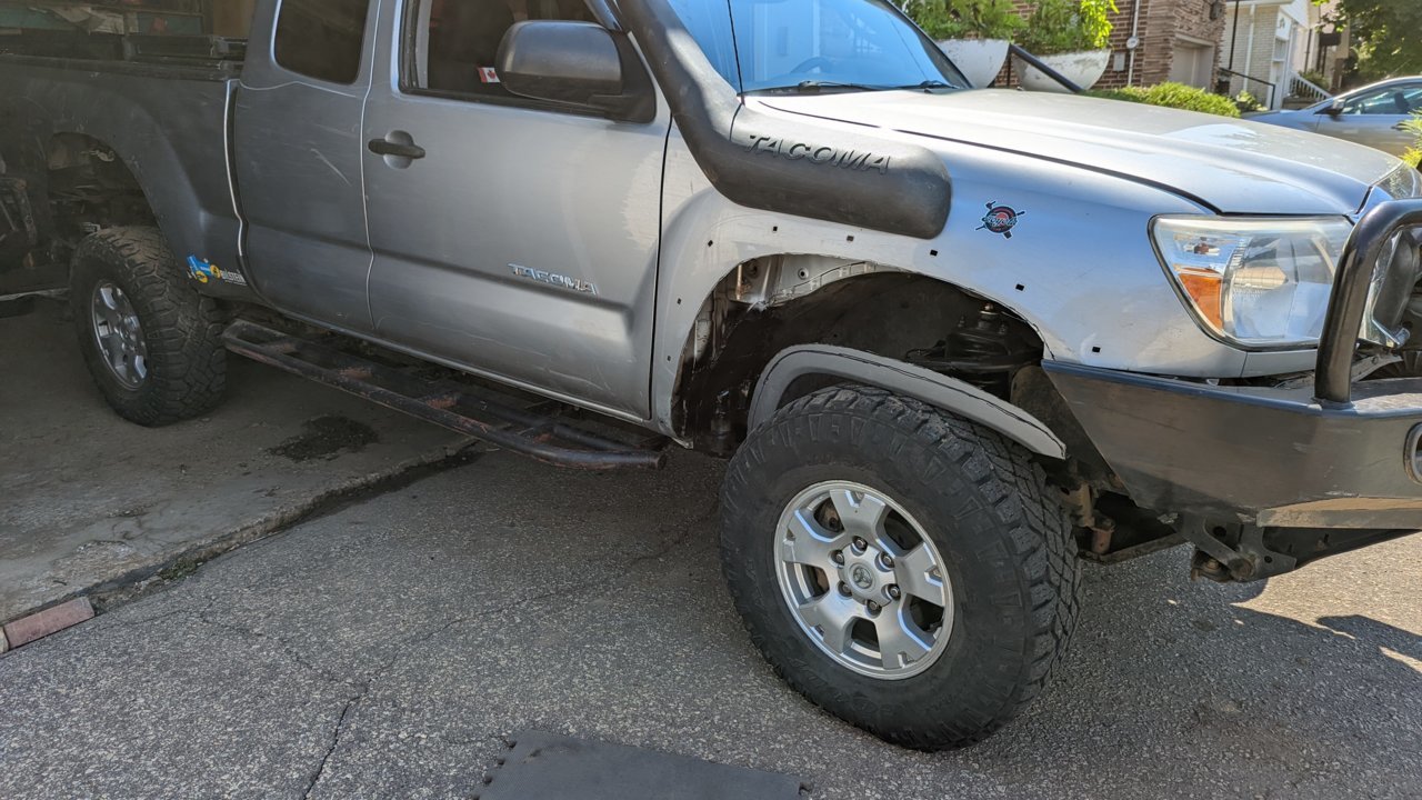

    Tomorrow is the big day.

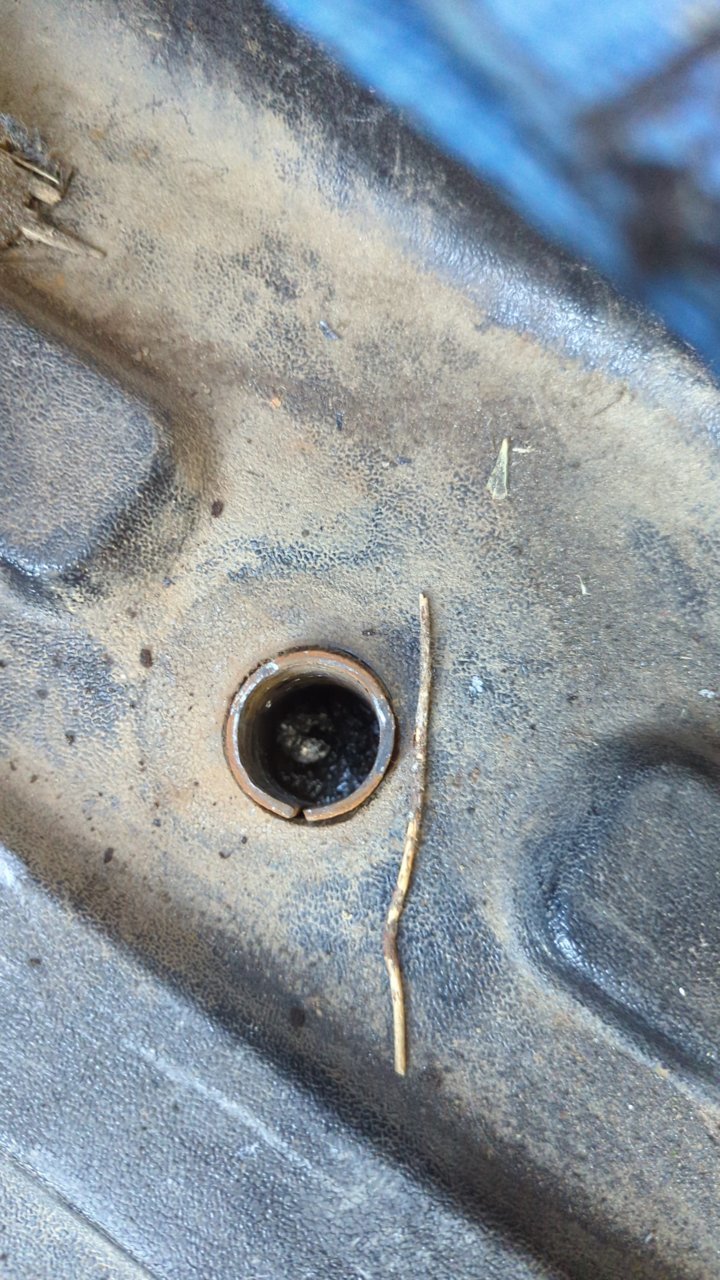

    Seized cutting and hammering to get out of body lift aluminum. Note to self next time use plastic. :);)

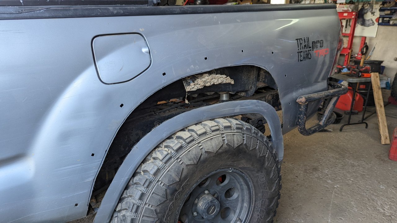

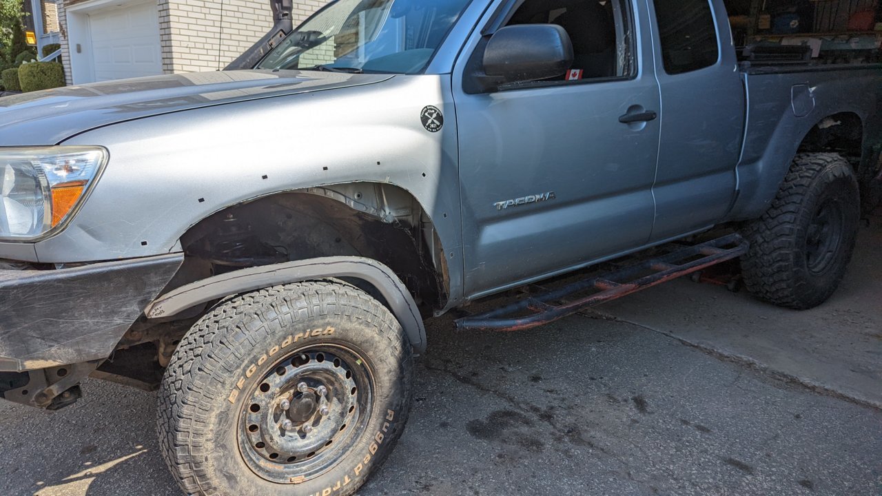

  20. Aug 19, 2022 at 12:51 PM
    #280
    Windigo
    Dec 21, 2019
    #313884
    4,099
    Farook
    '14 Acess Cab

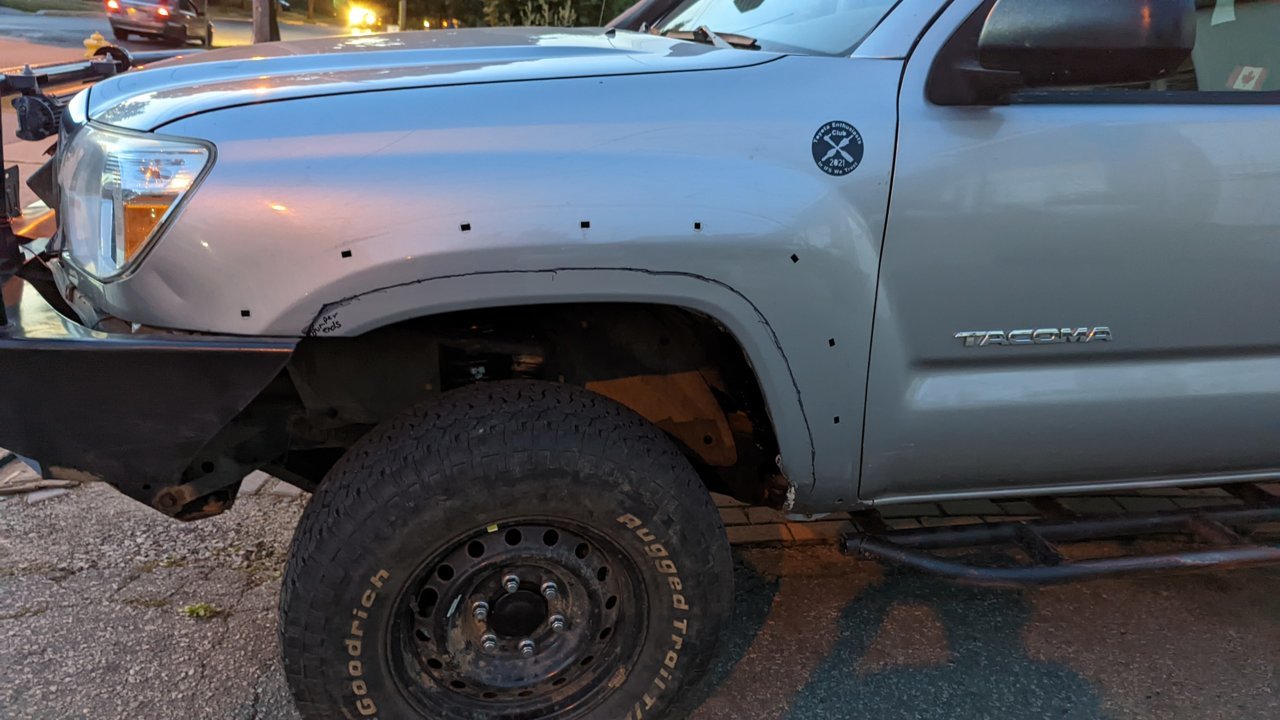

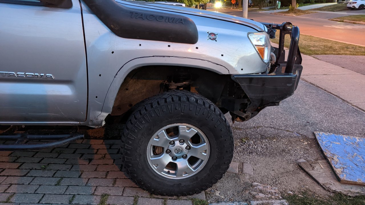

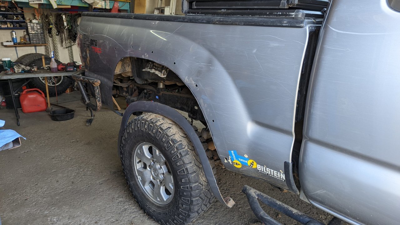

    And the fenders are cut. Oh nooooo. Hahaha
