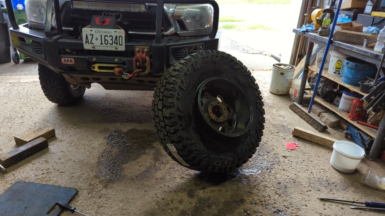

    So I don't have a print out but my alignment came out to be
    Caster 5 degrees positive
    Camber right front - 1/2 degree
    Camber left front +1 degree
    All this was set to
    Tacoma 2012 Access cab MT 6spd long bed
    My truck is a 14 but so many options on alignment machine...
    I'm posting this because I don't want to forget it.

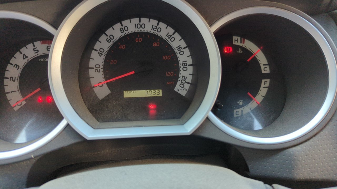

    I just want to remember this day because I'll probably never see it again from totally full to half a tank.

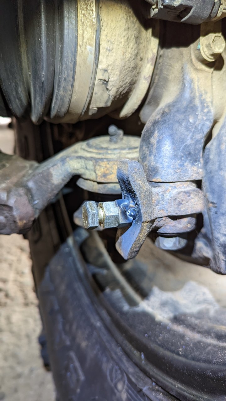

  15. Aug 26, 2022 at 8:46 AM
    #295
    Windigo
    Windigo [OP] Well-Known Member
    Dec 21, 2019
    #313884
    4,100
    Farook
    Toronto Ontario Canada
    '14 Acess Cab

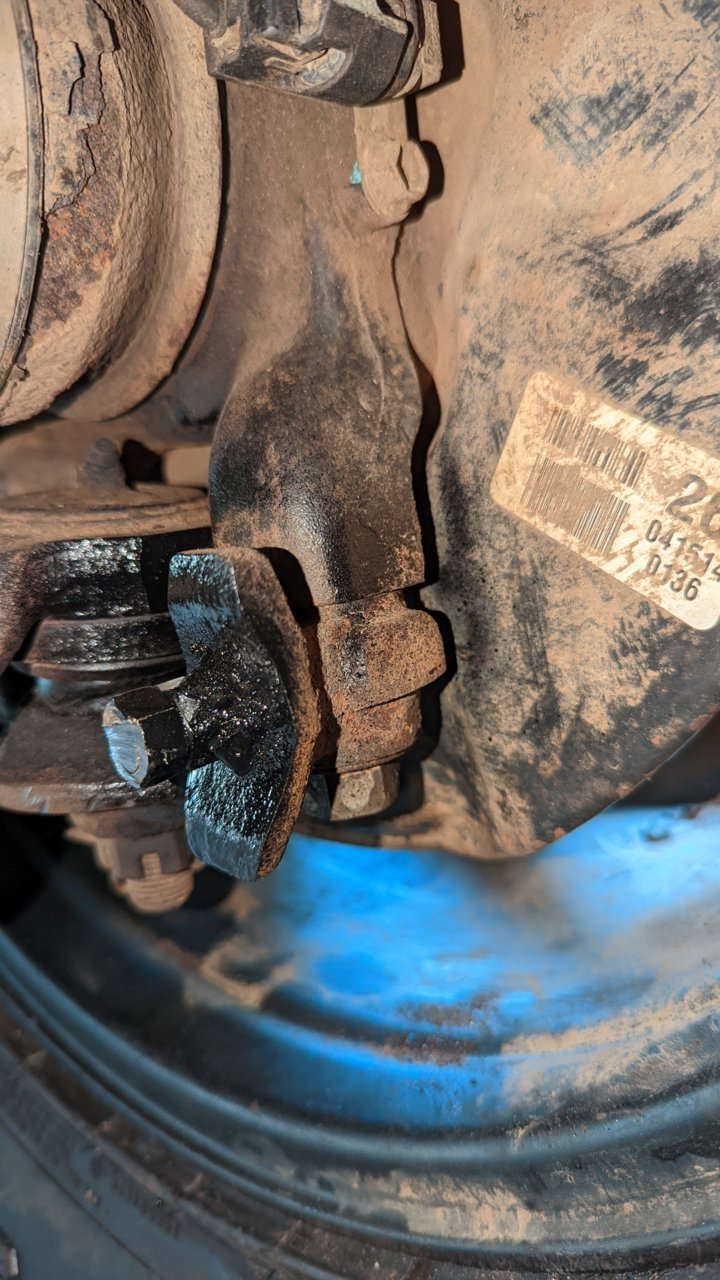

    Steering stops because of my negative 6 had to cut the head of the bolt off to get more steering. A 1 inch steering stop is not enough steering this is roughly 3/4 of an inch and I can just get by with a right and left turn into my driveway.

  16. Aug 26, 2022 at 12:30 PM
    #296
    tacoma16
    tacoma16 Well-Known Member
    Mar 15, 2011
    #53109
    11,112
    Peter
    Ontario
    Double cab SR5 4x4
    Looking good!
    why did you have to do the steering stops? I didn’t understand the”negative 6”.
  17. Aug 26, 2022 at 4:03 PM
    #297
    Windigo
    Dec 21, 2019
    #313884
    4,100
    Farook
    '14 Acess Cab
    My rims have a -6 offset so when I turn it hits the upper control arms. I thought about going to spacers but that means it would push the wheel back a bit and I did not account for that in my tubbing. so steering stops hopfully it will work for me.
    Also steering rack right now fingers crossed it seem just fine not even hard to steer so hope it stays that way..

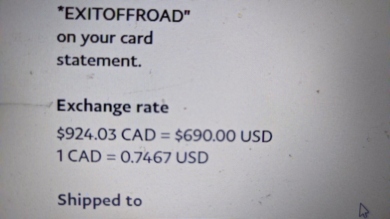

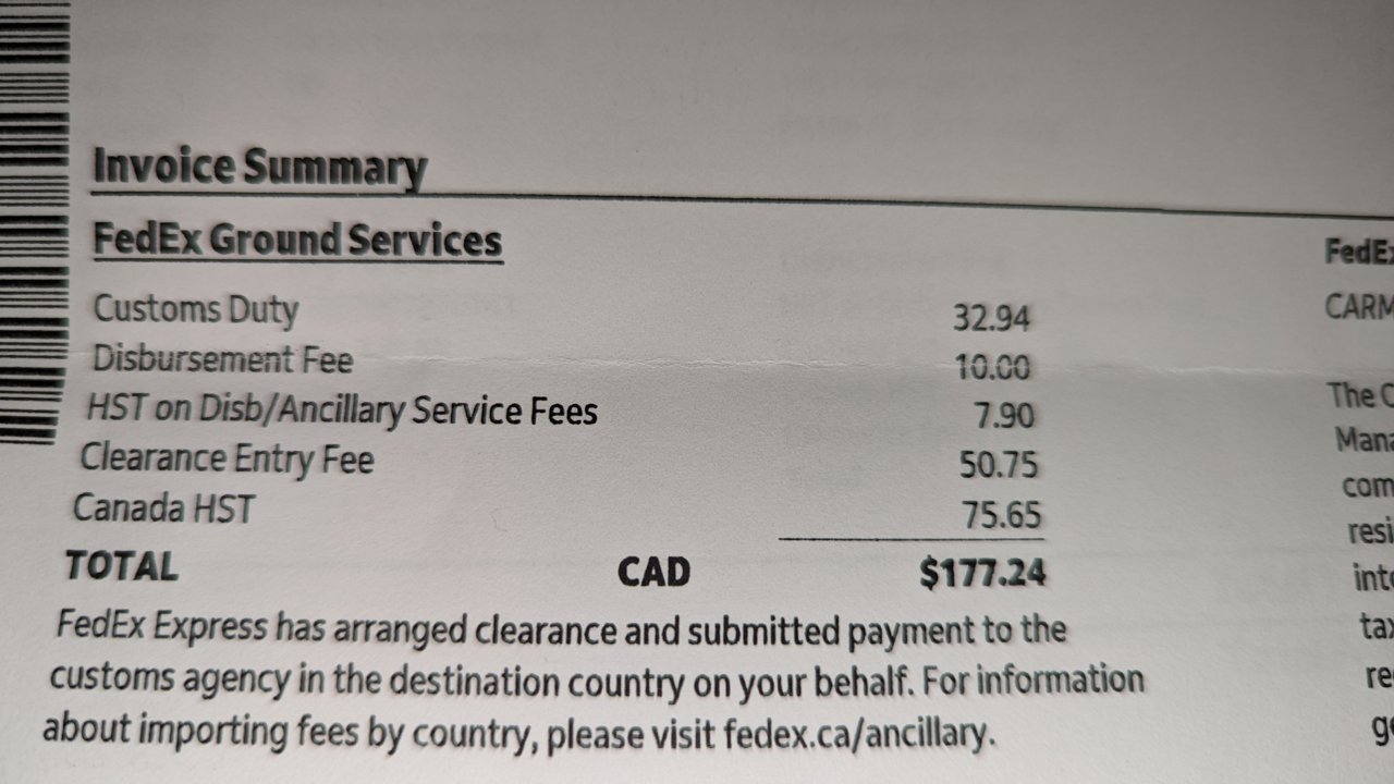

  19. Aug 29, 2022 at 8:56 PM
    #299
    Windigo
    Dec 21, 2019
    #313884
    4,100
    Farook
    '14 Acess Cab
    Not any build but want to remember what I payed for the IMS. Around the 1100 dollars

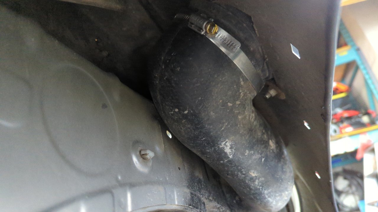

  20. Sep 4, 2022 at 2:39 PM
    #300
    Windigo
    Dec 21, 2019
    #313884
    4,100
    Farook
    '14 Acess Cab

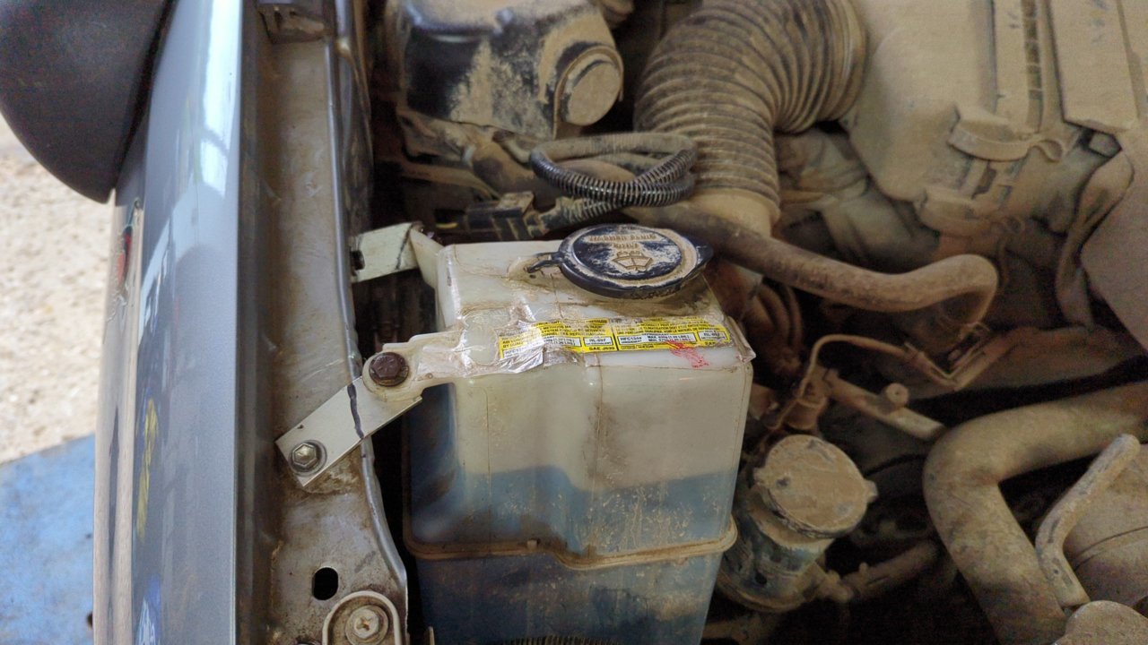

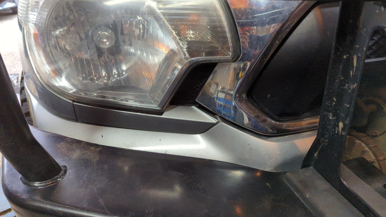

    Little bit of housekeeping today.
    1. Reattached moulding under headlight
    2. Secure windshield washer bottle
    3 hose clamp the snorkle
    ohcaltexscar and tacoma16 like this.
