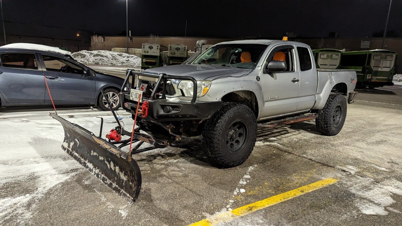

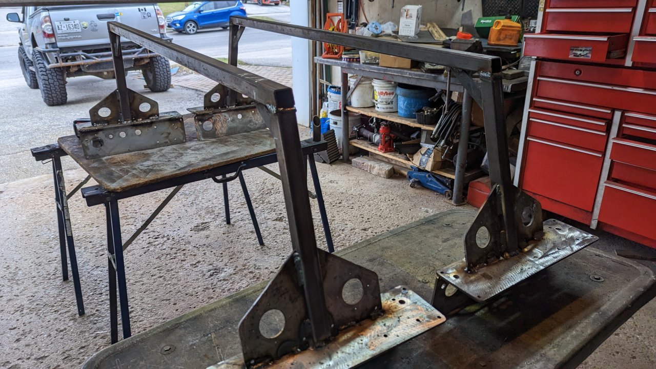

    Taking a break from the overlanding stuff to do some work stuff.

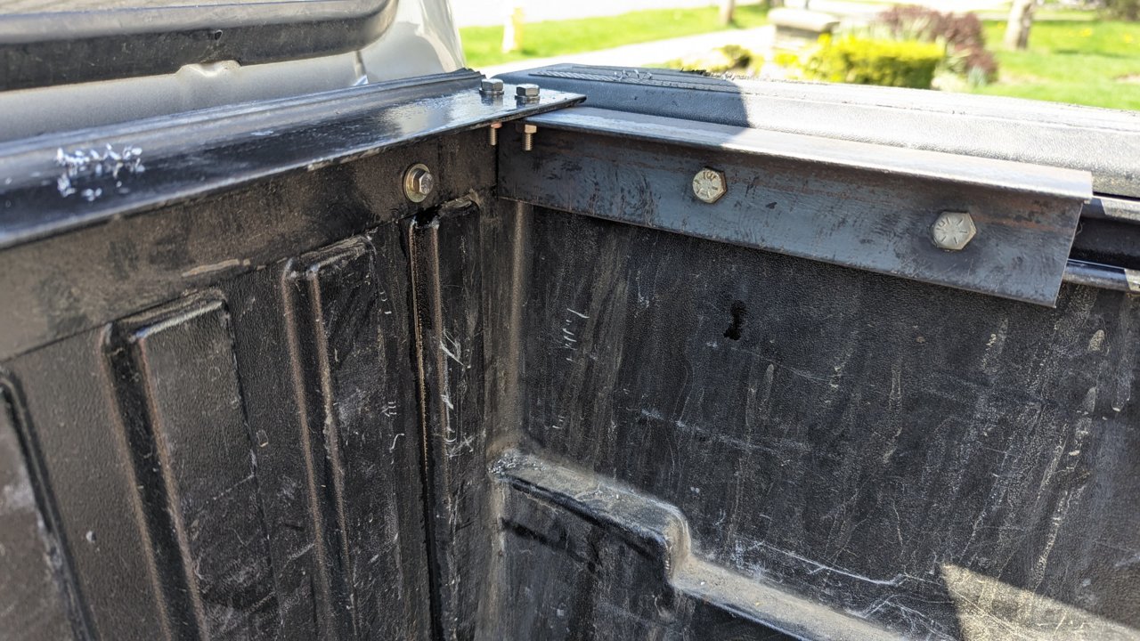

    Made some brackets and got this almost 15 year old snowbear plow on hopefully it will stay on :)

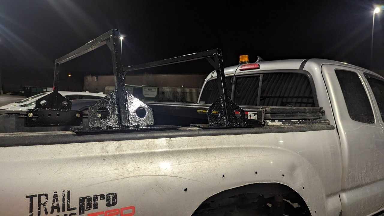

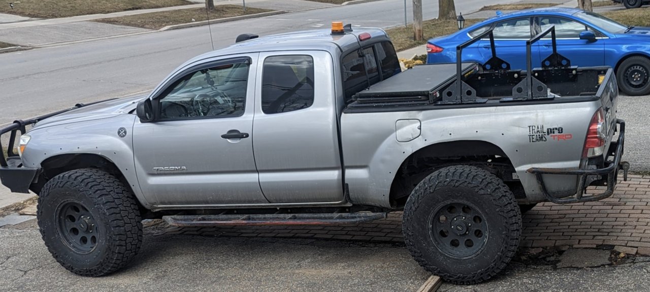

    Decided to go with this RTT set up for 2023. Why it looks so tall in the pic I'll never know... its still my daily driver and work truck so the bed still has to be functional for daily use hence the height..

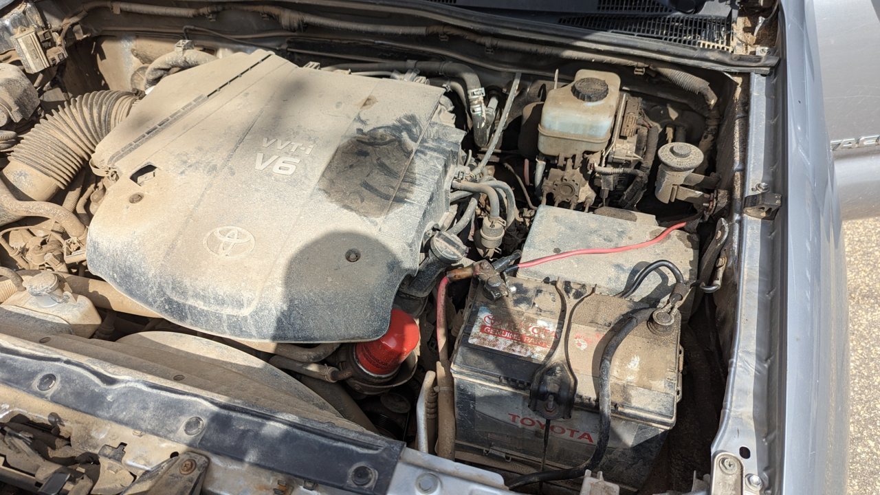

    Any chance you have a pic of the entire bay after the tubbing? Wonder if it looks really crammed in the bay now.
    Great work btw. Looks pretty self explanatory on how much one would need to cut. I guess organizing and finding new places for everything in the bay would be the last easy part.

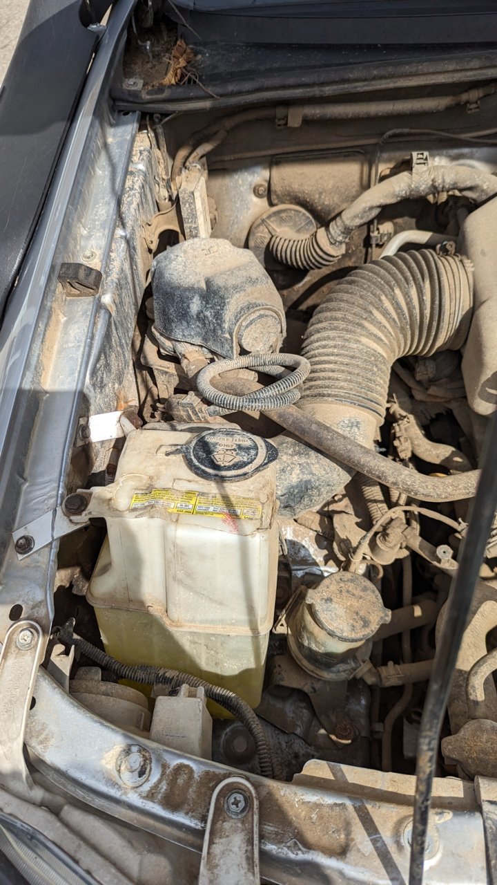

    My engine bay I little affected.
    Thanks to 2" body lift. I'll take a pic for you.

    Looks stock. Just dirty. :thumbsup:

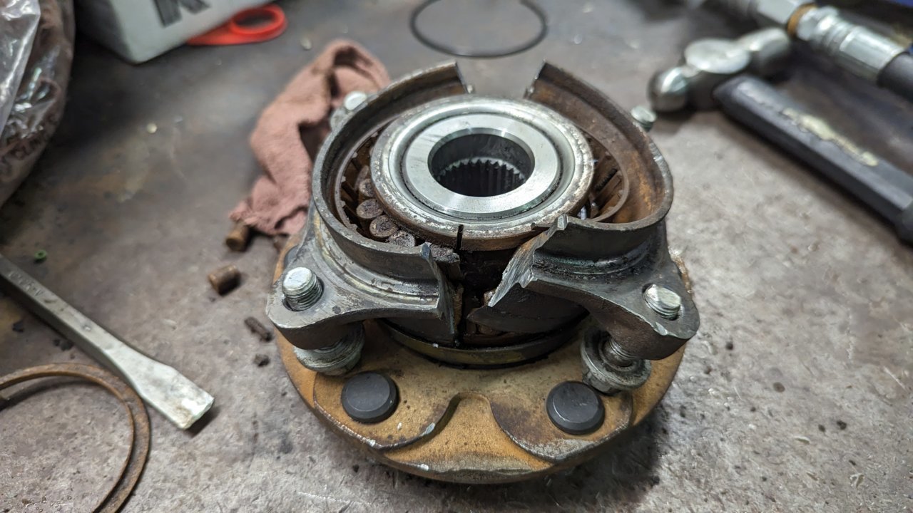

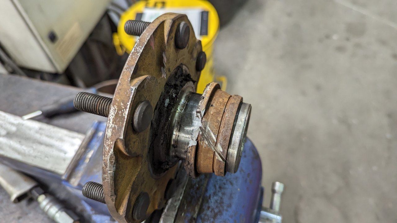

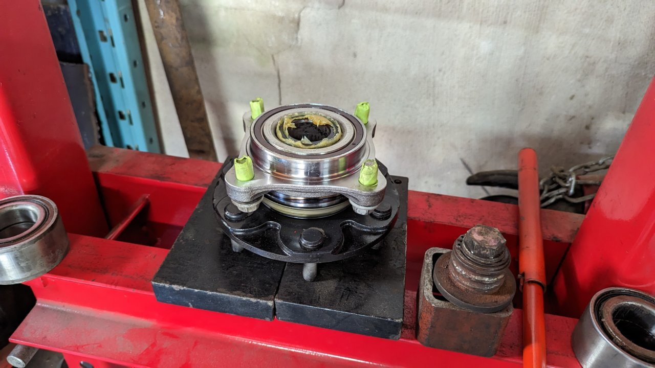

    Decided to take apart my old bearing and just buy the bearing portion and put it together for next time.

    I was waiting for this to come b4 getting a bearing and pressing it all together.

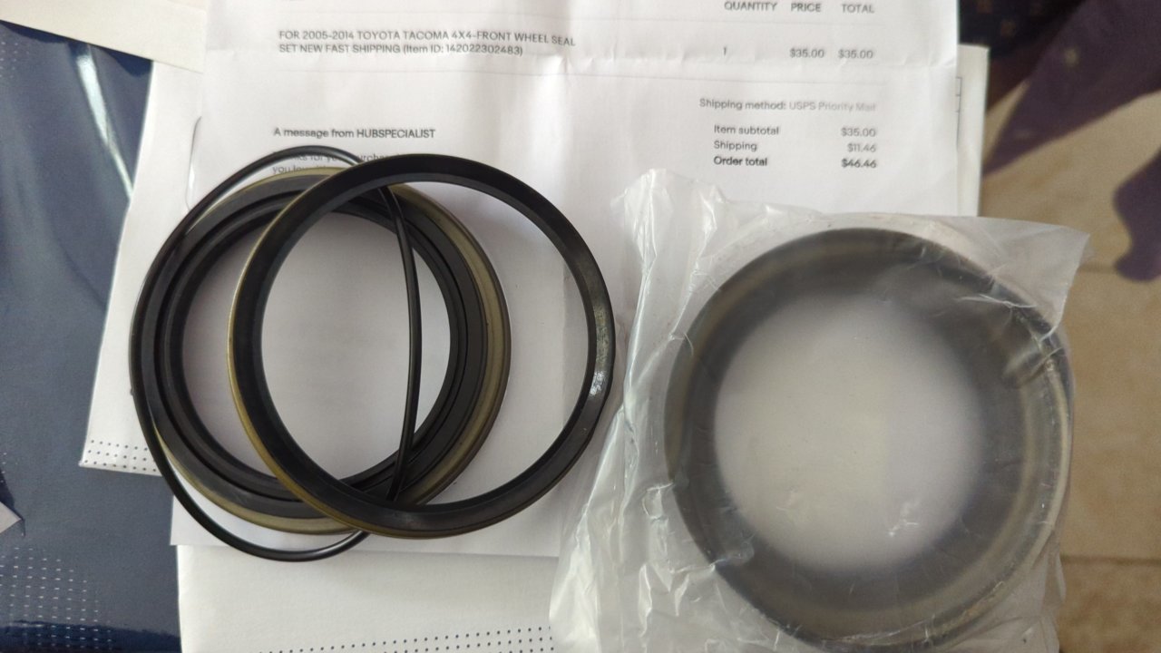

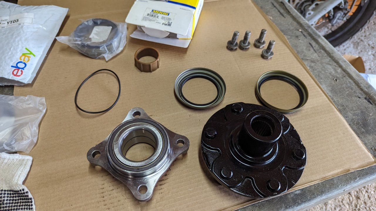

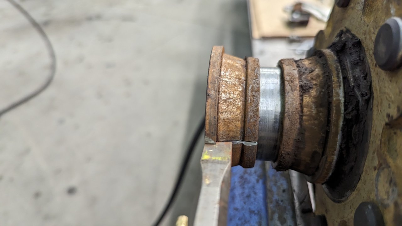

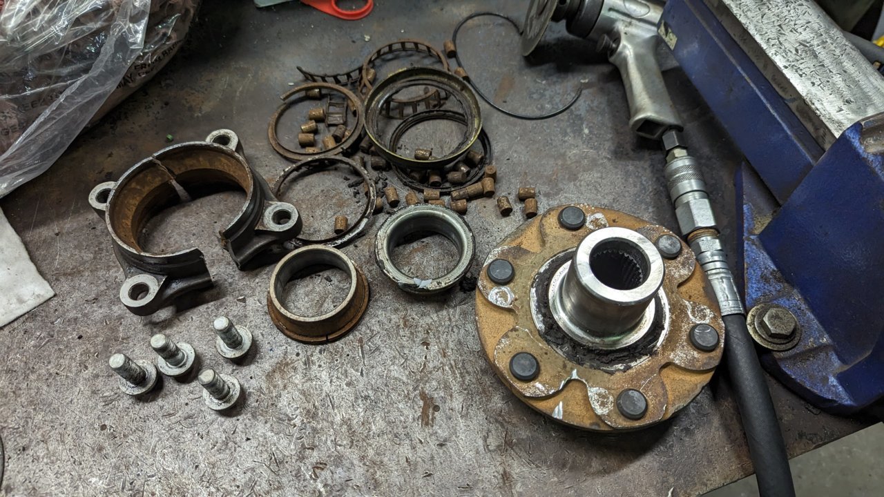

    Finally got around to this.

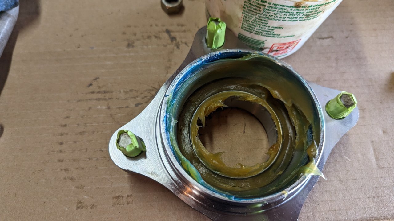

    so there is hardly any grease in the bearings and what was in there, absolutly no way was it going to cover all the rollers so added some.
    the seals I got from e bay were wrong but I improvised should be ok.

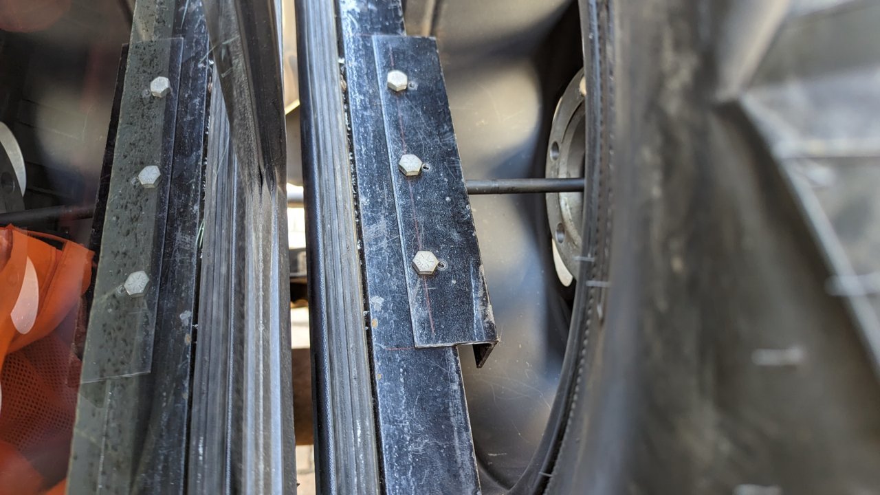

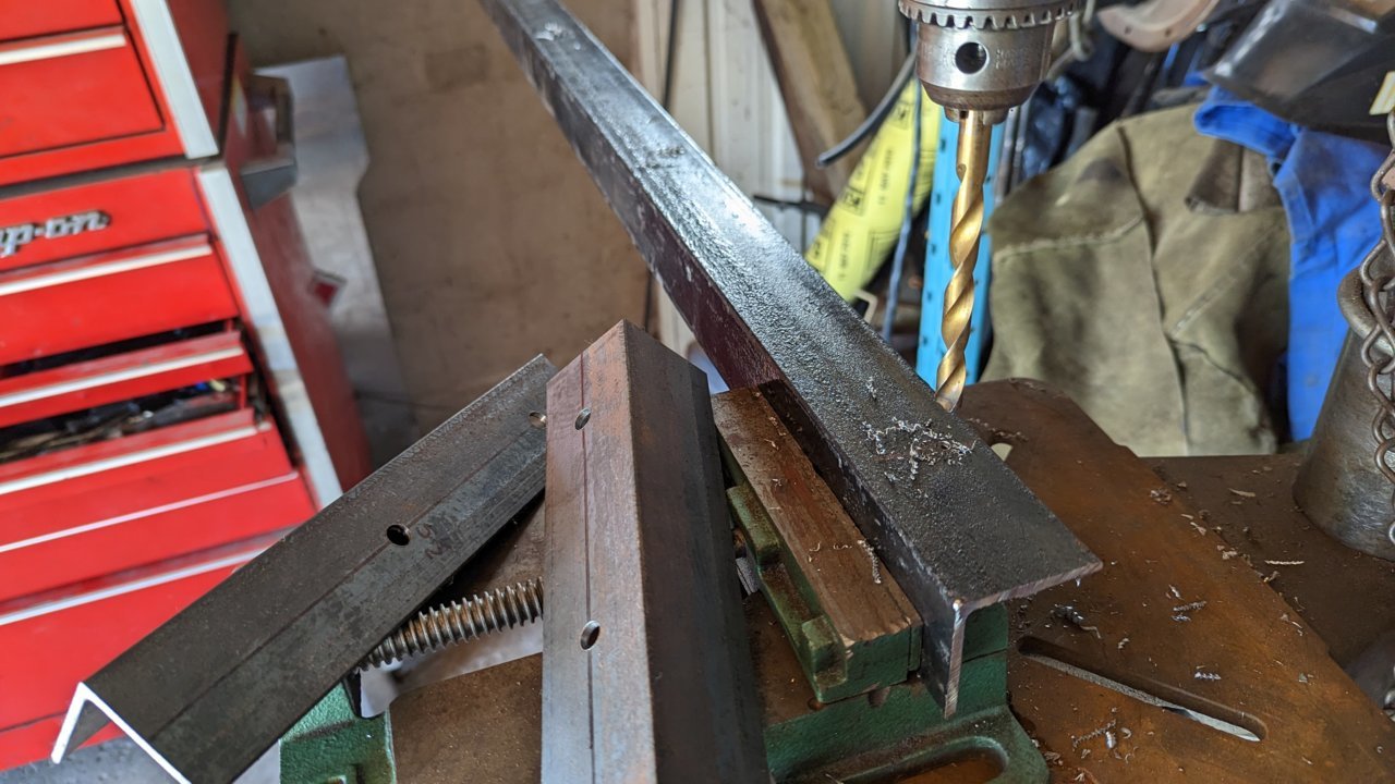

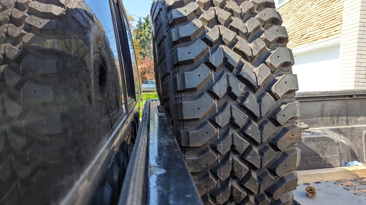

    Trying another spare mounting.

    ^The edge of the angle iron will dig into the tire sidewall over time. Fab up something to distribute the pressure.

    Yep your absolutely right about that. I'll have to think of something. Thanks.
