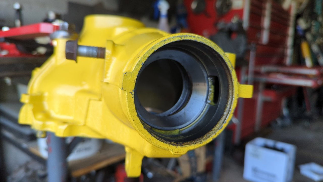

    I got this bearing race install kit today from princess auto and side bearings the outer pinion bearing race it'll work but for the inside pinion bearing race nothing fits so I guess I got to make up an installer or just hit it with some punches

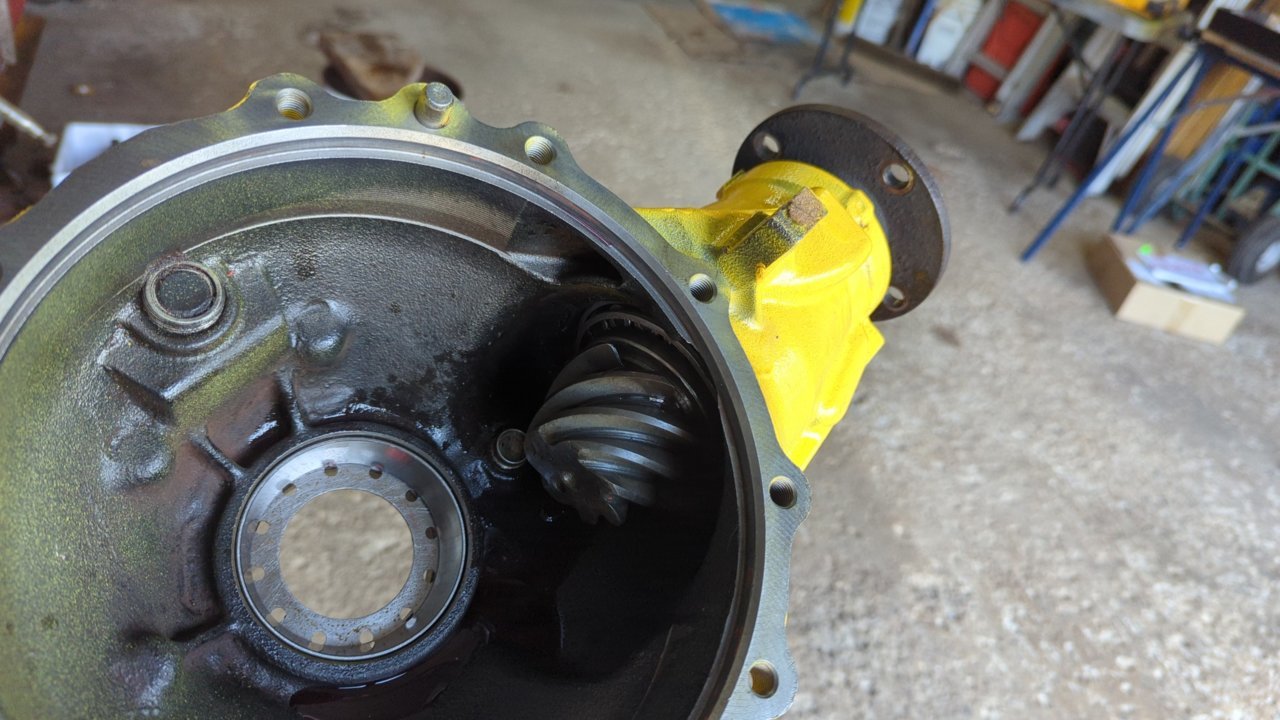

    The parts for the front

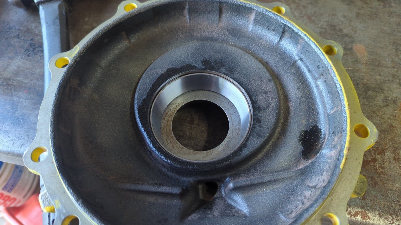

    So there's 15 thou to overcome when installing the inner pinion bearing race.
    that should say pinion inner bearing race dia.

    Farook

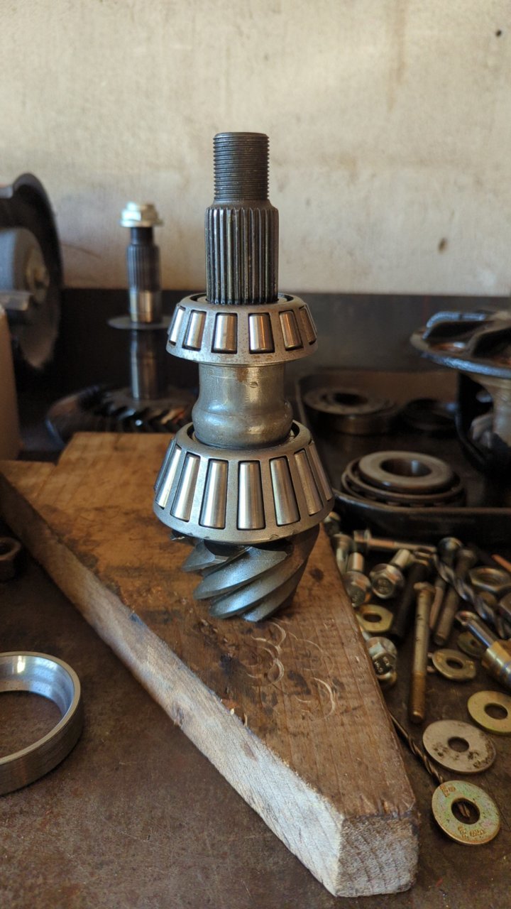

    I've put the inner pinion bearing race in my freezer and in a day or so we'll see how much shrinkage a home freezer can shrink a bearing race. And I just took some measurements today to see where my beginning point with all this stuff is
    Also de-bird the pinion shim and flattened out the side bearing shims
    Also hogged out the old pinion bearings a bit to where it's a snug fit on the pinion.

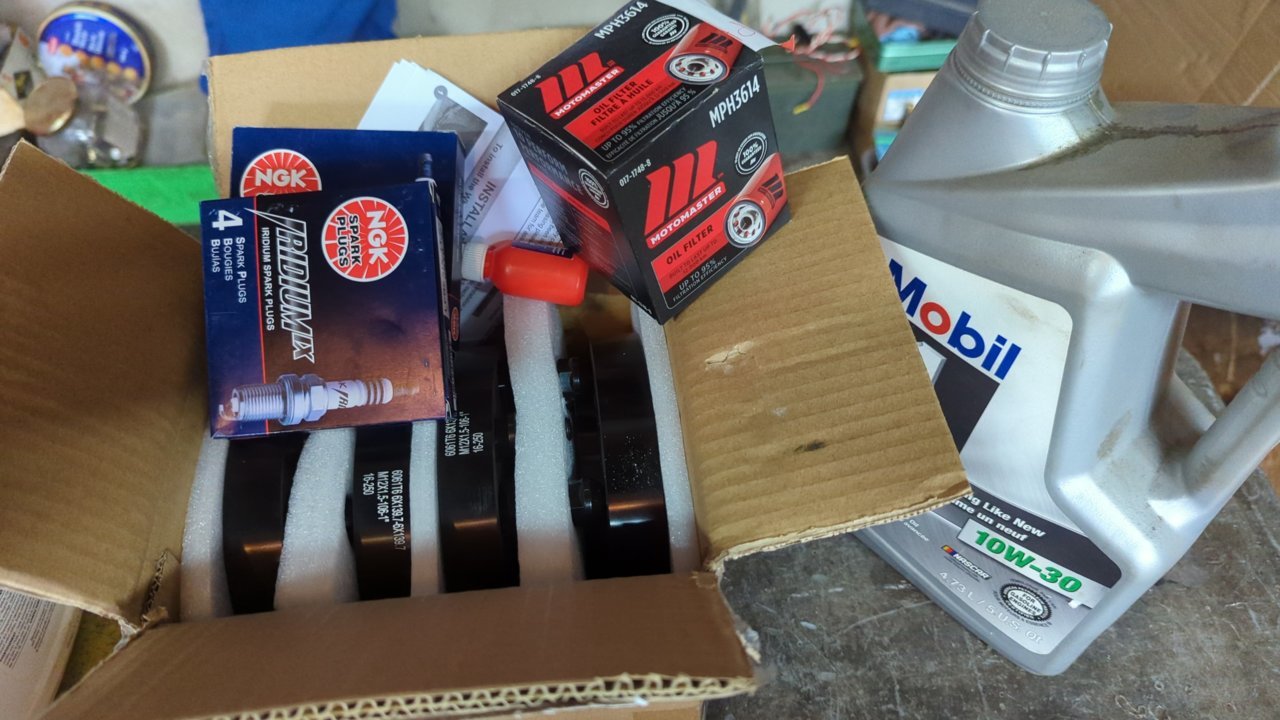

    Some much needed maintance parts came today.

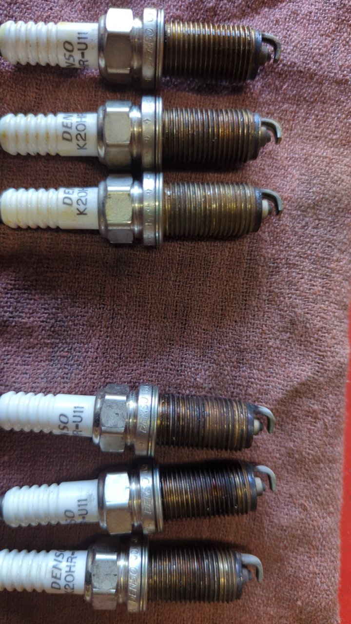

    90,000 km on these plugs not to bad.

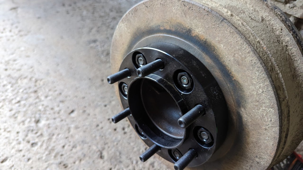

    Had to put some spacers on,the inside part of tire was starting to rub a little too much.

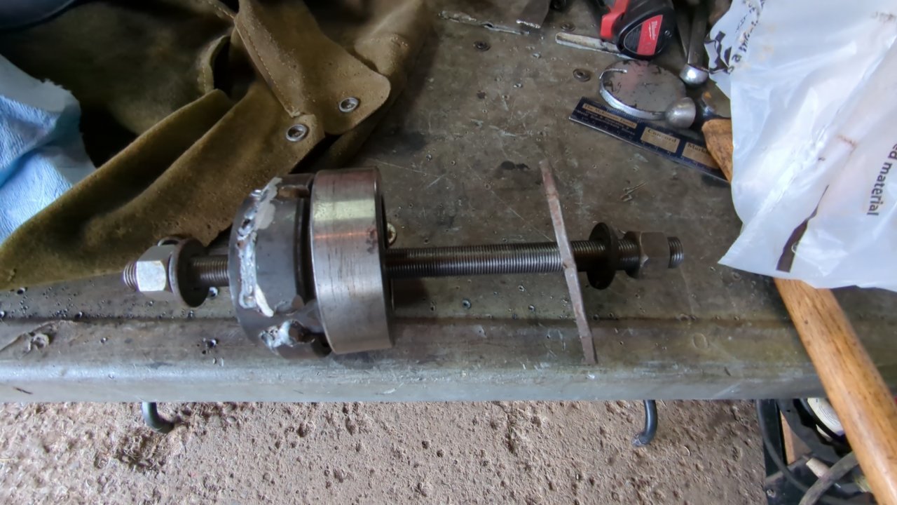

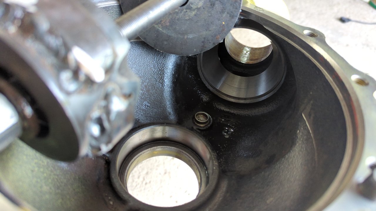

    So back to this today made this inner bearing race installer for the front clamshell.
  14. Jun 17, 2023 at 9:12 AM
    #354
    Windigo
    Windigo [OP] Well-Known Member
    Dec 21, 2019
    #313884
    4,223
    Farook
    Toronto Ontario Canada
    '14 Acess Cab
    And it actually worked. Hmmmm. :)

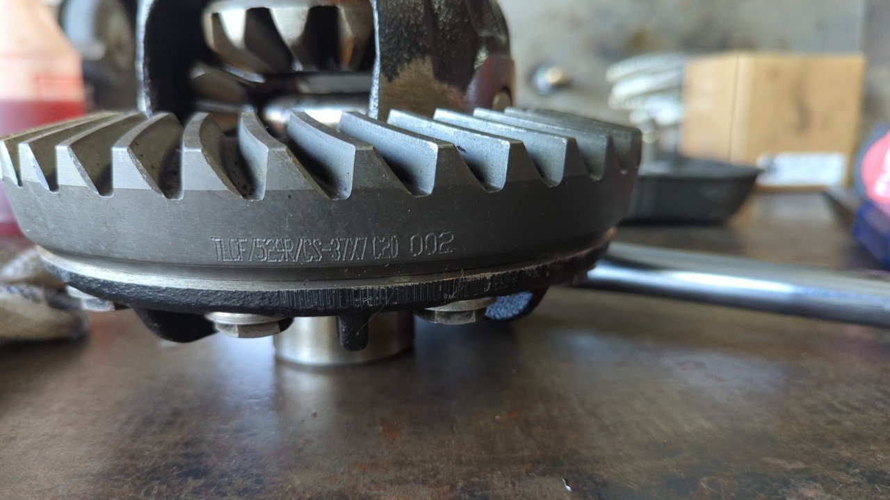

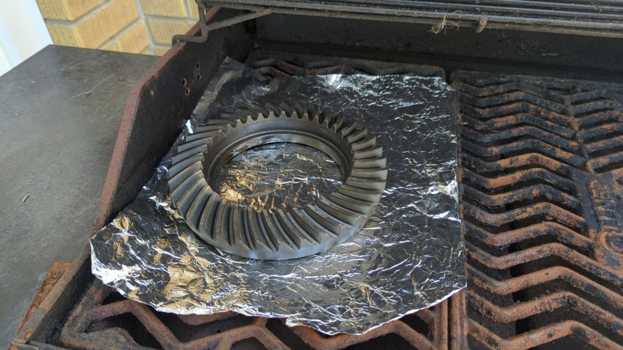

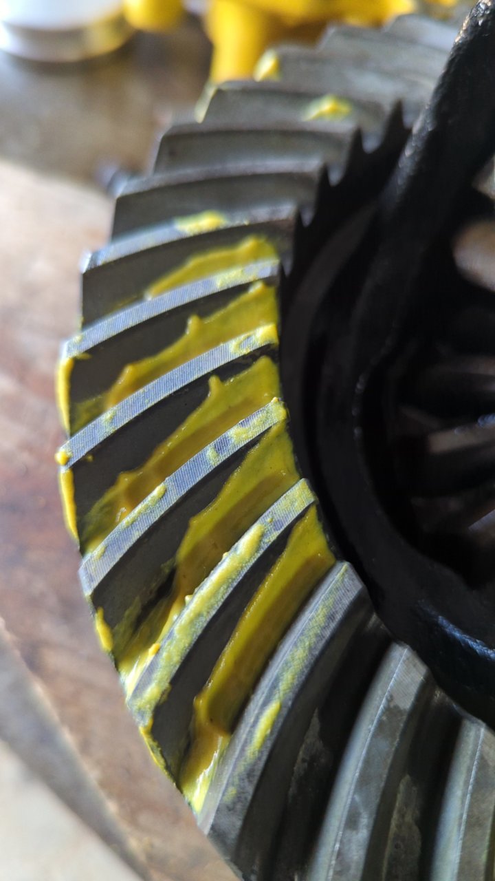

    So all the races are in.
    Ring gear bbq'd
    Ring gear bolts torqued to 70 ft/lbs

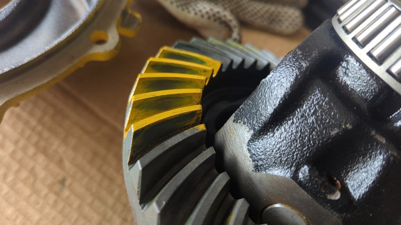

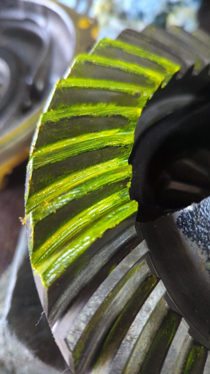

    Well hear goes..
    Nothing.

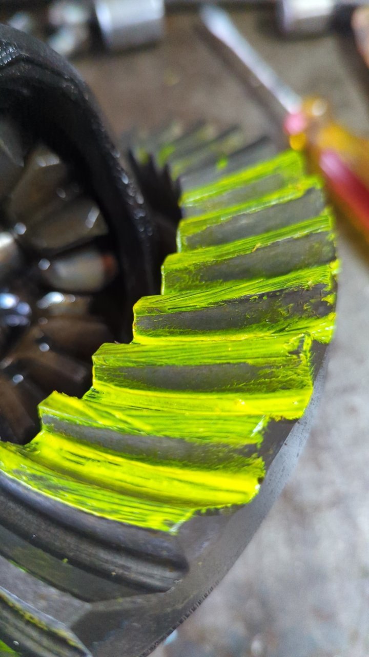

  17. Jul 11, 2023 at 12:21 PM

    Looking good Farook!

    Don't think it's going but can't figure out why.

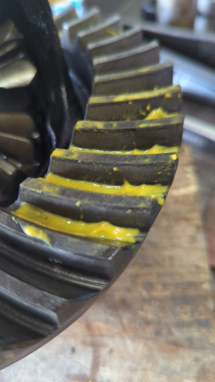

    Another try at it.
