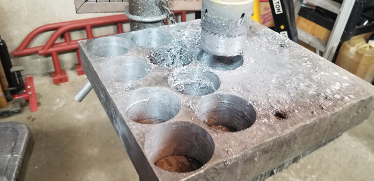

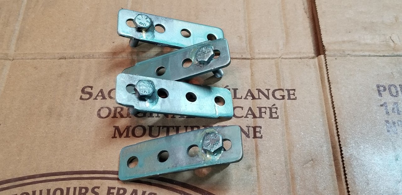

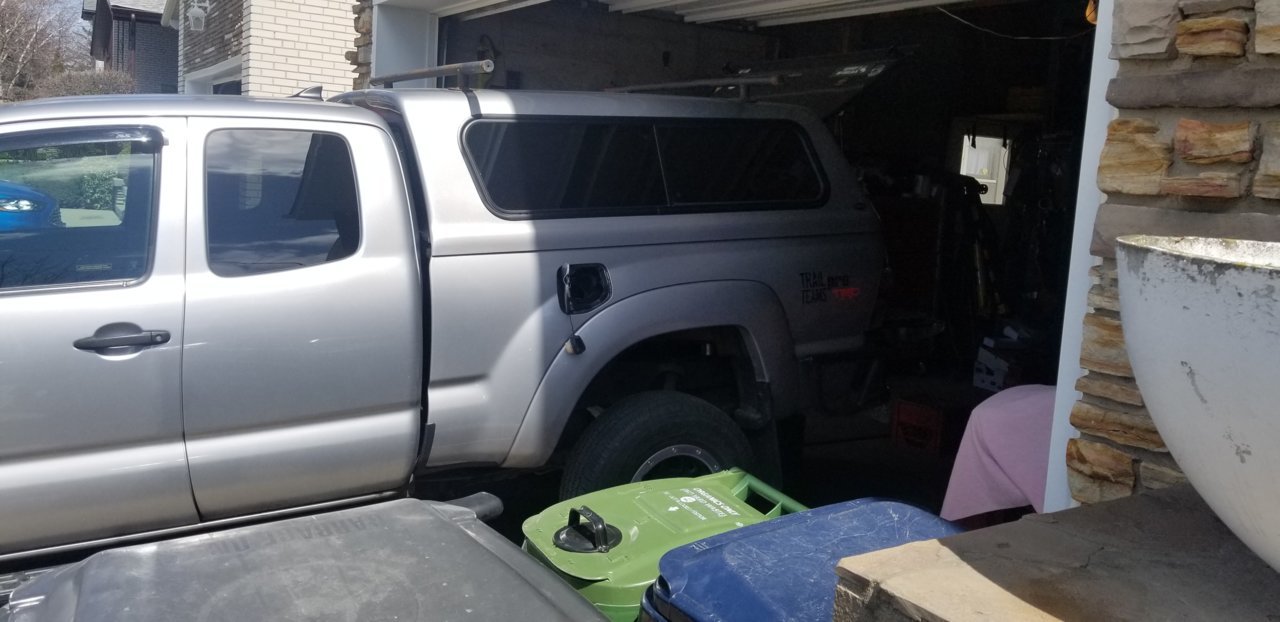

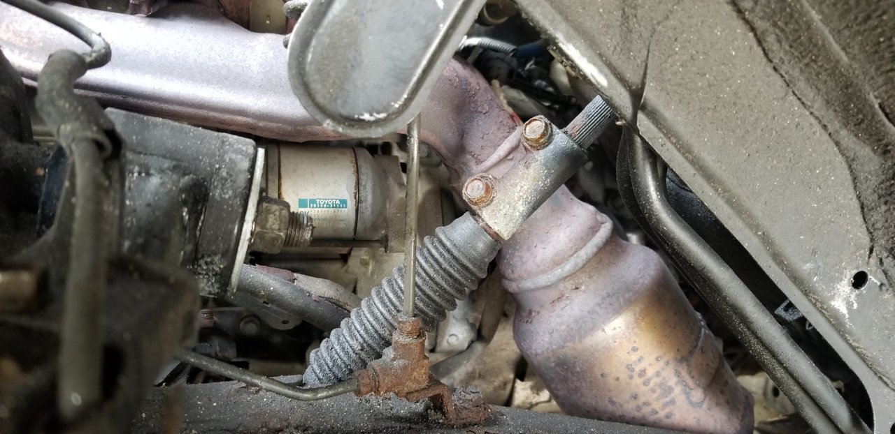

    Hear are some pictures of my homemade 2" body lift.
    Its simple.
    drop the rad by 2"
    extend fuel filler
    extend steering shaft
    and extend p/s hose
    use longer bolts and make spacer blocks out of aluminum
    hear are some pics

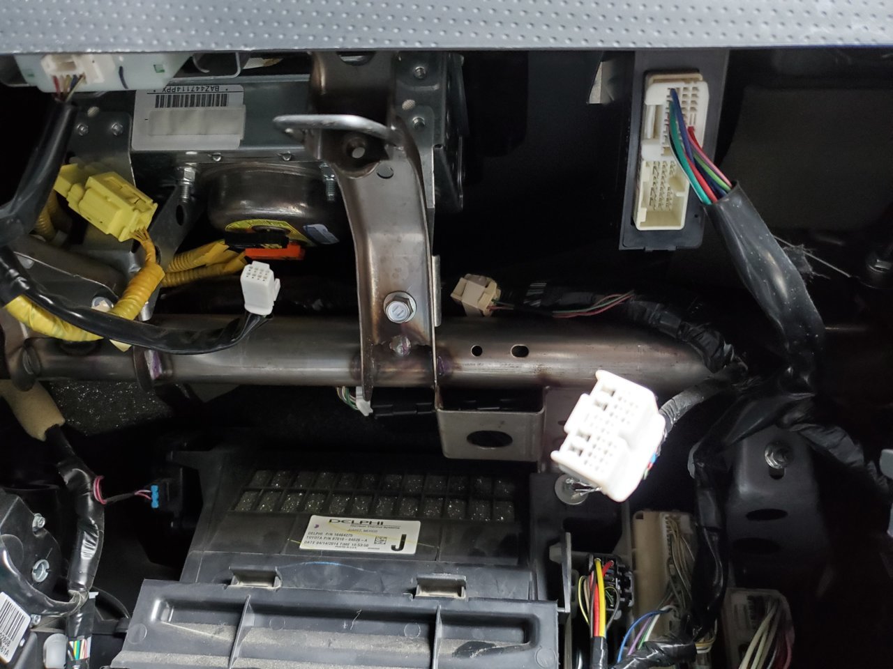

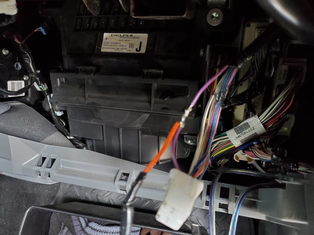

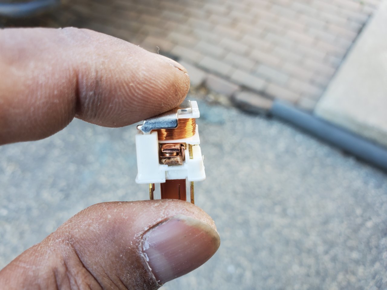

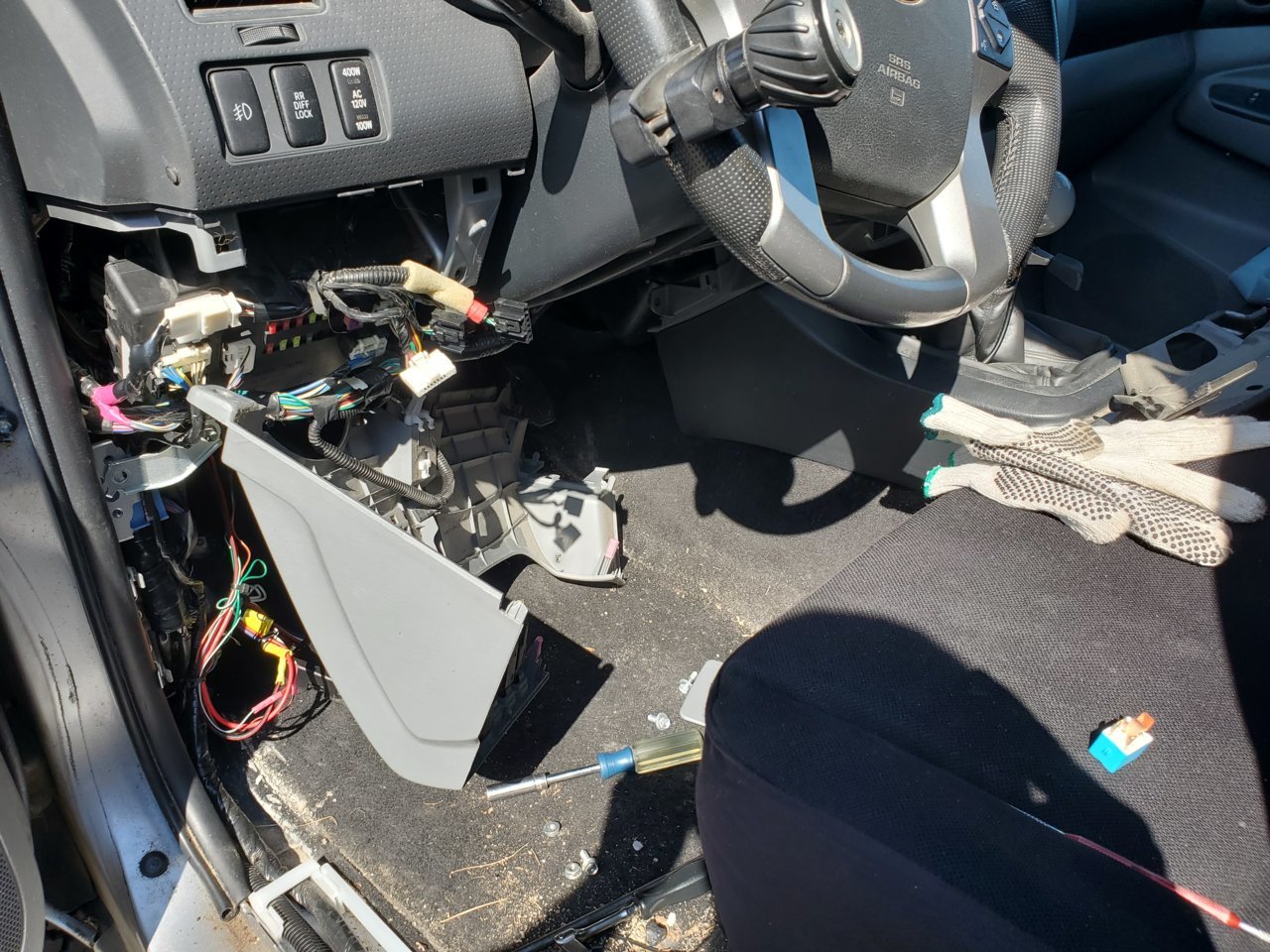

    So I got this fridge for this wheeling season to try it out.

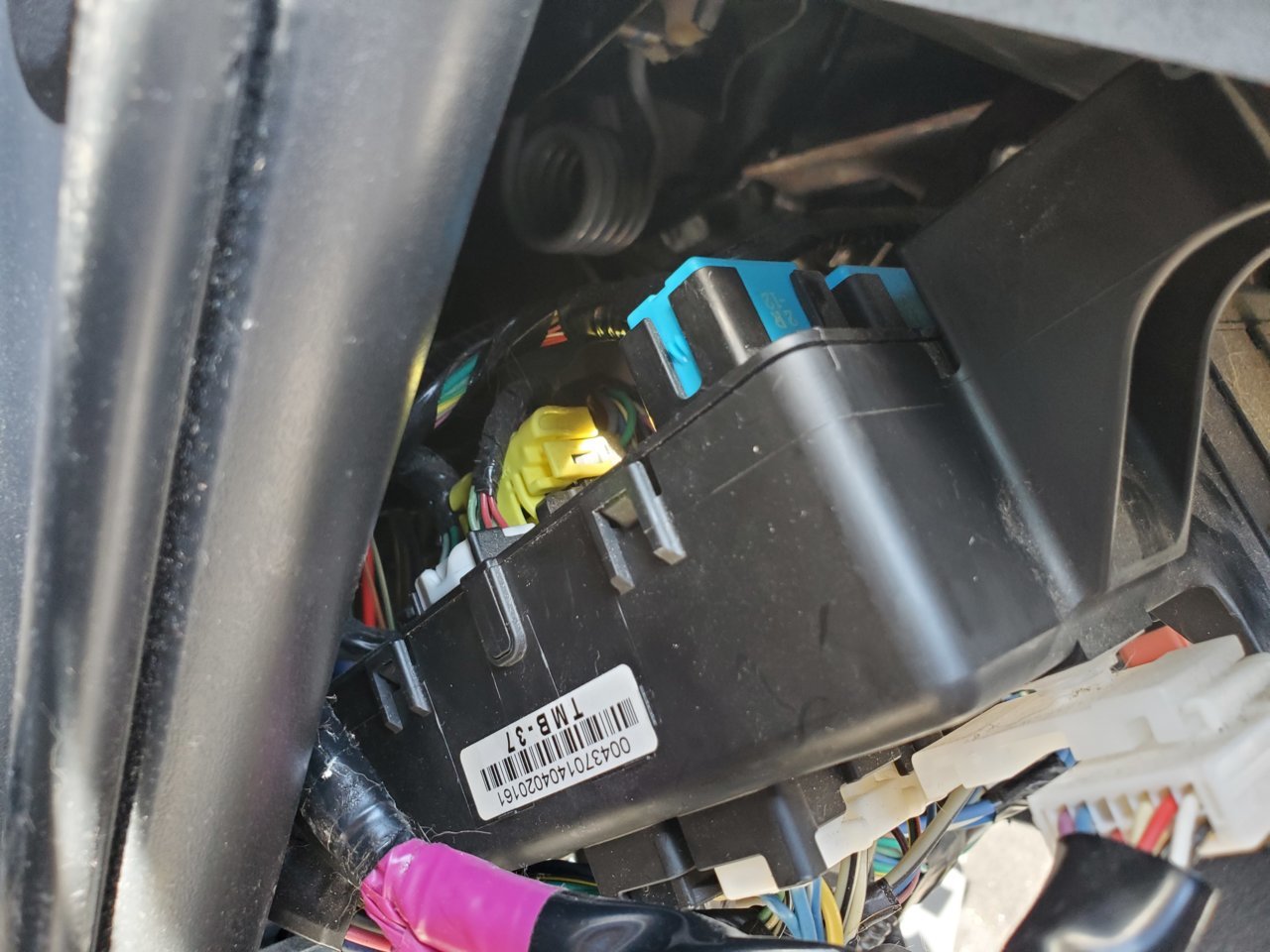

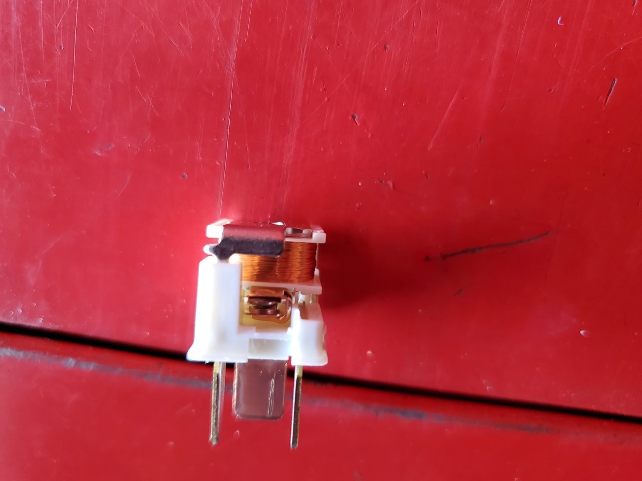

    and to my surprise I forgot that the 12v outlet only comes on with the key. So on to finding out how to make it stay on and watched this video
    https://www.youtube.com/watch?v=4RdzaaTYfQY
    so from the time I found the video and looked at it, went outside and pulled everything apart and did the mod it was less than 1hr. But lets call it 1 hour.
    removing this panel is in the video
    the important part is the relay
    just took a piece of wood and wedged the contacts closed replaced the cap and all done

    Very nice,
    Now just be careful with what you plug into the 12v plugs. As they are always live. I almost burnt my truck down with this mod.
    12v USB power plugs that you charge your phone off of, are not meant to be left on 24/7. Be sure to remove them if you are not using them.
    Ruined a battery, and almost my truck.

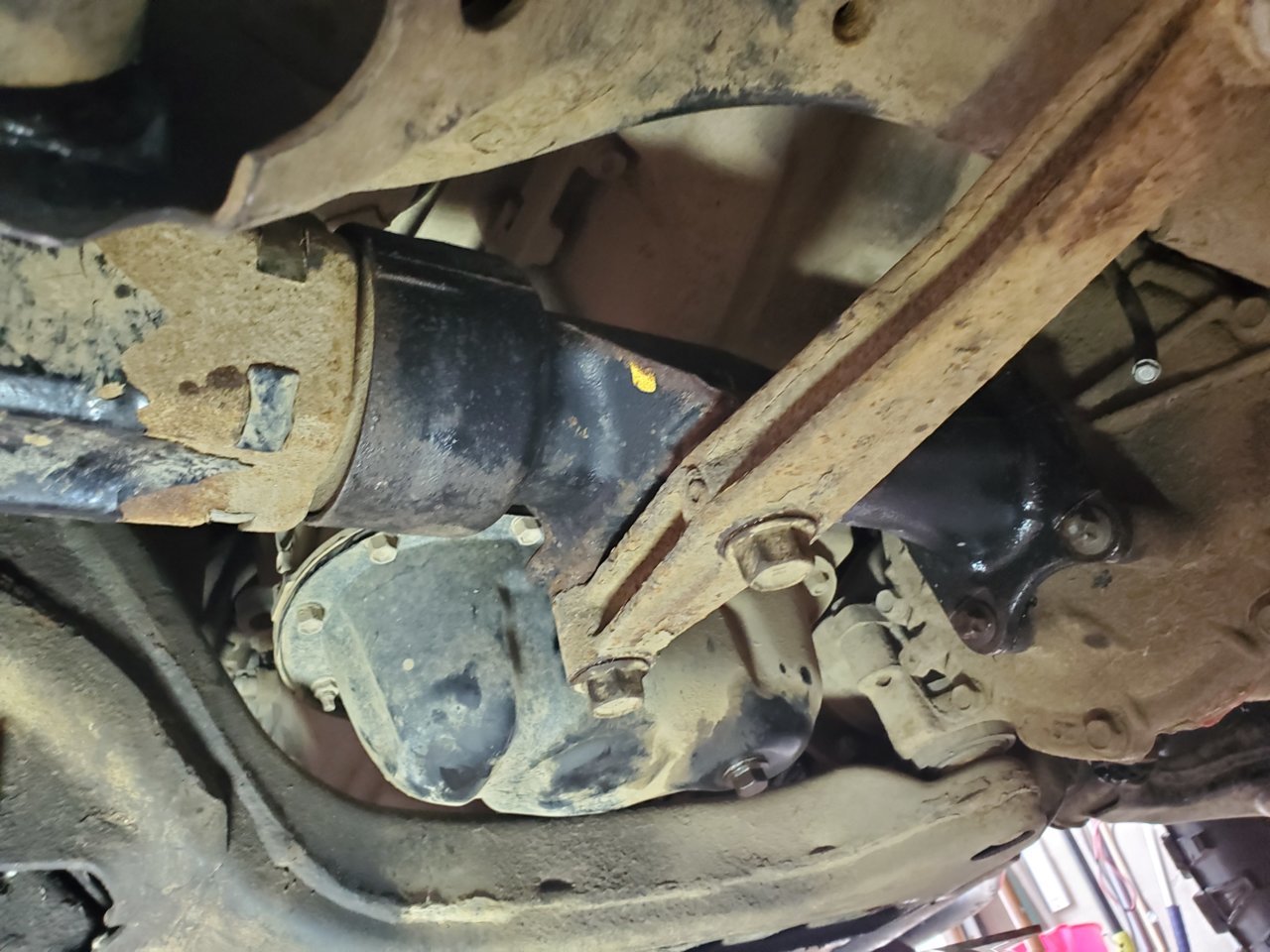

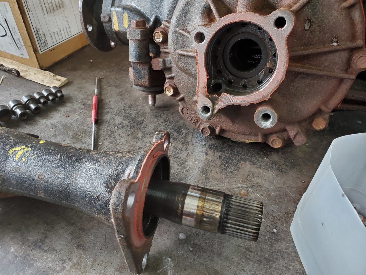

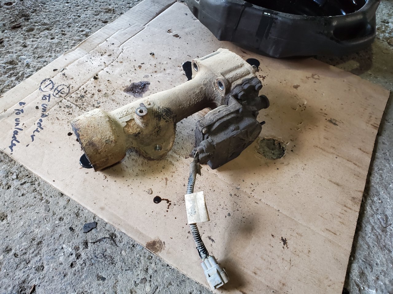

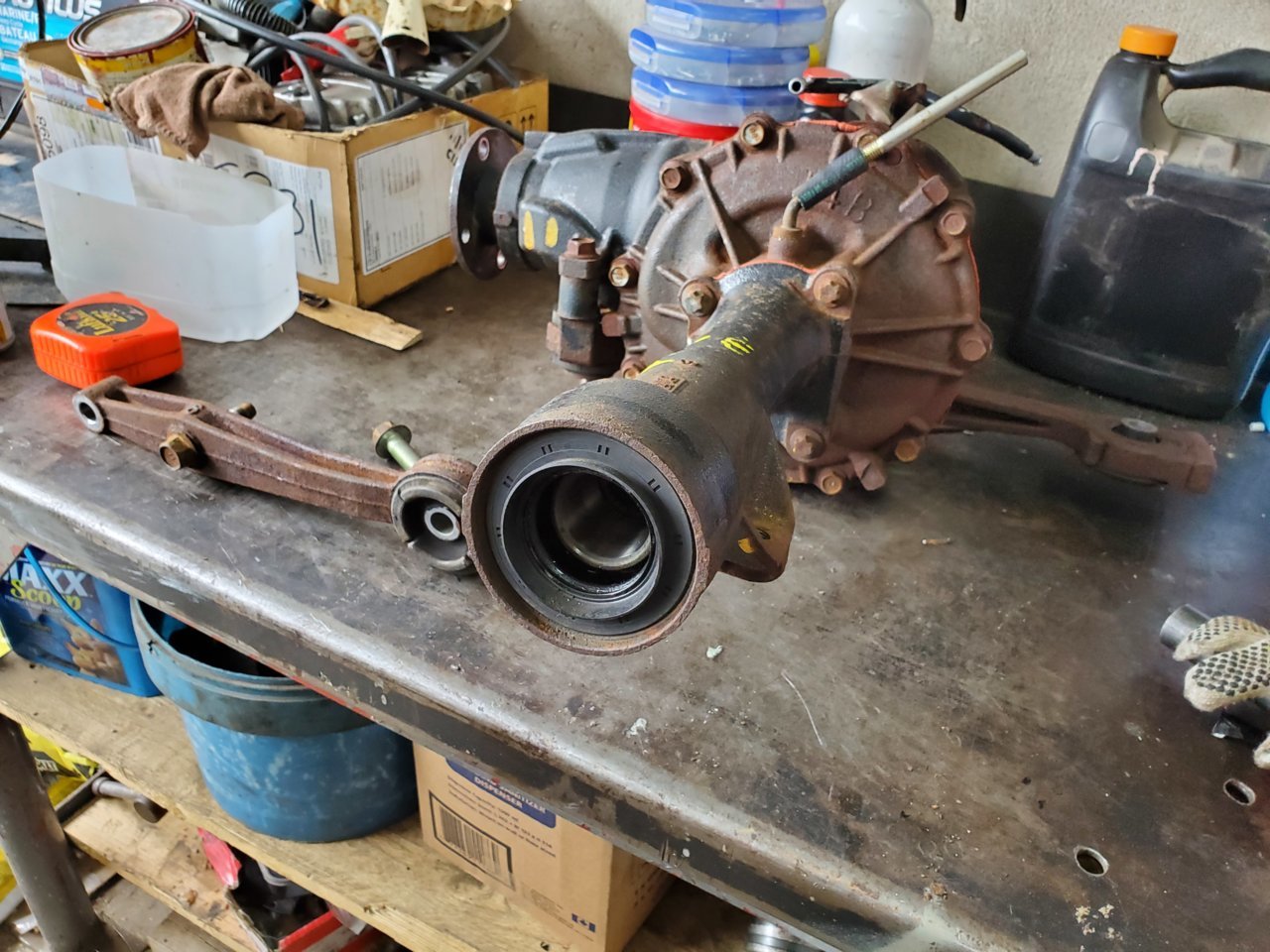

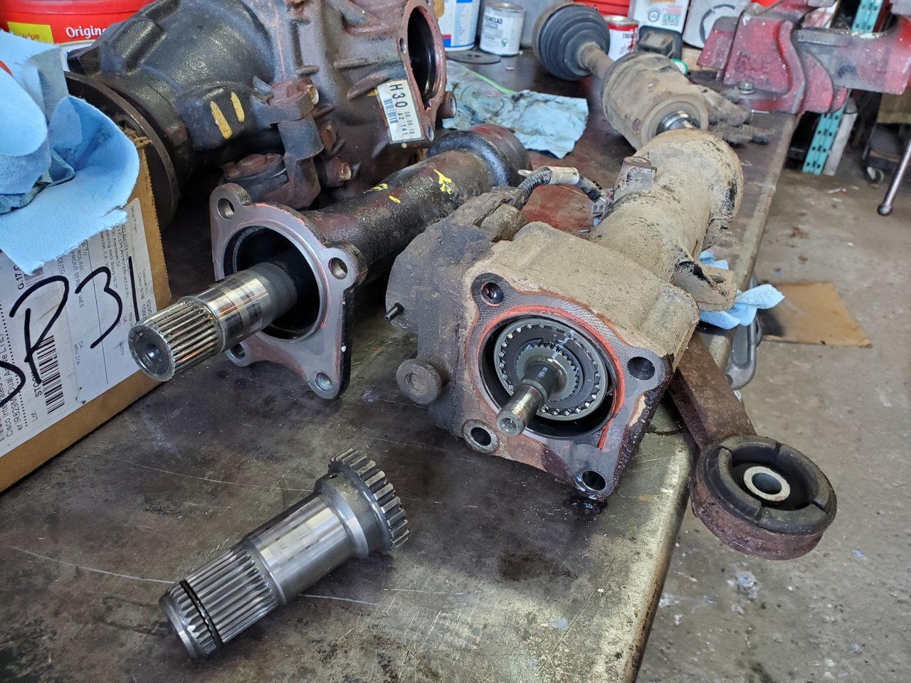

    well got to work on part 2 or this mod. part 1 was the locker anytime. part 2 is the removing of the ADD, I just replaced the axle tube.
    we not all that hard to do...
    this is the doner tube
    hear is the original ADD and tube out
    just checking them side by side to make sure
    then installing the fj tube
    All in all this job was pretty easy the hardest part was doing it twice because i did not use silicone sealant, the first time... yes rookie mistake ... lol.
    now I have the green 4wd and yellow lo lights flashing. :) hopefully that will be taken care of in about 2 weeks

    Ontario
    Double cab SR5 4x4
    very nice! Wasn’t too bad eh?
    Lights are an easy fix as well. You can actually completely remove your 4x4 ecu as well and just by pass it completely. With the locker anytime mod (if you have a stock elocker) there will be no need for it.
    looking good!
    also, I’ll try and dig up the blank switch part number so you can get rid of your 4x4 switch lol.
