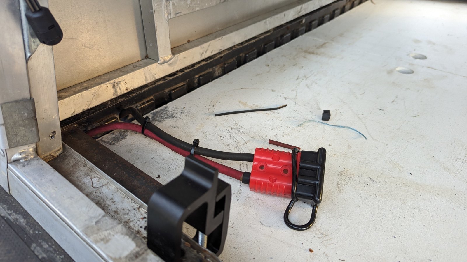

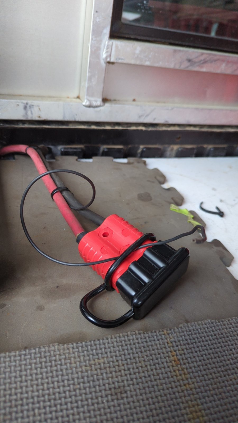

    Ran the 2awg wires to the back today.

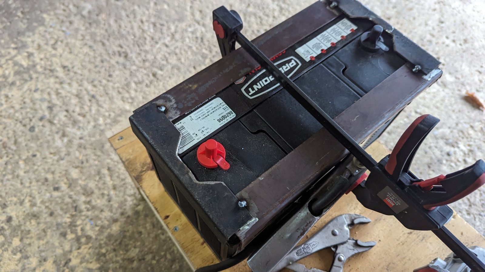

    '14 Acess Cab

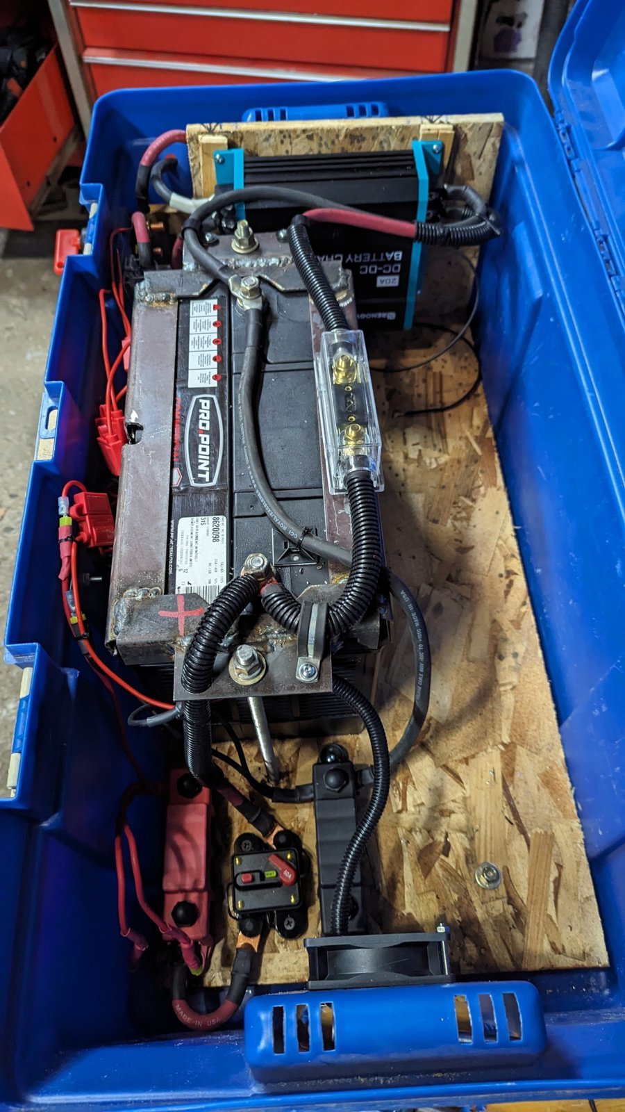

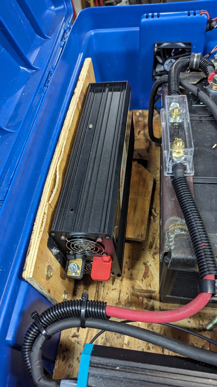

    Welded up a hold down for the battery ( with the battery underneath it) :) haha just tacked it together did not want to blow up.
    And made a little more space for the switch panel which was defective so I sent it back.

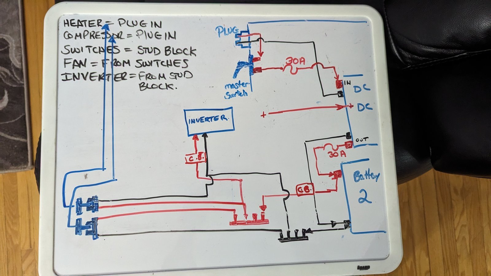

    '14 Acess Cab
    This diagram keeps changing as I move along with this.
  4. Dec 10, 2023 at 1:08 PM
    #404
    tacoma16
    tacoma16 Well-Known Member
    Mar 15, 2011
    #53109
    11,111
    Peter
    Ontario
    Double cab SR5 4x4
    Very nice. Like how it’s removable so you can use the truck and what not.

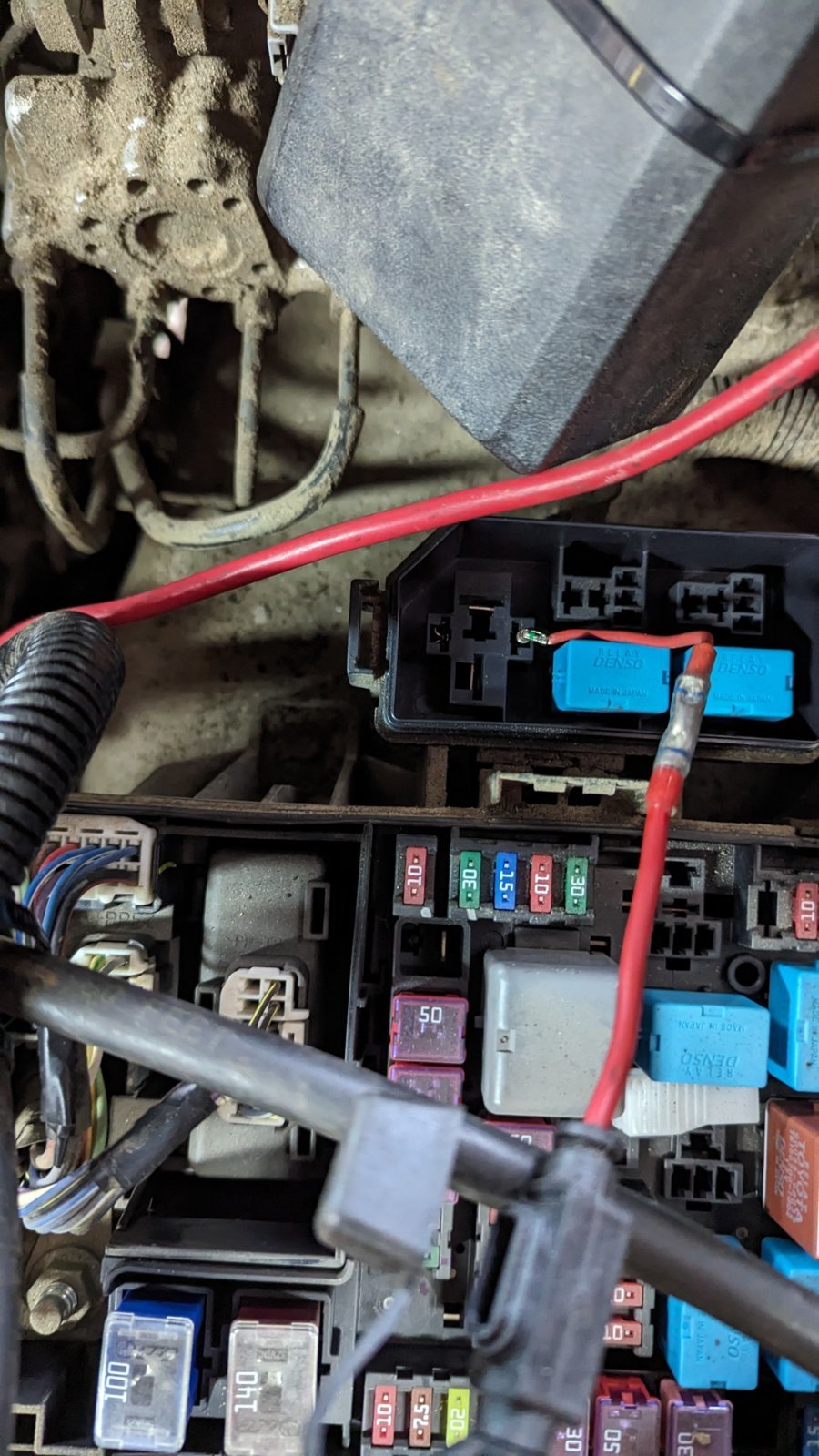

    '14 Acess Cab

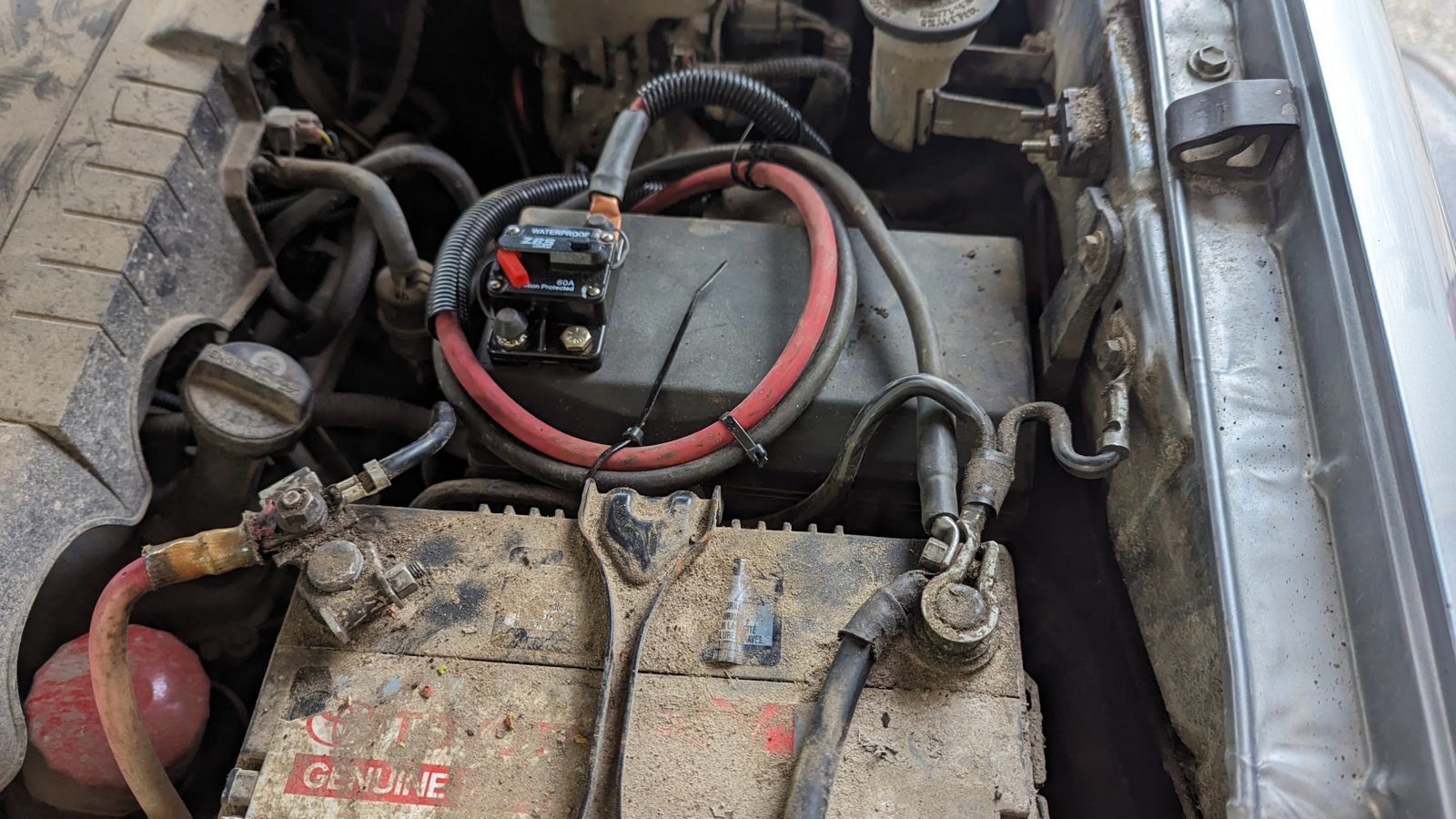

    2014 Tacoma key on only power. Don't bother looking it's only under this relay maybe others too but this is the easiest to tap from

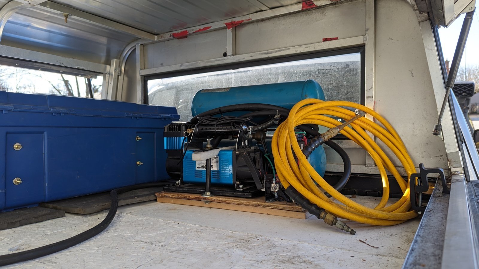

    '14 Acess Cab

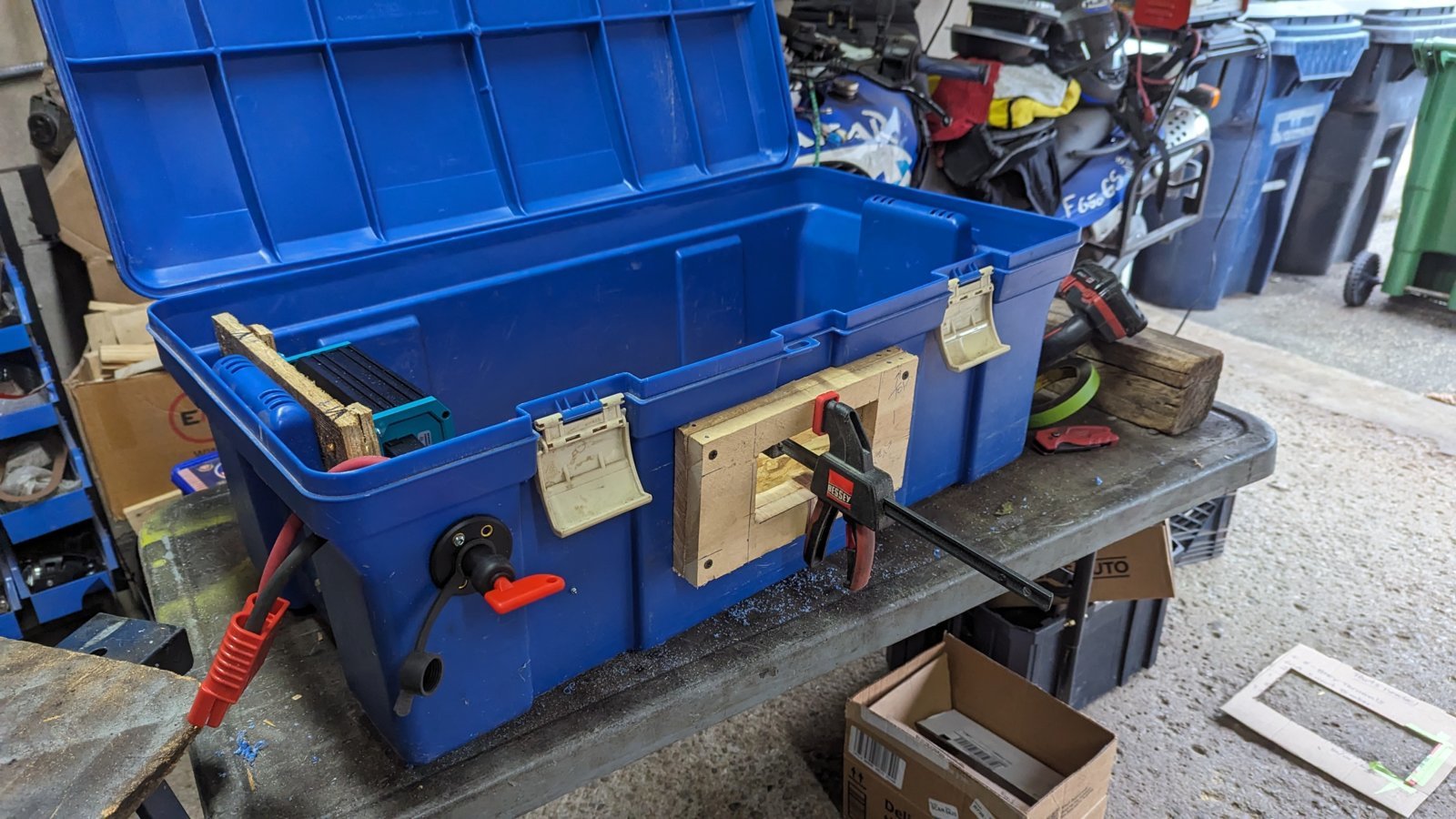

    Air compressor up and running today. Box still needs some work.

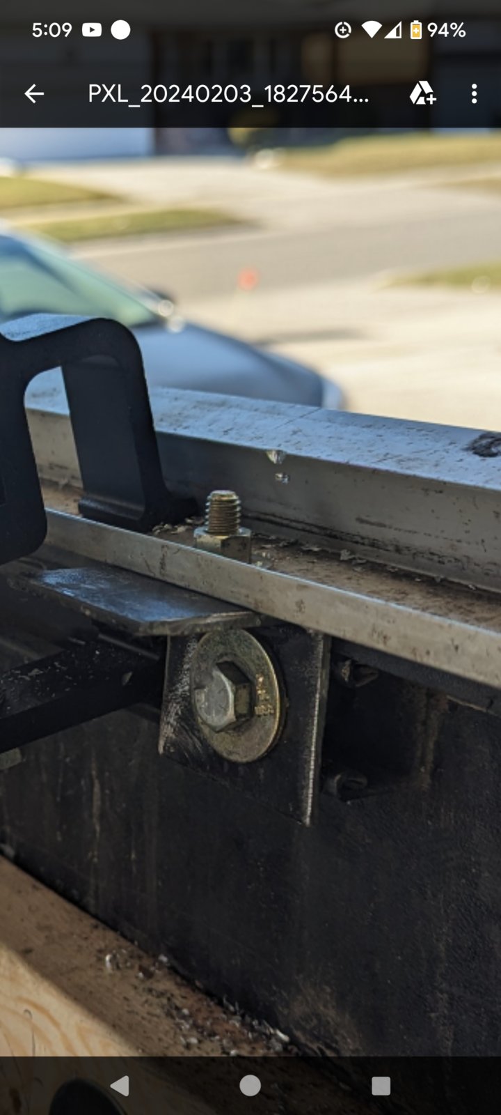

    '14 Acess Cab
    Took some time to remove the cap clamps. They never seem to stay tight. Anyway made some brackets to hold the cap. Cap is from a ranger so kinda doesn't fit, but fits. :)

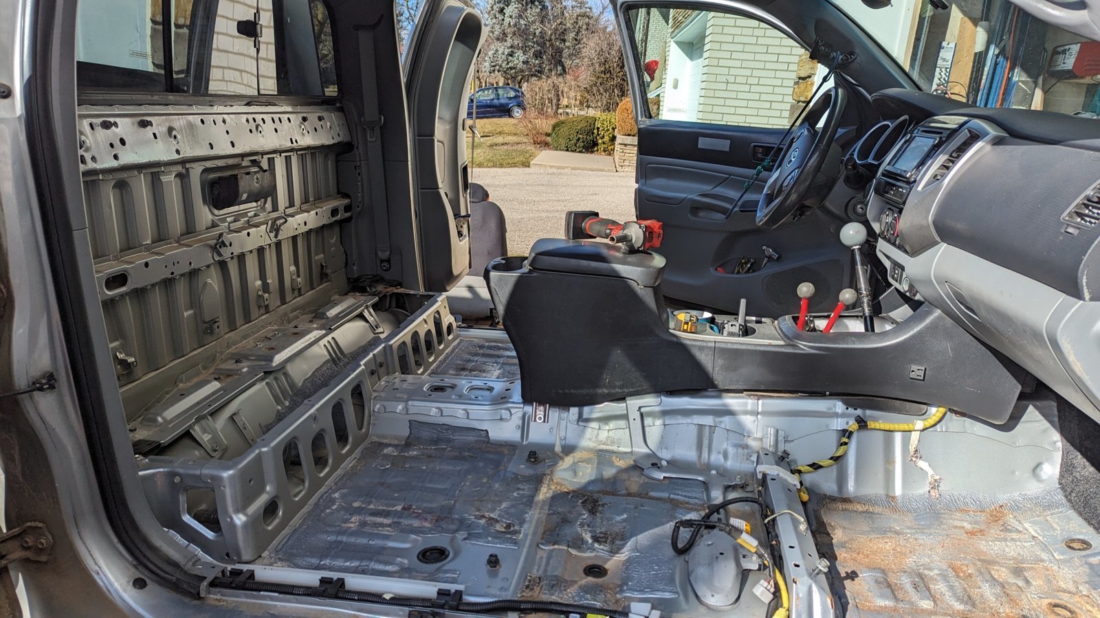

    '14 Acess Cab
    said good bye to carpeting today. Wanted to do this for a while now and seems like the stink in there just kept getting worse after I had a couple of visits from a mouse or rat.

    Double cab SR5 4x4
    Lining the floor with bedliner or just leaving it as is?
    Windigo[QUOTED][OP] likes this.

    '14 Acess Cab
    Leaving it for now. The smell is all gone btw. Might even cut the boxes piece out in the back let's see so many things wanting to do...

    '13 Barc. Red Tacoma SR5 4X4
    I’d drive it for a spell but it’s gotta be noisy & somewhat cold too. Thick rubber floor would do but cutting those floor curves would render it useless for water capture. Can’t be slippery either so maybe check out a flooring store. No Astroturf please.
