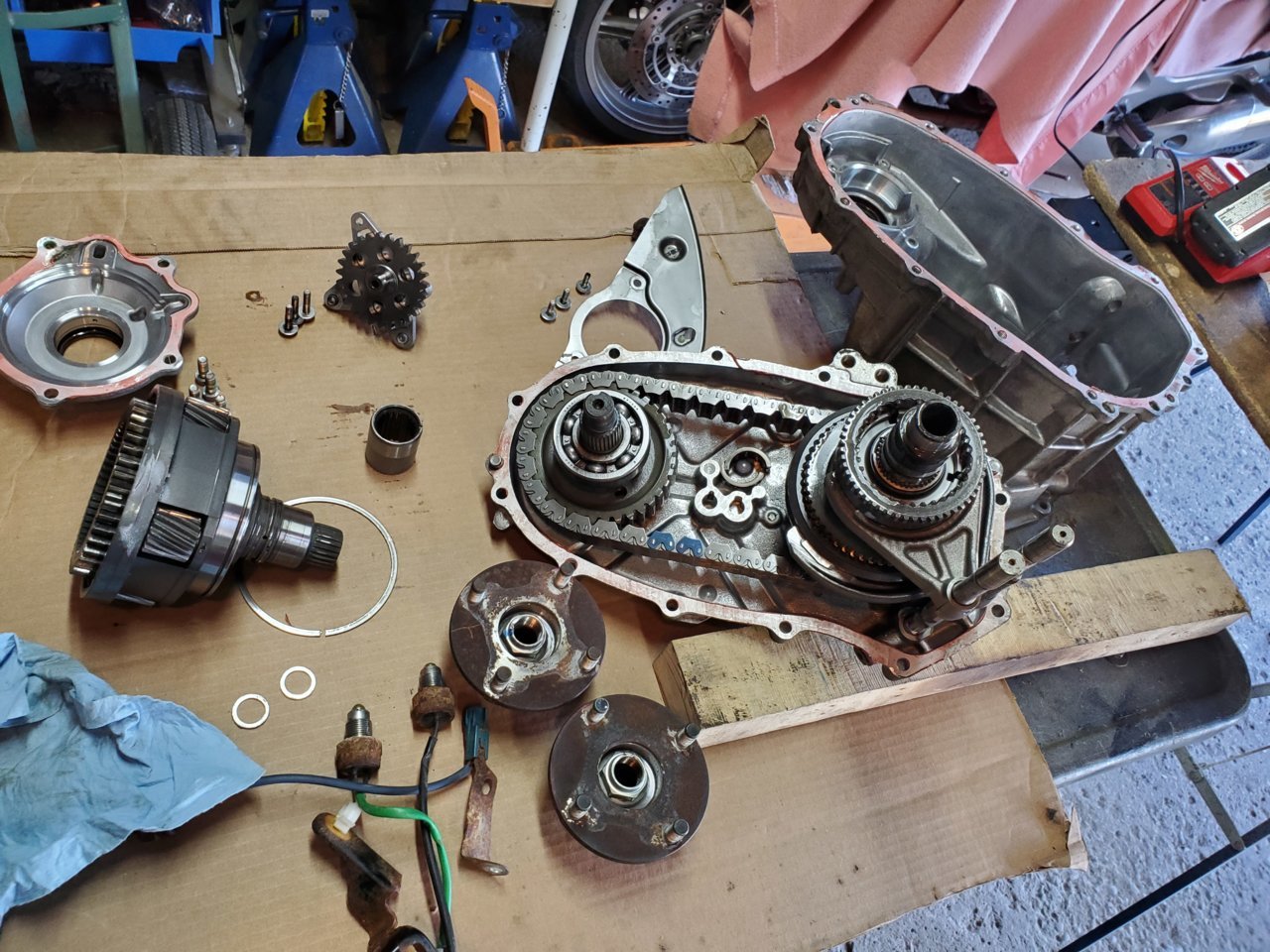

    Good morning Friday. Today starts out like this

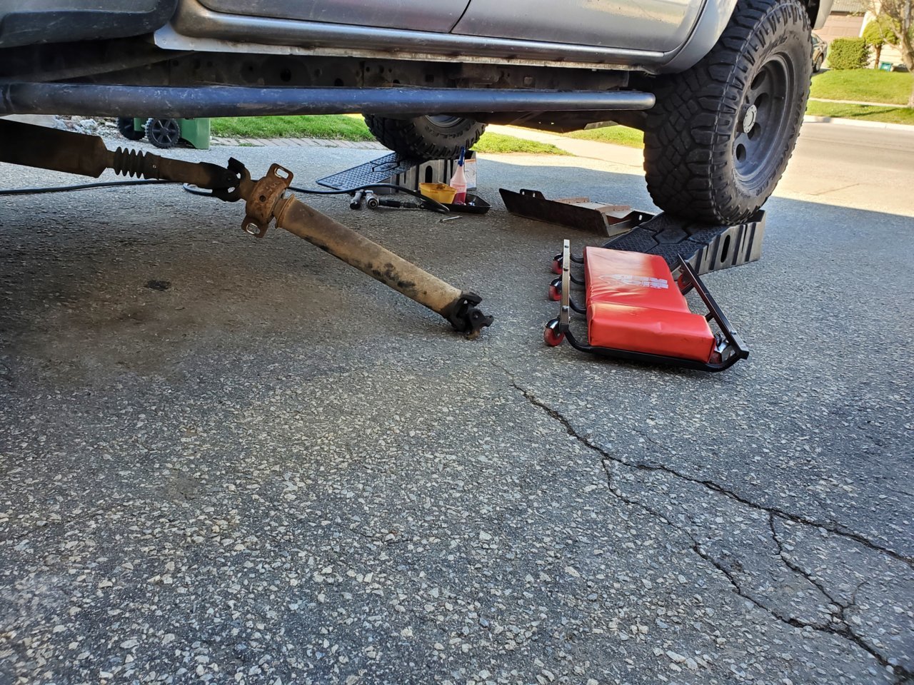

    My weekend work has started.

    @Windigo did you buy a rebuilt kit for the FJ t-case?

    Nope. Just winging it.

    It’s a toyota. I found that most of the seals were fine. Just the pinion ones were iffy so for the price I bought a rebuilt kit. I didn’t change two or three seals because it would have required taking the entire case right apart

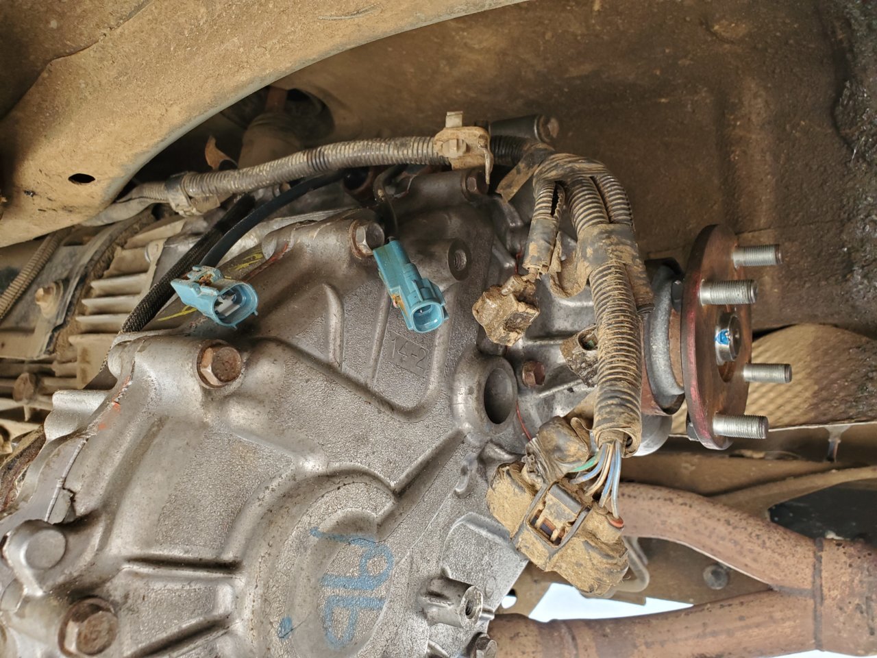

    Any ideas........

    You are now at the point of bypassing the 4wd ECU and making the dash lights work with those blue sensors.
    (I THINK :cookiemonster:)

    Well still under.the truck installing. But tomarrowns job will be to cut.floor and lights. I dont have an4rd ecm as of Wednesday. Already done.

    Dond know different connectors and I used the original fj t case switches.....

    You should be using the connectors from the fj case. They should plug directly into the Tacoma sensors
