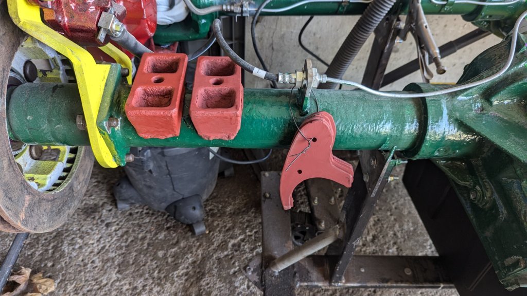

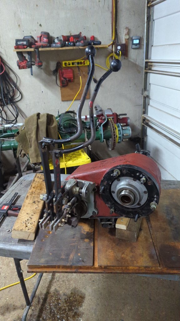

    Well I finally got around to finishing the Dana 300 shifters. The levers are just tacked on as I'm just guessing where it's going to come through the floor.

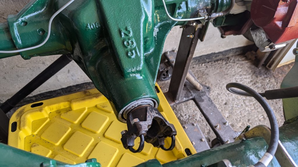

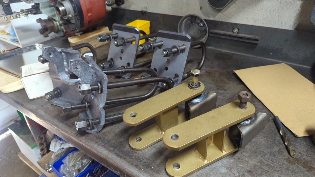

    '14 Acess Cab
    I got the rear spring perches cleaned up, made up some 3/16 thick shock tabs. Don't know if I'll use them. They look kind of funny. And also got the u-joint u-bolt kit for the Dana 60 which is going to bolt right up to a 1330 u-joint. So same as the 2nd gen Tacoma drive shaft.

    '14 Acess Cab

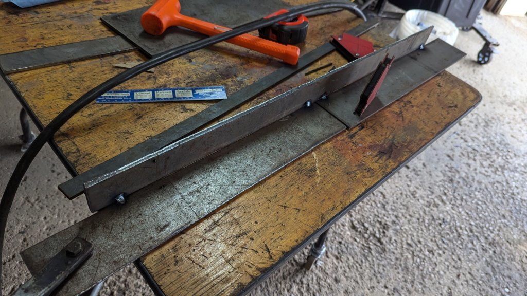

    Made a set of shock tabs fro the front.

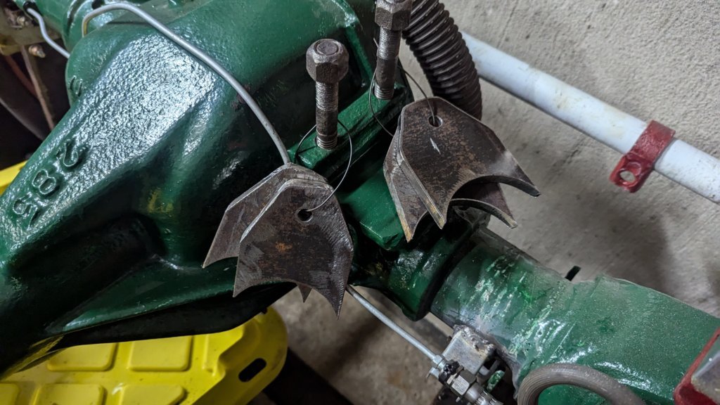

    '14 Acess Cab
    More parts arrive today front shock hoops. Painted them trying to prevent rust.

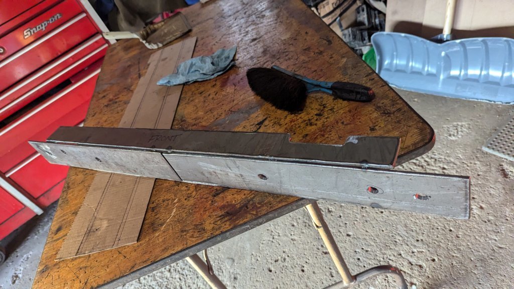

    '14 Acess Cab

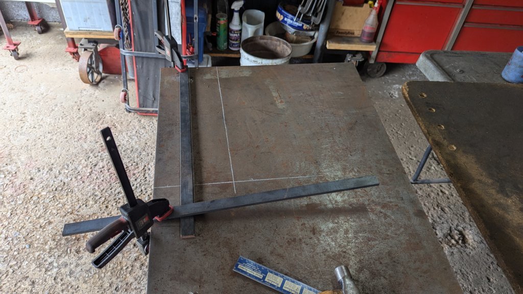

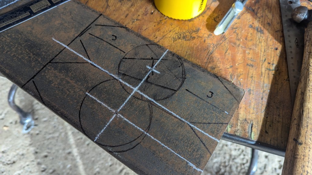

    I got off to a good start making a bolt on front leaf spring mount. I want to keep the arb so working around it. the metal I'm using has been sitting in my garage for at min 12 years. My new thing is anything sitting for a long time has to be used up.

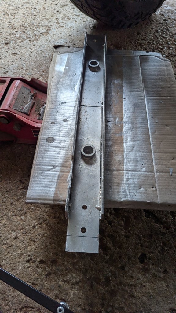

    '14 Acess Cab

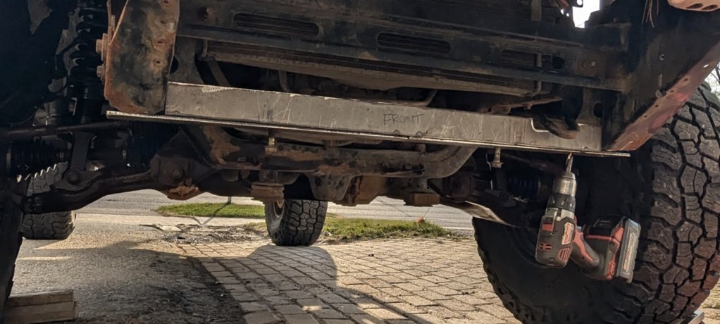

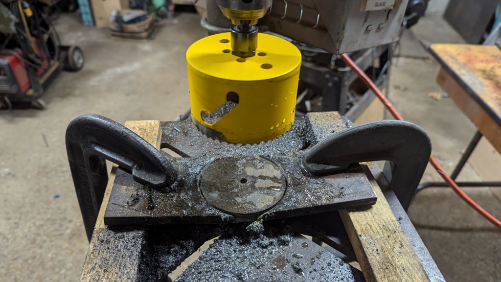

    Did not have a lot of time today but got some holes drilled and a little clearance for the stock tow point

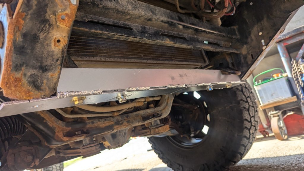

    Double cab SR5 4x4
    Is this going on the bottom crossmember just below where the bumper mounts up?

    '14 Acess Cab
    Exactly test fitted none of the holes lined up :rofl:
    With me It's drill first then measure.

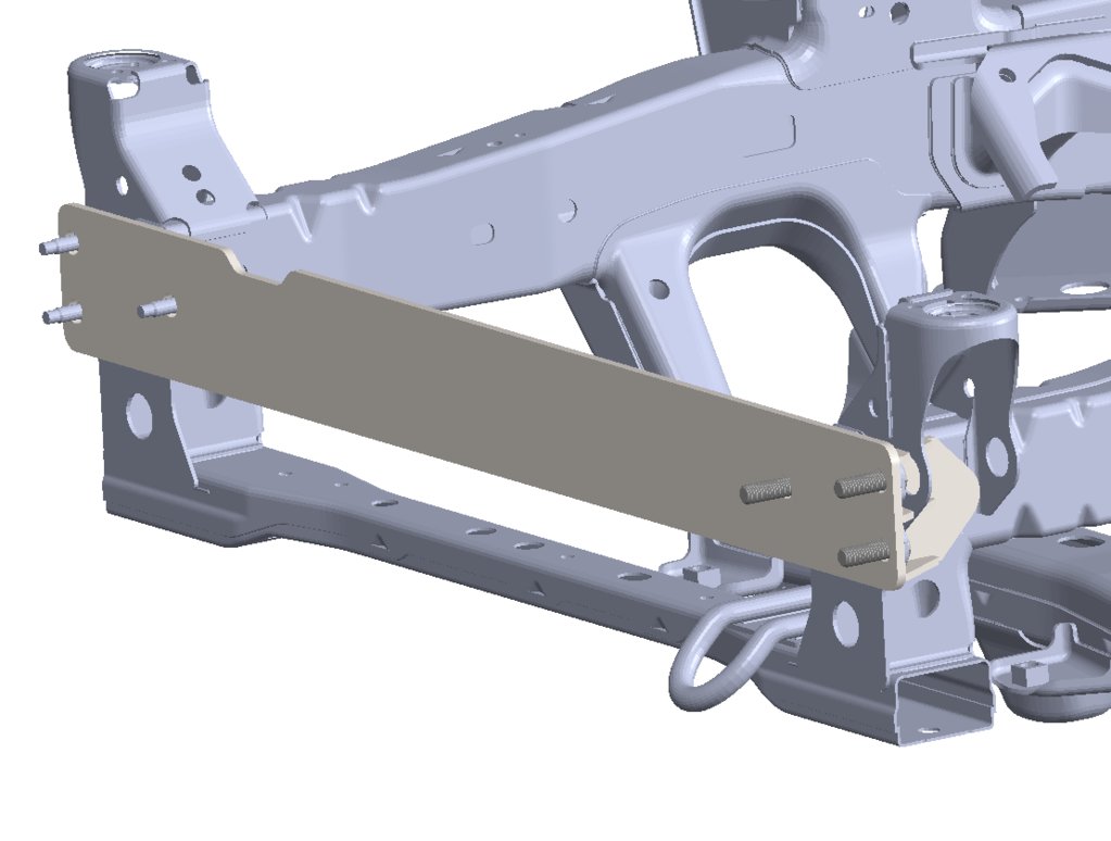

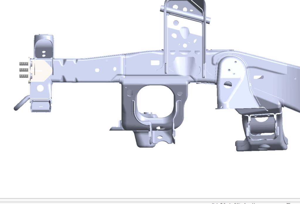

    Anyway going to look something like this

    Fox and Locked suspension 63's Skinny 33's
    So you are doing a SAS on leafs? I wouldnt bolt that to that stock hanging down crossmember. Its not very thick and its cantilevered way out. And you are going to be hitting those front mounts on everything and anything possible. Id do a crossmember chop then mount the hangers 4" higher and a more rigid spot too.

    yes doing a sas on leafs. you idea is better than mine.. but Im trying to keep the arb so thats why all the funny stuff is going on
    The vertical spots on that crossmember aint very thick(0.100" according to this cad file). I will admit I do not know a ton about running leafs up front but I think mounting a suspension mounting component to anything less than 1/8 sounds like a bad idea especially with how it kinda just dangles down there.
    You have a welder, could just cut up the arb a little bit

    '14 Acess Cab
    yea when i was looking at the truck i seen how thin those pieces are... I'm going with the wrong front axle, the wrong suspension set up and looks like the wrong mounting points. at this point its not looking very good especially if i cut off the front suspension. A Hail Mary comes to mind, and thank you food for thought for sure.

    '14 Acess Cab
    got the front spring hanger welded, painted and bolted in
