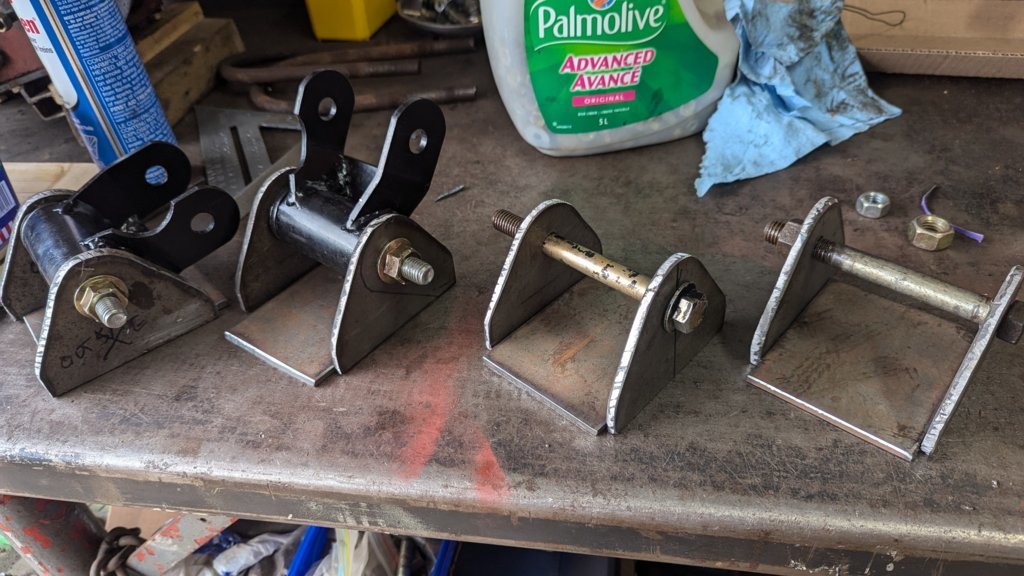

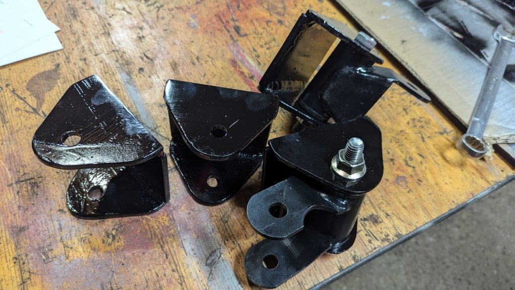

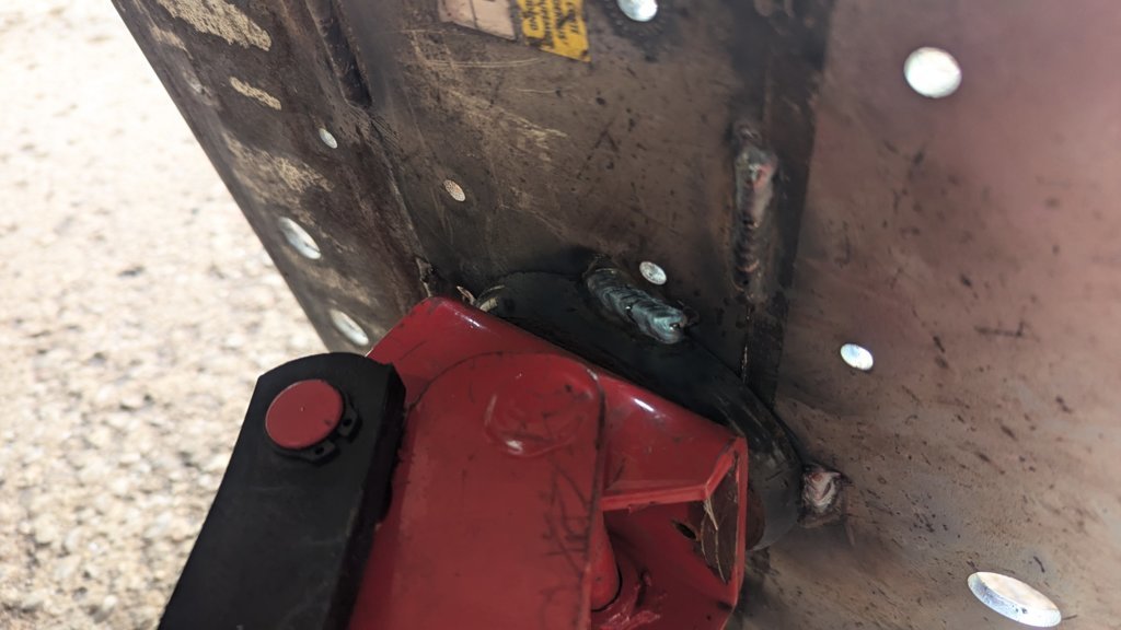

    Decided to go with shorter shackles and made up some brackets to fit..

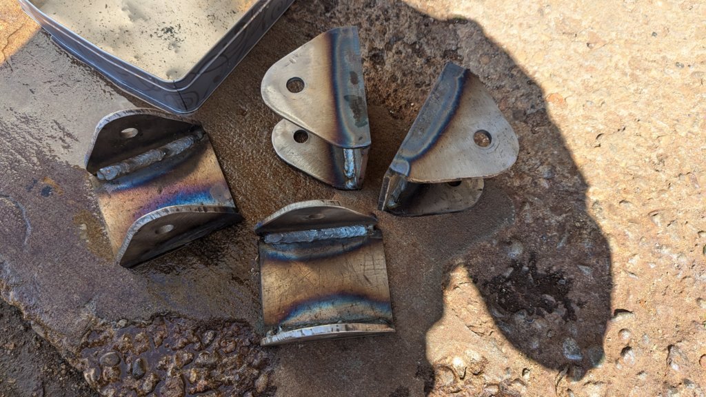

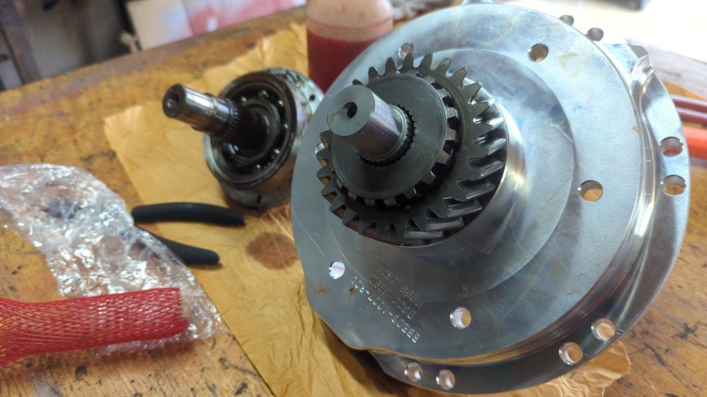

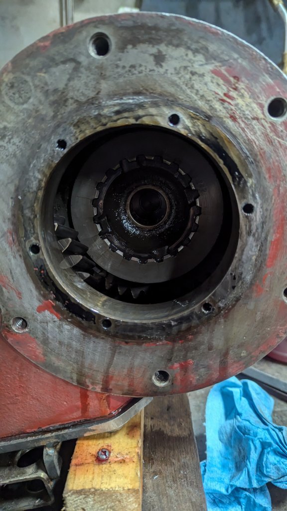

    So I got the Eco crawler in the mail. I wasn't happy at first cuz there was no instructions in the box. I called them and left a message and they emailed me a link to the internet PDF instructions. But that's for two Toyota cases and mine's going to be a Dana 300 behind the Eco crawler. Pictures are parts I received. Dana 300 with input shaft removed. Input shaft gear off. And what I think should happen but I don't know cuz I don't have instructions. That's the last picture. In the last picture the Northwestfab shaft is just sitting there but I think it should be pressed in. Not sure yet. I'm going to wait until I have contact with them.

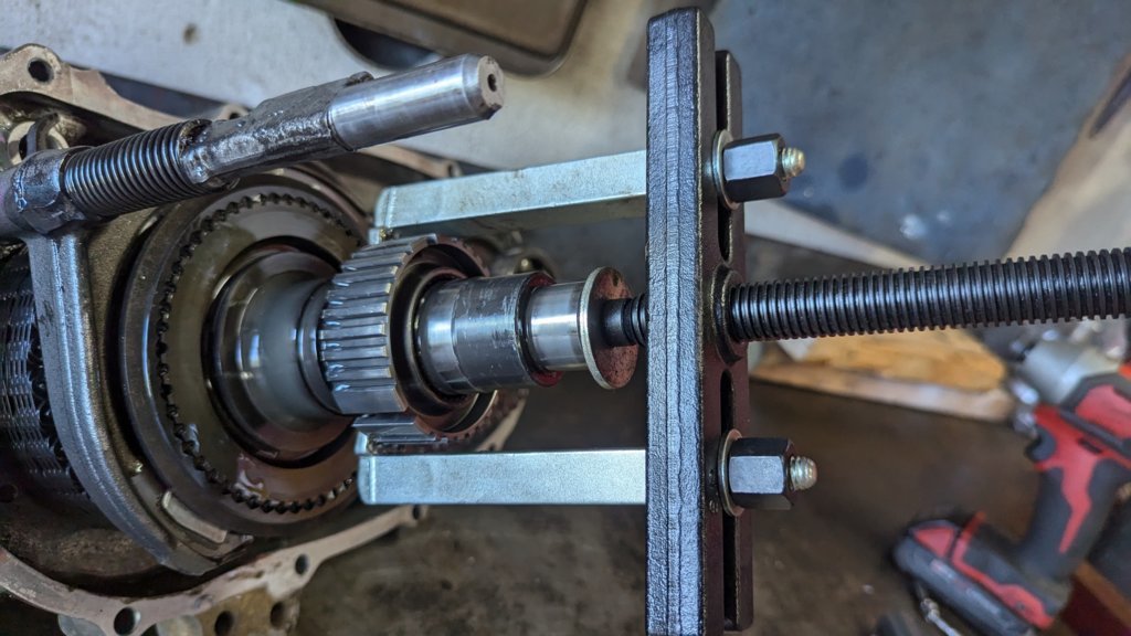

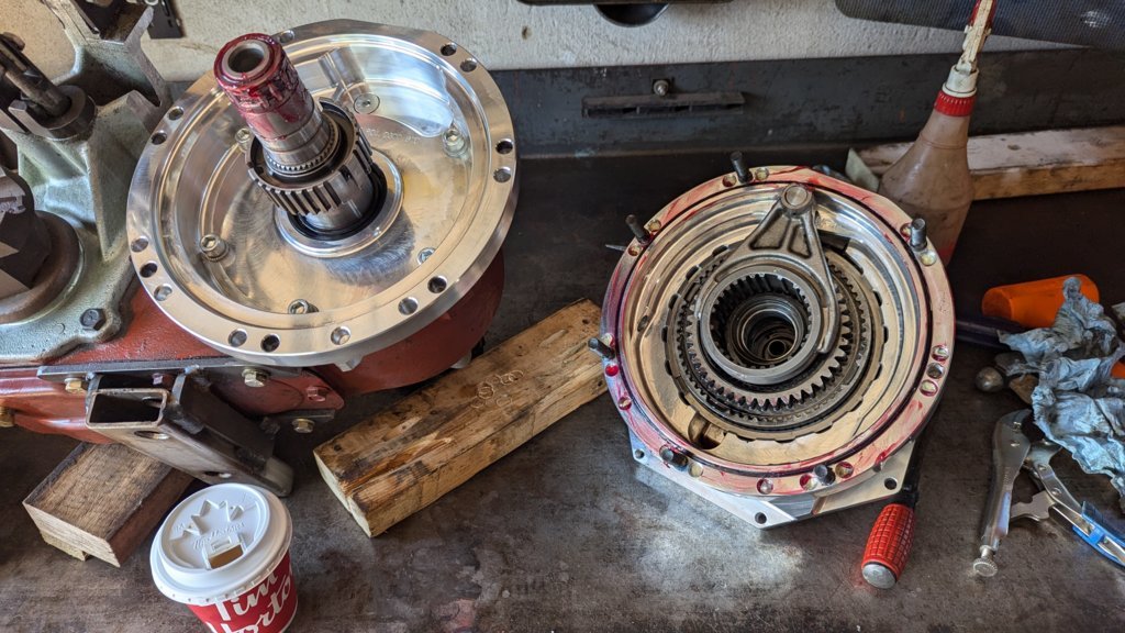

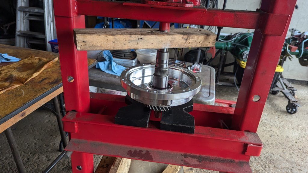

    Ok so back to the build thread. Well it will all be just pictures of " so far this is where I'm at." With my build.
    Pictures
    1 pressing the gear onto input shaft
    2 Removing gear that will be installed onto new input shaft
    3 the 2 half's assembled and ready to put together
    And the previous post of testing it all out.

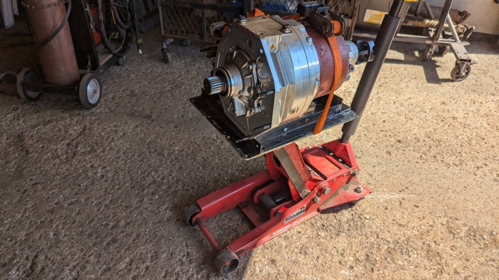

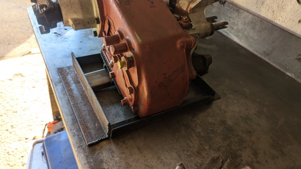

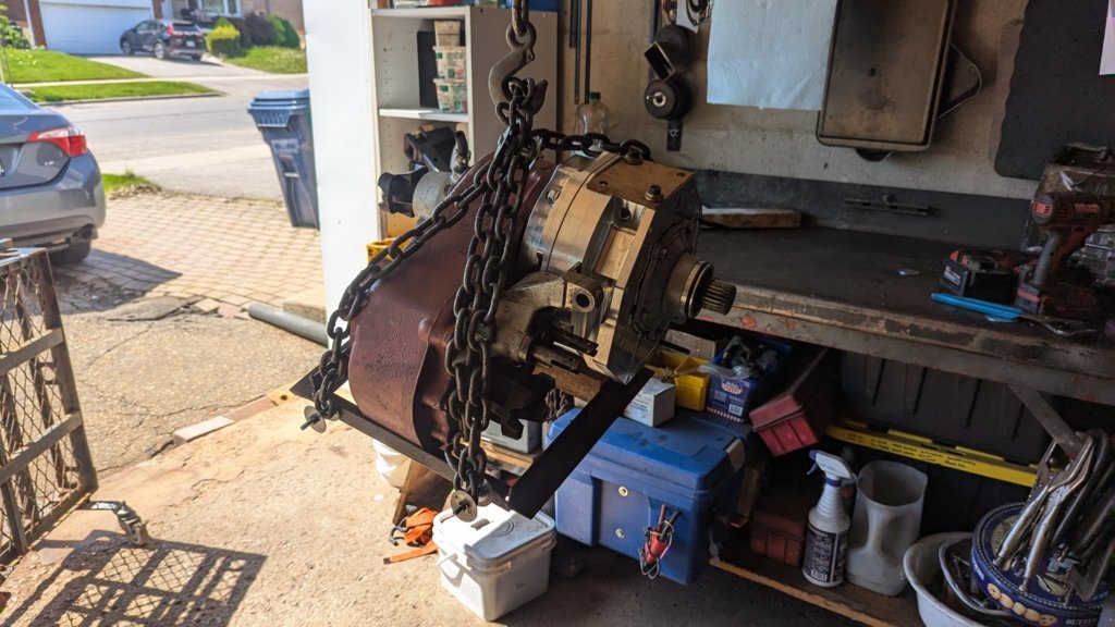

    Modified floor jack to fit my t.case hopefully it will work might still need help. I'll ask if I can't do it.

    anyone wondering how the t case got on the jack:)

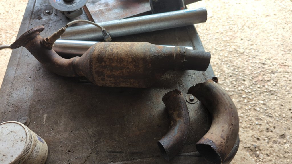

    '14 Acess Cab
    So I avoided an exhaust re route for 5 years. But now I have no choice so I started with what else... Broken studs. :frusty: anyway there out now. It's a good Sunday afternoon time killer.

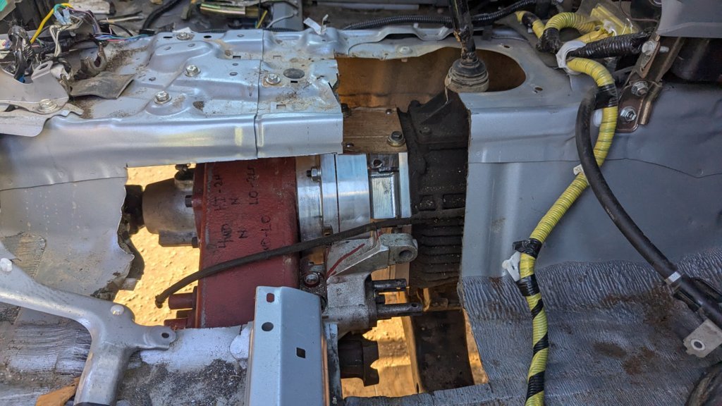

    Who wants to be my T.B. :)

    Little weight reduction. Nice

    If you only knew, what a mess. 2nd gen. Tacomas are not ment for pass. side transfer cases. Ill close that up somehow.

    Yeah. Driver drop and even fitting a one ton is tough.

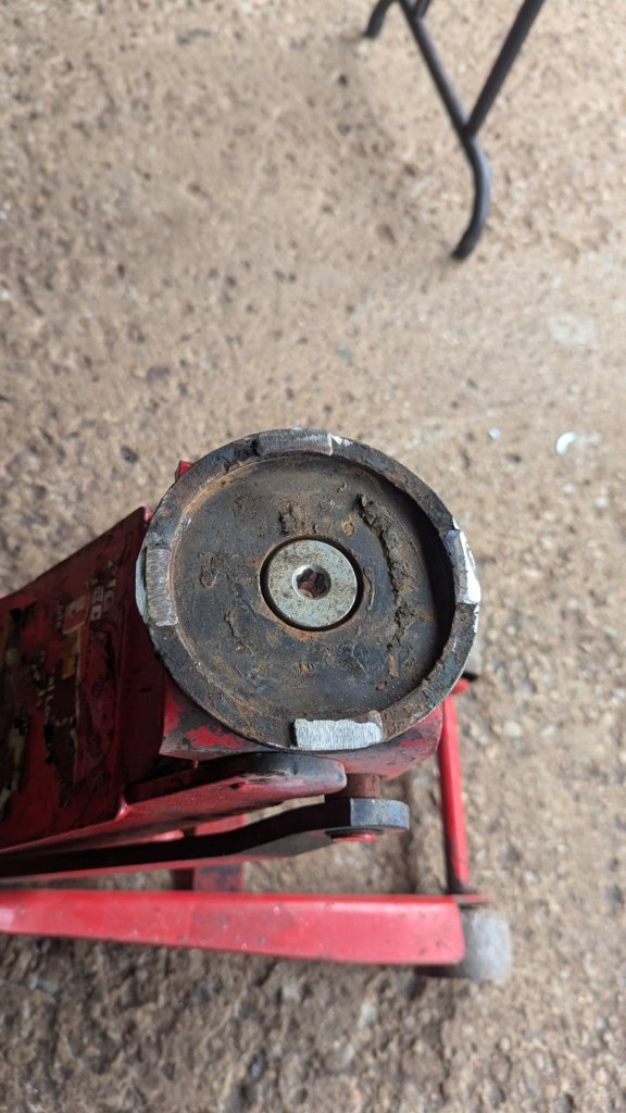

    Raining for the past 2 days so decided to transform my floor jack that went to tranny Jack back to a floor jack again
