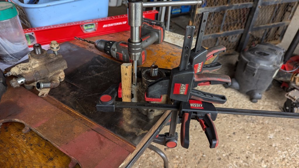

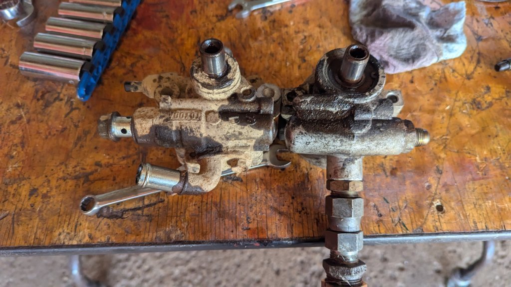

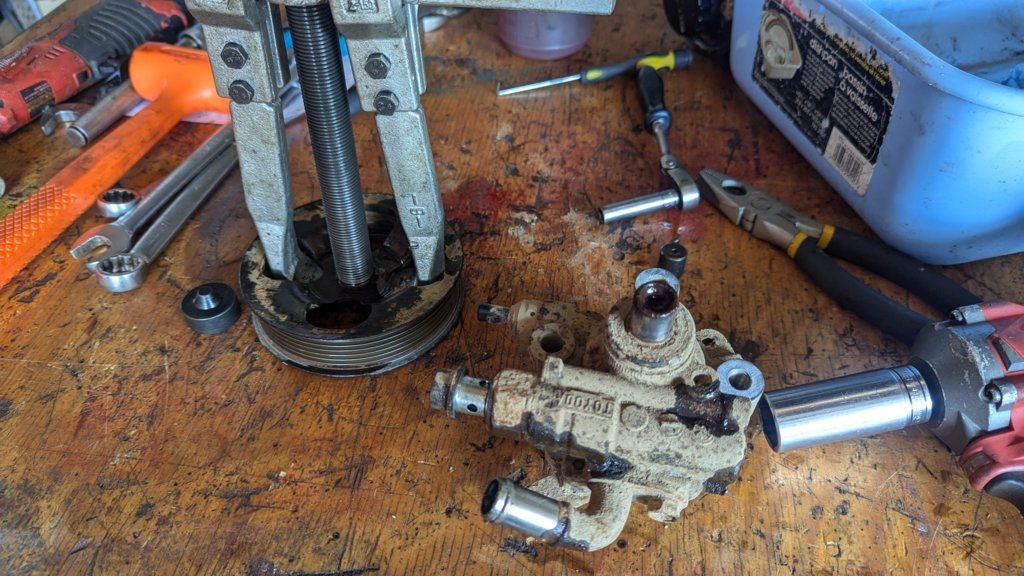

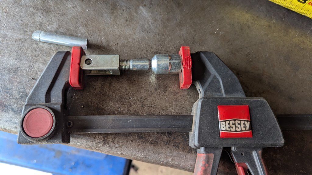

    modified a powersteering pump to bolt up.
    you need an 8mm drill bit and a m10x1.25 tap
    also remove stock pully and put onto you new or used pump
    since my machine shop is making parts for the golden dome I had to come up with a way to drill a straight hole in the power steering pump.

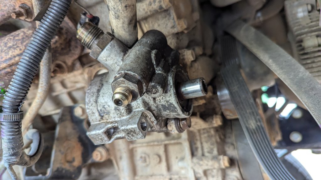

    That has to be changed eventually. But it will get me by for now.

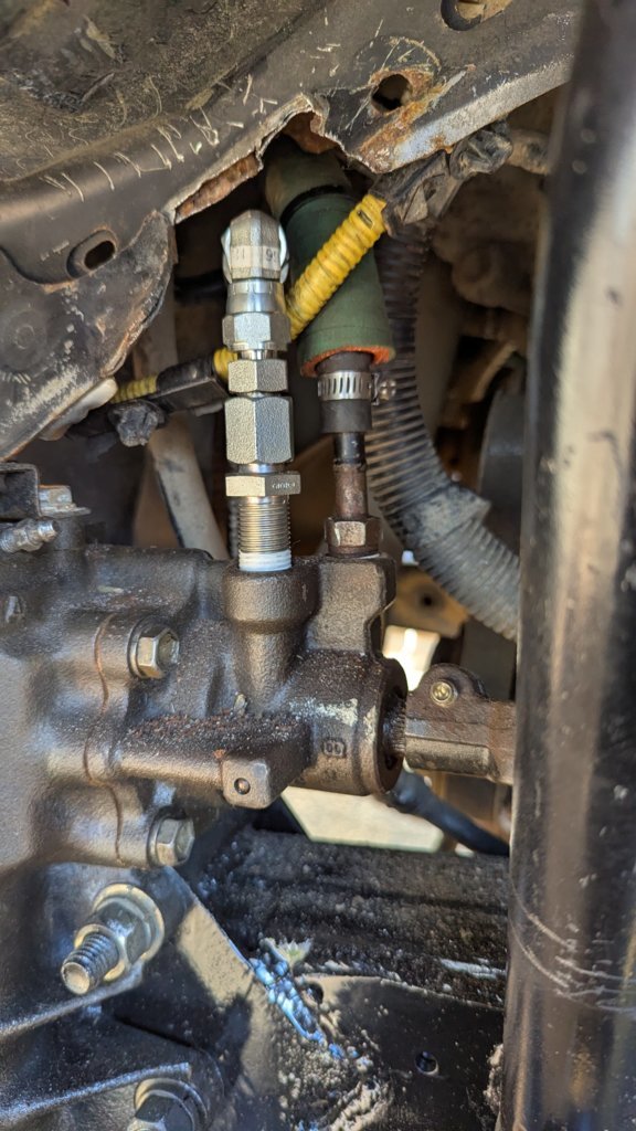

  4. May 26, 2025 at 2:53 PM
    #644
    Windigo
    Windigo [OP] Well-Known Member
    Dec 21, 2019
    #313884
    4,155
    Farook
    Toronto Ontario Canada
    '14 Acess Cab

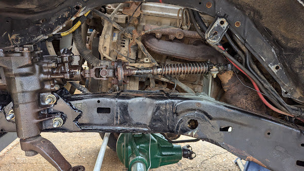

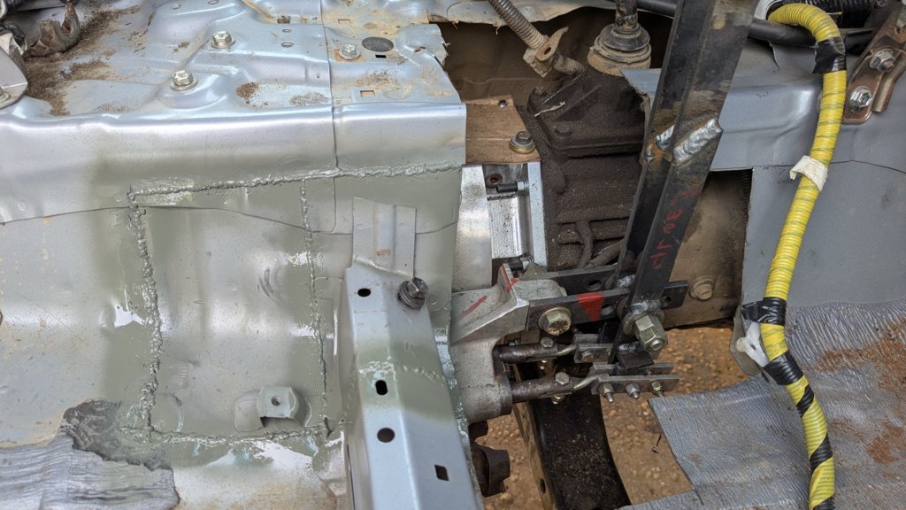

    Finally got a fitting for.the power steering box. The one in there never reached bottom so never stopped turning.
    Also got the t.case crossmember done. Made from Scrap pieces

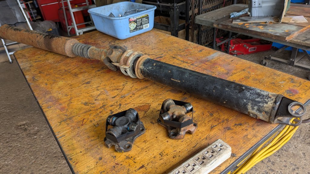

    Got some u joints with flanges off. Just waiting on some conversion joints 1330/1350 and 1330/1310.

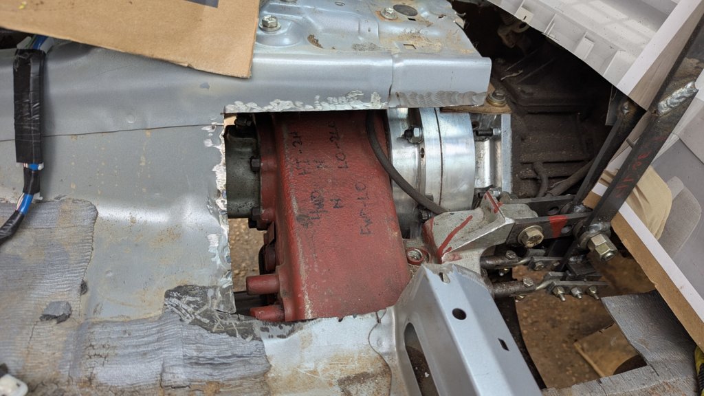

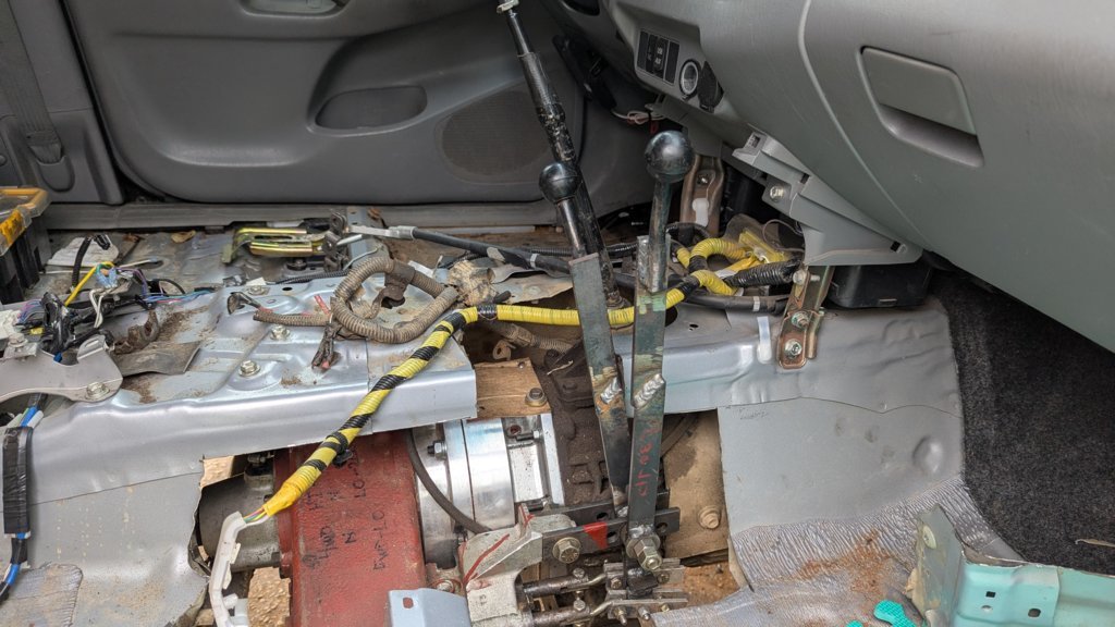

  11. May 31, 2025 at 7:55 AM
    #651
    Windigo
    Dec 21, 2019
    #313884
    4,155
    Farook
    '14 Acess Cab

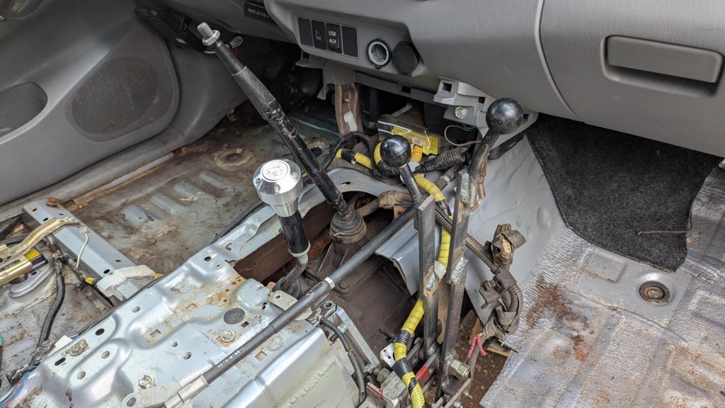

    Loosing a lot of days to crappy weather anyway the other day I got all the shifters in place. I'm going to leave the floor untill I get it running again.

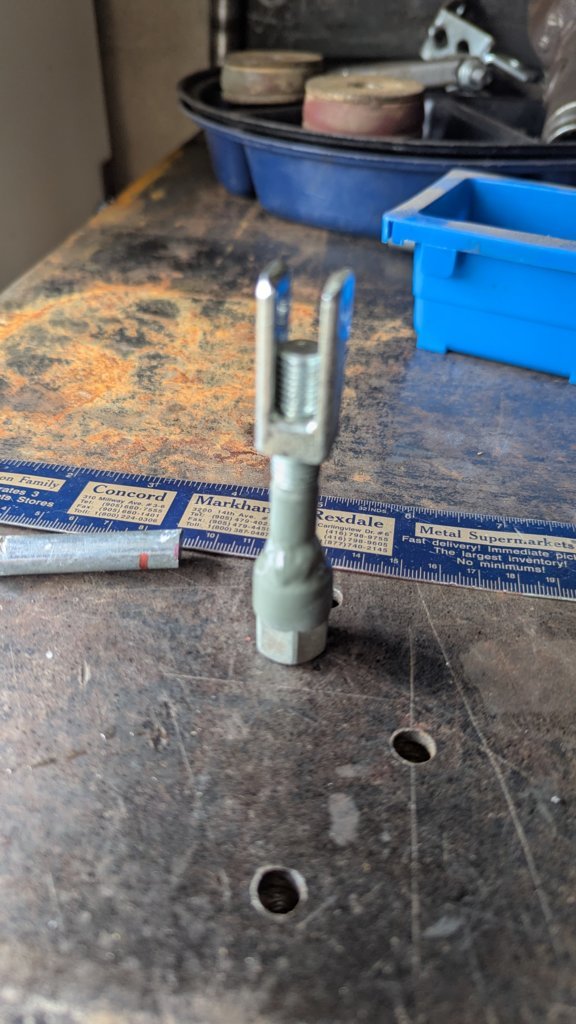

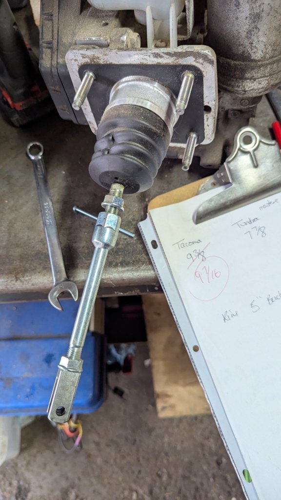

    Tundra brake booster pieces
    Pictures are the original push rod and push rod modified to fit on tundra booster

    Made my own brake booster to master adapter
    Little insert piece is 1/2 steel rod drilled at one end shaped at the other master cylinder not fitting :rofl:
