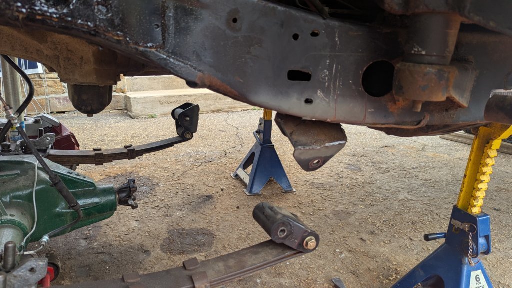

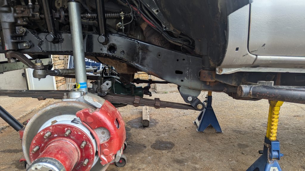

    I still can't figure out why the leaf springs want to separate sideways. I'm going to change the shackle angle to a less Steep angle and see if that helps. The pinion shims I don't think it really helped.im hoping to put this all back by Wednesday ( here I go giving myself timelines again).:)

    Nice progress. Can you get some leaf different leaf springs with some arch? Those look really flat with those shackles?

    the problem is The truck will be too tall. I did not want to do what I'm doing now because i think it will add another 2" of height to the front. I'm short. this truck is too tall as it is with flat springs. But yes if I cant figure this out maybe another set of springs might be a good idea.

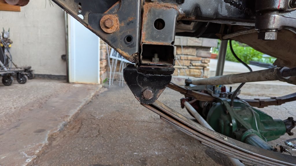

    Remove the front spring hanger just to weld it up a little better

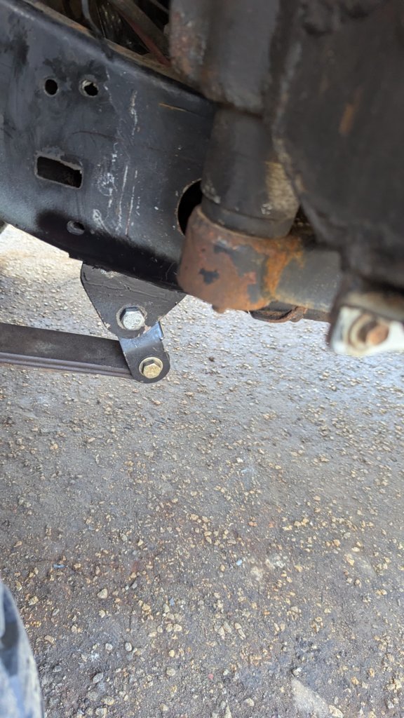

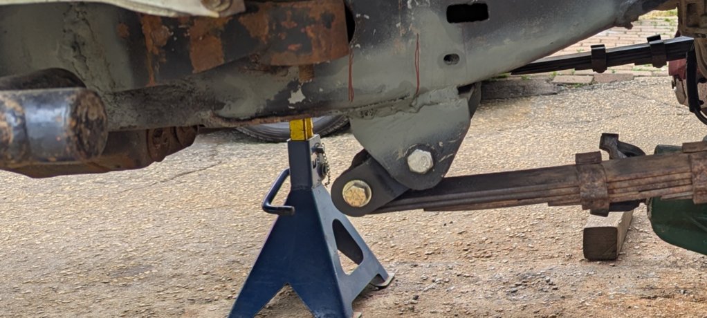

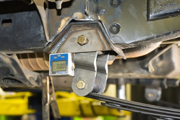

    Shackle angle before and after
    tacoma16 and llamasmurf like this.

    The couple of 2nd gen SAS builds with leaf springs have already done the front crossmember chop, which allows the front hangers to be moved up. It has its own potential complications with tie rod / drag link clearance at full compression.
    I don't see any leaf spring SAS kits for 2nd gen Tacomas, only for 1st gens. Those kits list a plasma cutter as a required tool in the instructions, because they pocket the frame for the shackle:
    You can also try an SUA setup, at a loss of ground clearance. So yeah, potentially difficult choices ahead. :anonymous:

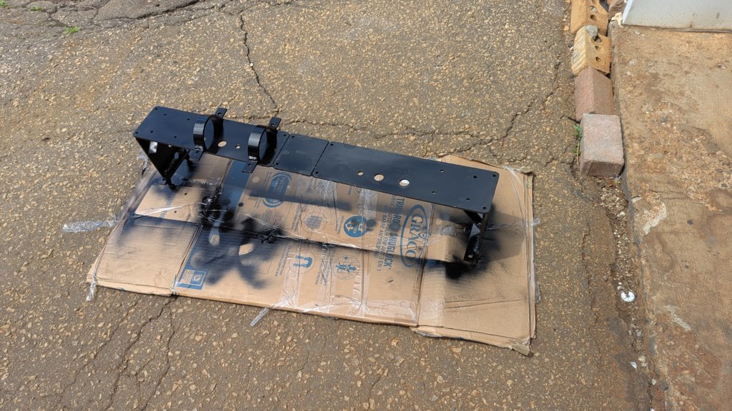

    While I am waiting for some rear u-bolts because I cut the ones I had too short, I've decided to try to make some sort of rear sway bar Mount. I've pretty much given up on the front as one of those things I have to leave to the end. I don't know if this is going to work but like everything else I've made for this truck it's just out of scrap metal I have lying around.

    Thanks. The rear sway bar Mount is being made to accomodate any sway bar. So if I decide I need smaller or larger dia. Bar I can just bolt another on.
    Planning on having wheels on sitting at ride height and rear sway bar by next week.

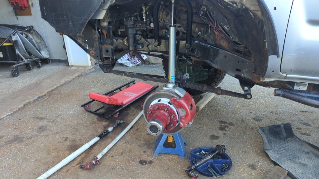

    I still have to make some upper mounts that go on the frame but this piece I'm going to bolt onto the axle and hopefully bolt a sway bar to it.
    llamasmurf, tacoma16 and TunedUpTaco like this.

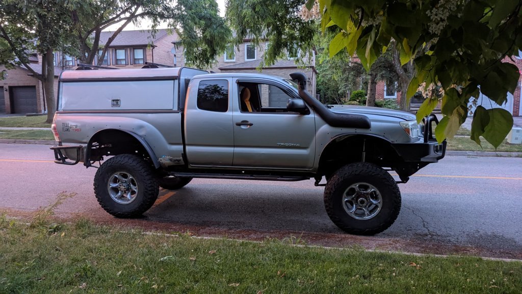

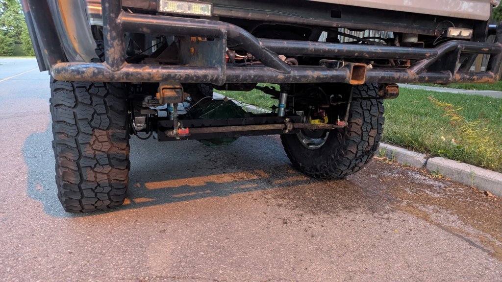

    So my truck turned into a BGLT
    Big gay lifted truck. Anyway it's got a fast sway side to side when driving:frusty:
    The rear sway bar is on don't know if it's doing anything. And it drives like an 1970 Ford farm truck.
    Not very happy with it.
    But hear it is on the wheels.

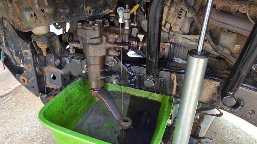

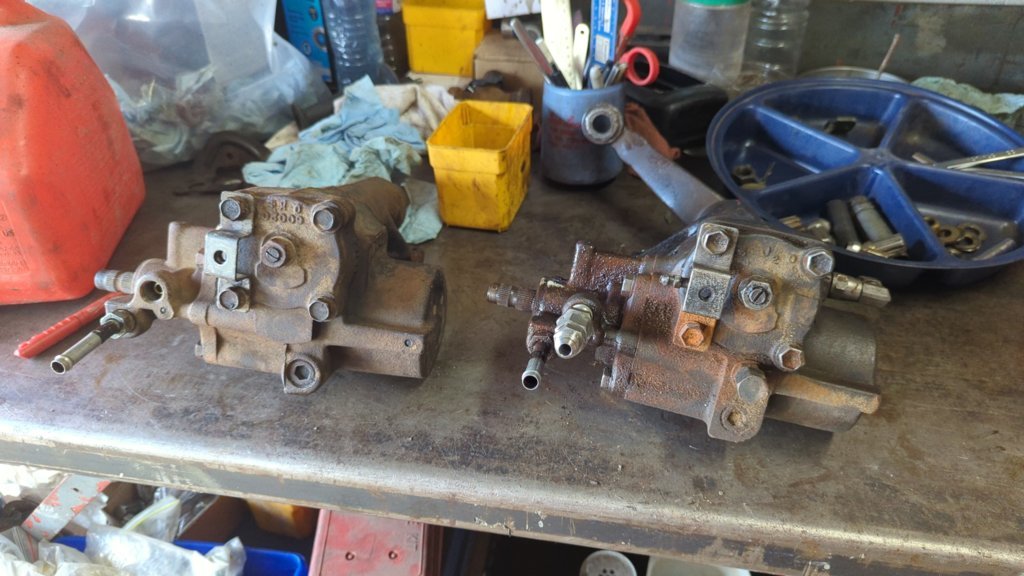

    This morning I decided this truck is undrivable. So I took everything apart in the front end checking all joints, wheels, bearings, it seems that the steering box has a tight part if that makes sense. As you turn the steering wheel it gets tight then gets loose and then as you turn it back it gets tight then gets loose after checking everything. It's the steering box.

    Well, steering box #2 in.

    Double cab SR5 4x4
    Well, it’s working. Time for refinement I guess. Only thing I can think of for lowering it is cutting the front crossmember out and frenching in the hangers wherever you can. Other then that you got yourself a taco in one tons

    thank you. I know this sounds korney but thanks for keeping up with my journey along with others that have been interested in what I'm doing.
    there are a ton of things left to do but yes I have a taco with one tons. I'm racing against time, this year I'll turn 58 hopefully there will be enough time left for me to get it where i want it to be. right now I can just live with it the way it is.:turtleride:

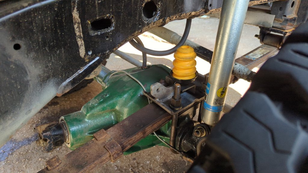

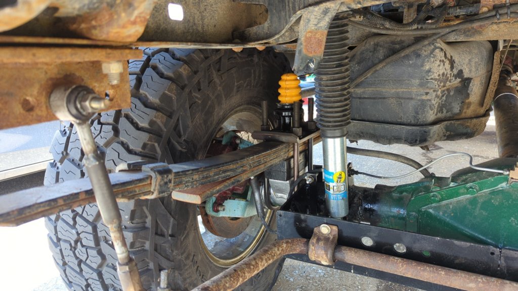

    Well today was about bump.stops front done and rear don'e.
    lowmower, TunedUpTaco and Steves104x4 like this.

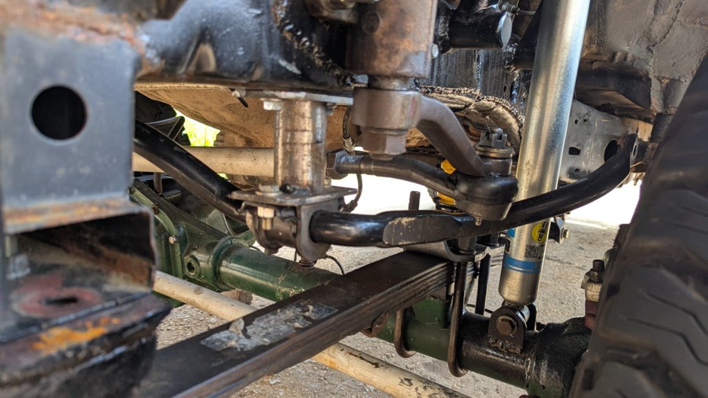

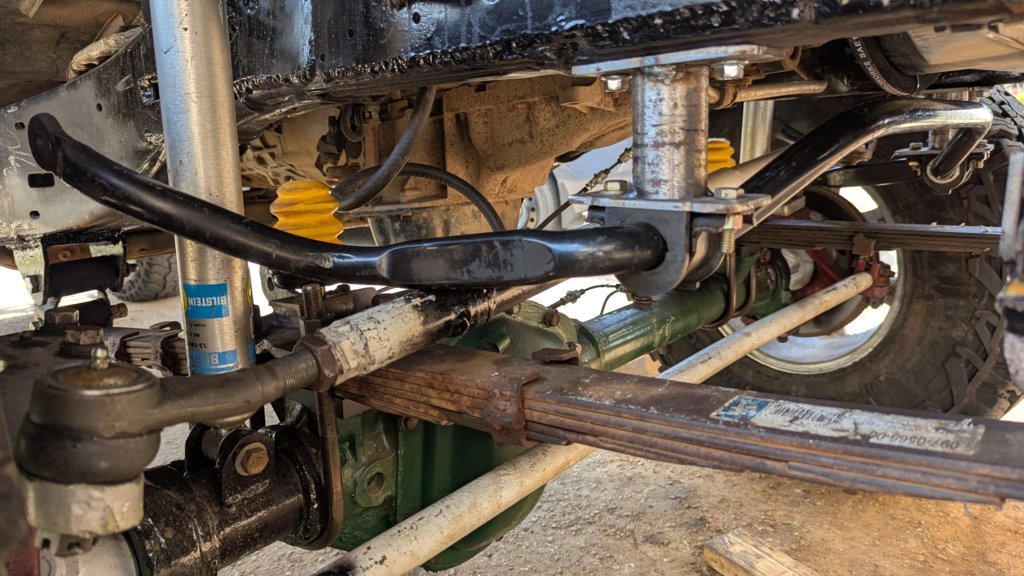

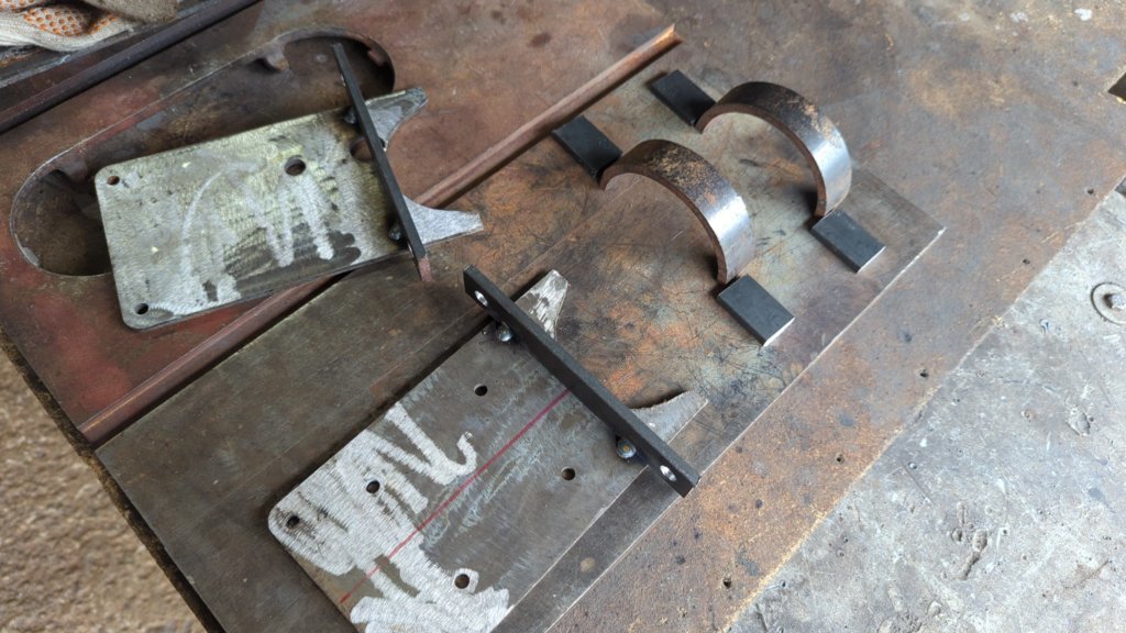

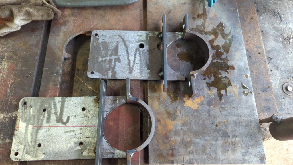

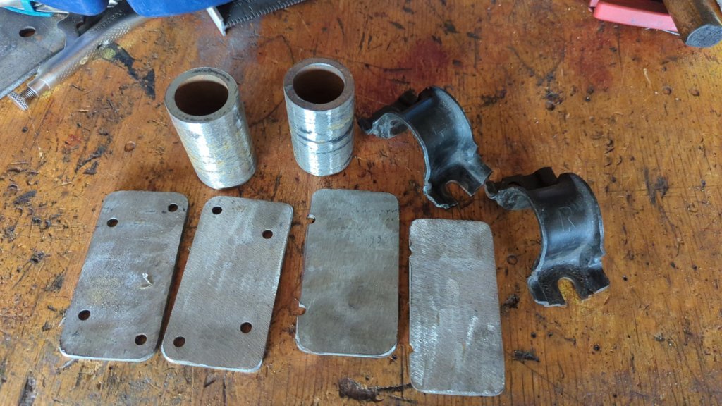

    Fabricating a mount for the front sway bar. Starting off with these little pieces.
    TunedUpTaco and tacoma16 like this.

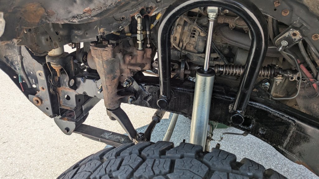

    Any ideas please speak up because I'm at a loss for a sway bar. I thought I could.get.awaynwith dropping it down but not working as the drag link end will hit it when turning right.
    Also up travel on the right side will hit the bar too.
