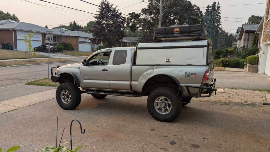

    if anyone is interested or was ever wondering what is the tallest rack or truck cap you can have to put a RTT on.. well I think I just made the max height, I would not dare go any higher than it is right now. Actually this will be just for camping and light wheeling nothing hard, its pretty high. From the ground to the top of the closed up tent is 8ft 3". :cheers:

    Love it, can not wait to see this unit on the trails

    Your going to need clearance lights now .

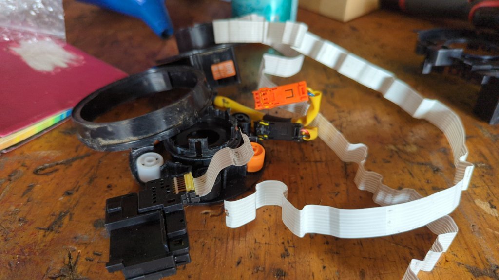

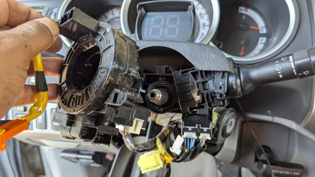

    Whatever happened to the days of when your horn didn't work, you changed the fuse or a broken wire or a broken horn. Now it's a thing behind the steering wheel. Well at least I have a horn now.
    I wanted to see exactly what went wrong and it looks like the ribbon part came off of the connector part. Oopsie. Did I do that.... Lol.

    Assuming didn’t lock the steering wheel when hooking up the Toyota steering box. Clock spring is a pain.

    yep next time I'l lock that steering wheel now I'm thinking my cruze will not work but I'll have to try it out and see. I have no speedo so if the cruze reads the speedo then I am right footing it..
