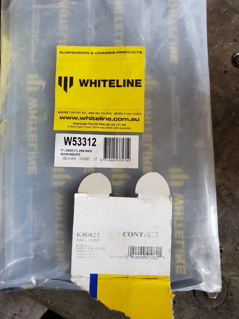

    '14 Acess Cab
    Well white line bushings and greasable lbj s
    Let's see how long these will last.
    I did not get 24 months with the mevotech lca s
    More stuff to do.....
    Will I do whiteline bushings again...... let's see how long they will last. Short answer no.
    Just better to buy complete control arms. Easier.
    I'm learning that I should budget 1 to 2k a year for parts.
    I think I'm over think I'm about 1800 to 2k forn2021.

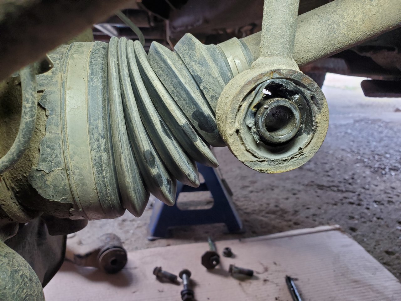

    Just.so I remember what I put on there
    llamasmurf likes this.

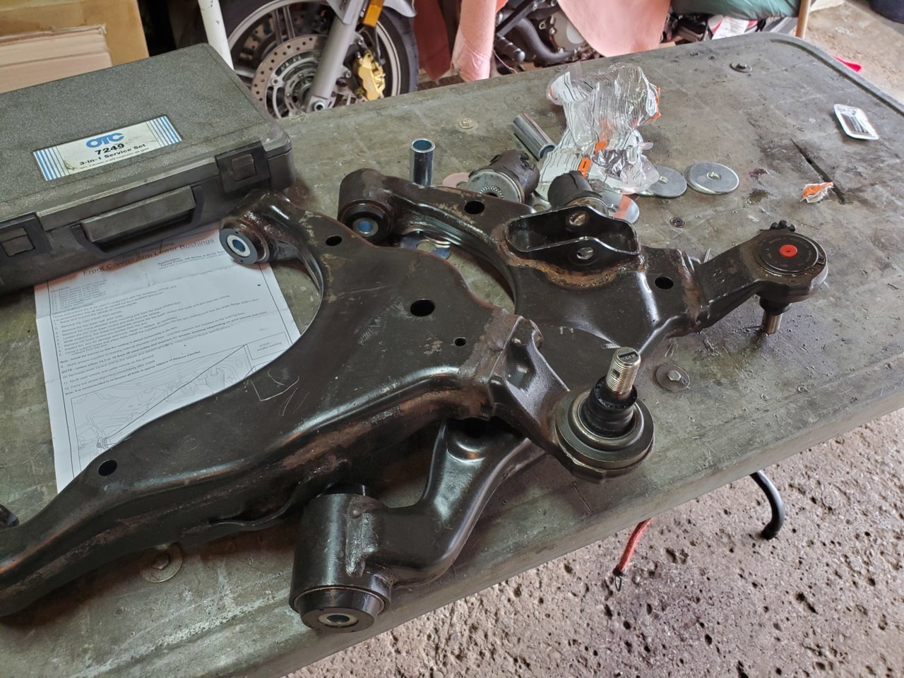

    5100 adjustable front lower bushings.

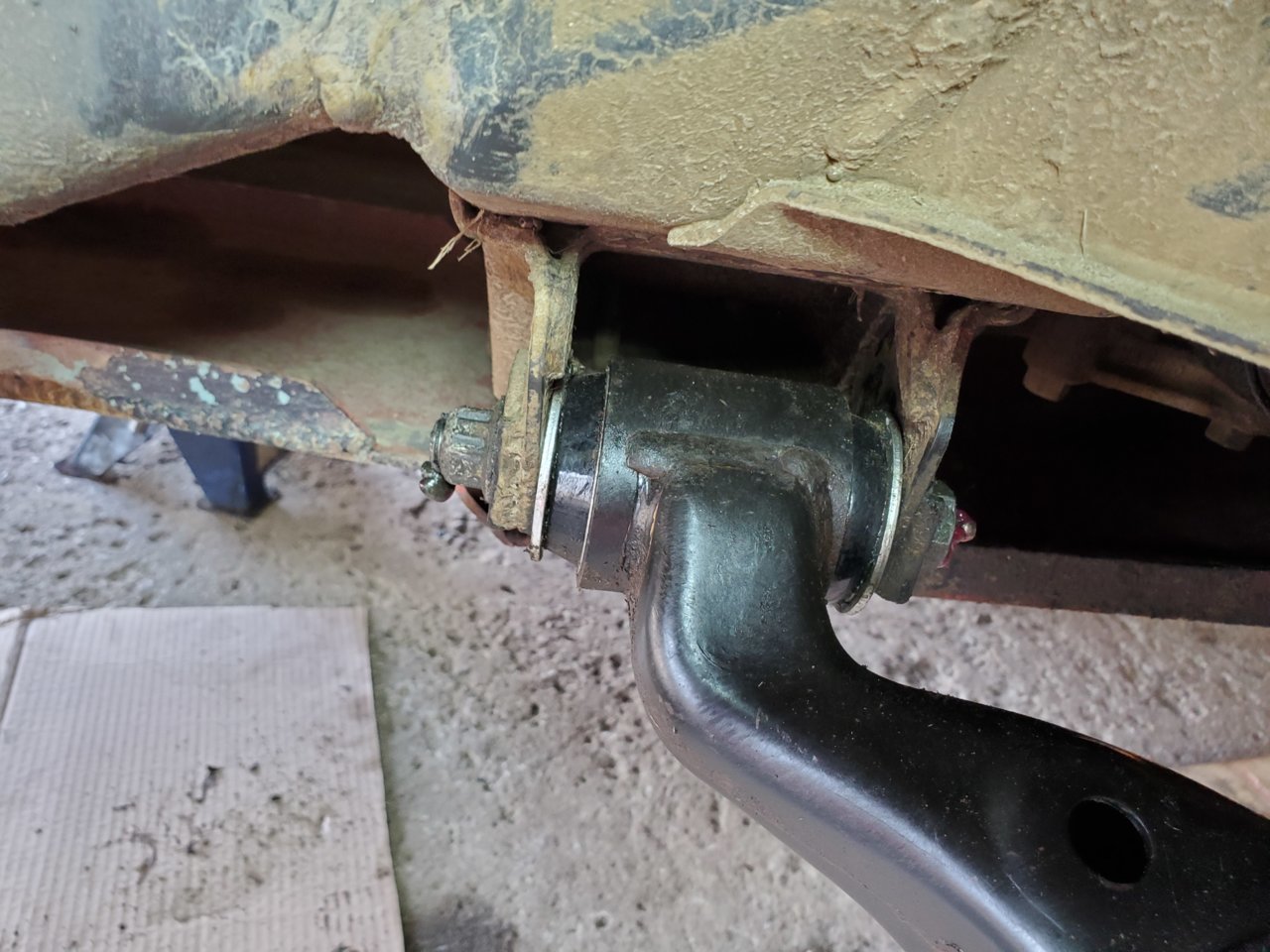

    Let me just talk about today.
    1. Putting the bushings in I used a princess auto press.
    2. The sleeves can go in with a hammer, easy
    3. The bushings come with 4 sleeves of one size and 2 bigger in I.d.
    4. There is a sleeve in the original bushings that go into the bigger sleeve so the bolt will fit snug.
    5. I did not do that.
    6. I installed the 4 sleeves into the bushings and drilled out the 2 front ones, to fit the bigger bolt.
    7. It was a nightmare to get bision cams back to the location I had them.
    8. Another person would have helped.
    9. Reason being there stiff...
    As for the lbj's grease fittings go in after everything in installed.
    Time will tell if these upgrades are worth it
    Total parts were roughly 110 for lbj 's
    And 150 for the whiteline bushings

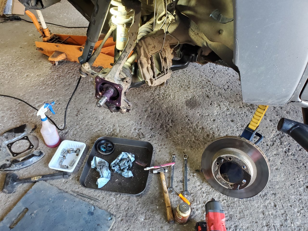

    Couple.of more things left to do.
    One was a lf bearing.

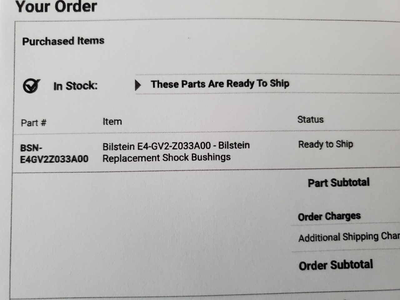

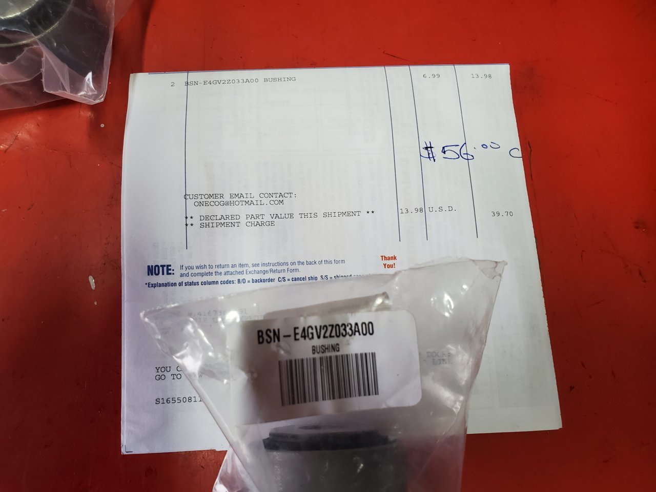

    5100 lower shock bushings cam in.
    Just for future reference....

    So thoes bushings are the wrong ones.
    I'd 14mm is same but od is wrong

    after an hour on the net...... the bushing for 5100 shocks for 2nd gen tacoma's don't exhist. well they do and only bilstien know's where to get them and and there not selling any. for 1st gen tacoma you can get them but there to small for the 2nd gen

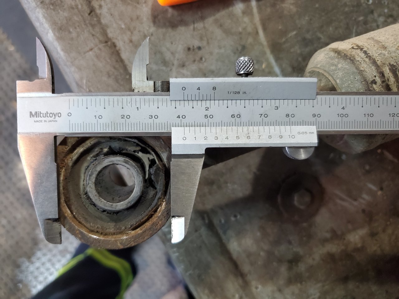

    Windigo [OP] Well-Known Member
    Dec 21, 2019
    #313884
    4,100
    Farook
    Toronto Ontario Canada

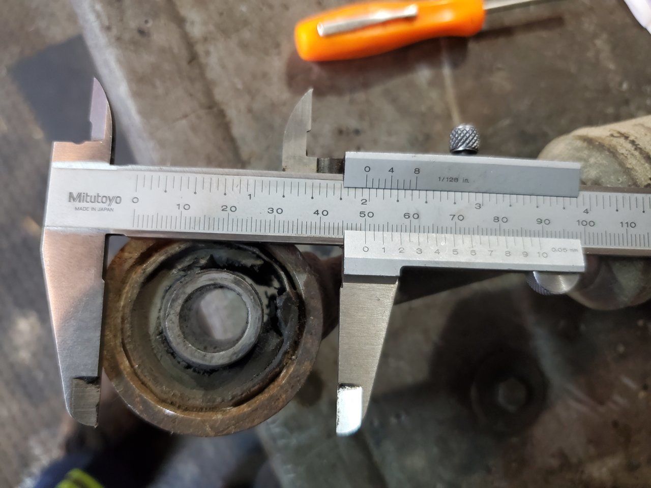

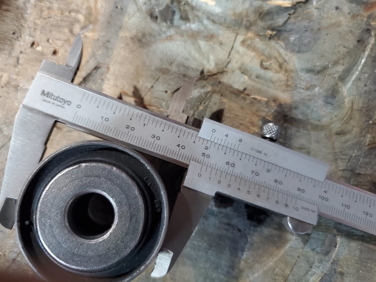

    '14 Acess Cab
    I rally dont see why a 1 5/8th shock bushing cant work hear...
    no one makes one thats why...lol.
    so the bushing is 41mm width
    thats 1.614"
    thats 1 39/64th
    thats 4.1cm
