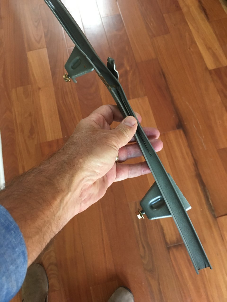

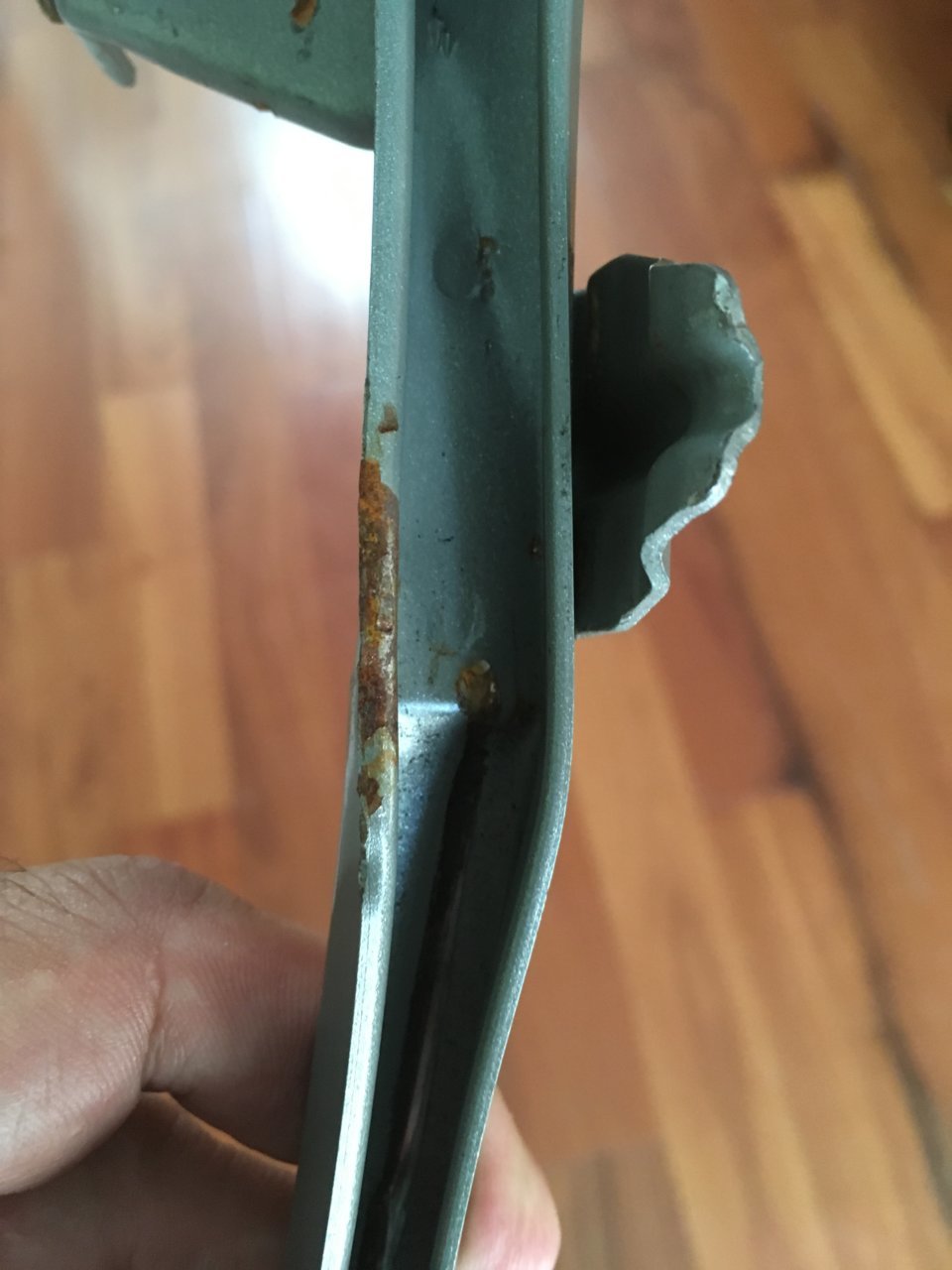

    How did that happen?

    40 mph wind ripped my door out of my hand. I saw a thread where dudes were able to straighten them but mine is too far gone...

    Anyone know whats involved?

    Yes you have to take the window out. Two 10mm bolts hold the wi dow in place. When taking the window out pull it out from the outside of the door. No need to pull the regulator.

    The channel is hold in by two more 10mm bolts. Should be a breeze.
    I just had to do the same thing to my truck. Btw i do glass for a living. If you have anymore questions shoot me a pm

    Window has two bolts on the bottom. I assume I just remove the weatherstripping and out she goes?

    Yes sir you are correct. Also use some wd40 when you reinsert the weather stripping makes it alittle easier to put back in.

    Same happened to me. Twice. The first time I made a comprehensive claim because the door limiter was bent too. The windshield repairman is replacing my windshield in front of my house as we speak for a different problem, but he took the part out without taking the window out You don't need to. Just put the window in the up position. take the door panel off. The bent part is held by two 10mm bolts. you pull the rubber track out of the part. When you put the new part in, take the door speaker out (4 more 10mm bolts), and you have room to work with to put the new part in. Then stuff the rubber track back in (the rubber track runs through both the upper and the lower track). Make sure it works. Reassemble the door panel. Now my question is, is this the correct part number for my vehicle (2006 Tacoma TRD Sport access cab), driver's door:
    67402-04030

    Thank you so much @novataco for the advice, was able to get the existing window track out without taking out the window. FYI if you are looking for a passenger side track because your wife let 'er rip during a wind storm, it's PN: 67401-04030.
