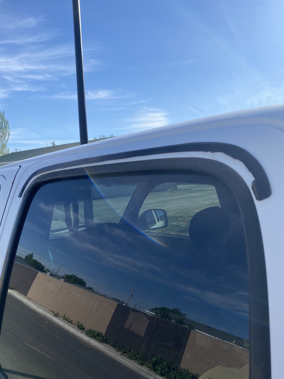

    Hello, I had on some window deflectors and they had been ripped off, any advice on how to take the adhesive off without pealing the paint? Thanks in advance.

    Kwikvette Fabricobbler
    Feb 27, 2019
    #284735
    64,100
    Stock
    Goo gone and goof off work pretty well.

    Heat and goo gone or wd40. I have a plastic razor blade I use as well.

    I third this, however it will take time. I spent a good couple of hours spraying and rubbing to get my 15 year old adhesive off.
    I now have "in-channel" ones
    edit: leave it in the sun to warm up and use a plastic razor or putty blade to get under it. you will still need to use the spray but can get some off if it's pliable

    Heat gun and a plastic scraper, then goo gone to get the residual off

    You cannot really get the adhesive off with Goo Gone if the that black stuff is in the way. First task is to remove as much of the black stuff as you can.
    Heat Gun, or a blow dryer on high will soften the adhesive. Give it time to work, section by section, peel the black stuff away if you can, plastic scraper if necessary.
    For the remaining adhesive residue, use GooGone on a Mr. Clean Magic Eraser.

    Some good advice here on using heat then an adhesive remover. I caution against some of the recommendations, though.
    Please don't use Goof Off. It is a little too strong for car paint and can make a mess.
    https://www.autogeekonline.net/forum/off-topic/63304-goof-off-will-ruin-your-paint.html
    Also, I'd avoid the Magic Erasers, too. They are a lot more abrasive than you realize.
    https://www.detailedimage.com/Ask-a-Pro/can-you-use-a-magic-eraser-on-paint/

    Goof Off: Do Not Use
    Goo Gone: Yes
