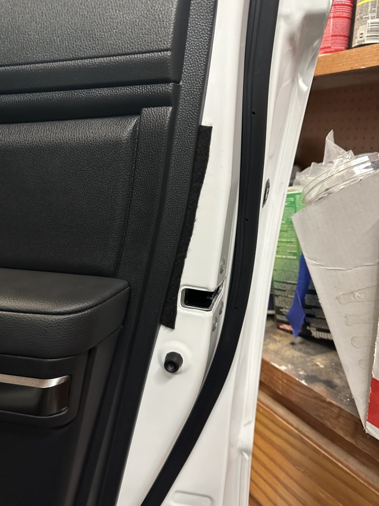

    I was wrong about that location but I did find the right one. Ended up using some cloth pipe insulation wrap and cut it to about 2 inch wide by 6 inch long. Used some plastic trim tools & wedged it here in the picture. Bass rattle gone for good, took me forever to find the right spot since from the driver’s side you can’t tell where it’s coming from. If you push on the right side of that trim piece that says “TRD” and the rattle stops, then this will fix your rattle. upload_2024-9-18_7-18-36.jpg

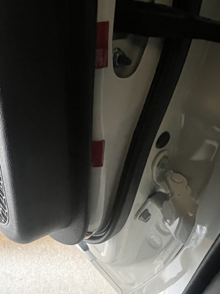

    yes, the consistently reported rattles are door related and I fixed it with 3M tape (but it’s on the inside not the outside and it’s my back door - is your front door?) I’ve got a thread about it here, but I’ll post a picture below. The other “rattle” I discovered was just the bed extender hopping up and down on rough roads and speed bumps - I’m selling it first chance I get because the dealer shoved it onto me and I never use them. IMG_5090.jpg

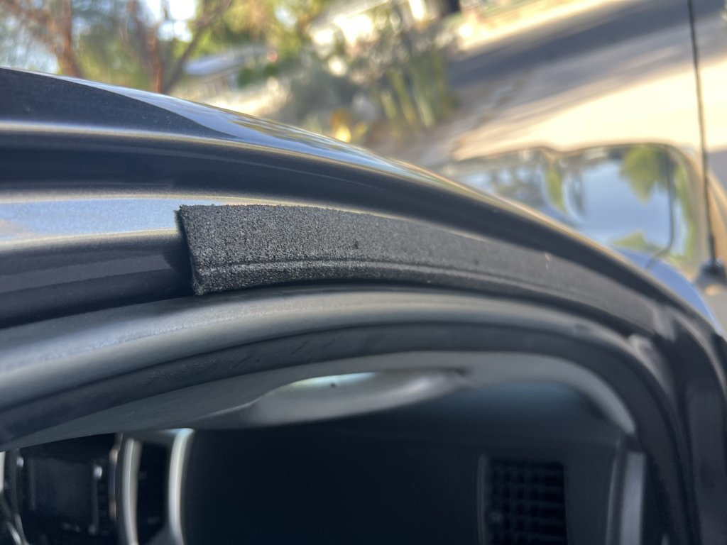

    I have a 2015 Tacoma. I found at highway speeds (and typically only when there was a crosswind) my driver's side window or door frame made this loud whistling sound. It took me forever, but I finally figured out it was the door frame, and was able to fix it. I bought a roll of foam (with a sticky side) from Home Depot and ran it inside the door frame between the door and windshield. IMG_0395.jpg
