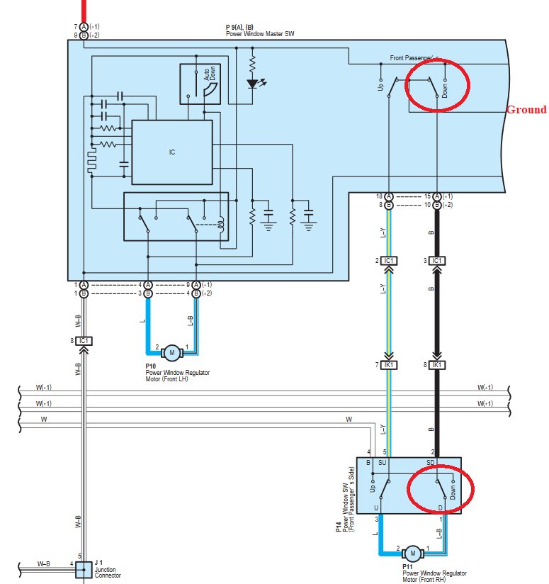

    I would check continuity of the Master Switch drivers door for the Front Passenger Window Switch Down Contact that goes to ground connection and the same for the Down Contact for the Passenger Door Controls. That is the common points between the Passenger Door Control Switch and the Drivers Door Master Switch for that window for the UP Command.
    If either one of these contacts are not closed the window will not go up because it is missing a complete path to ground.

    The motor is powered from 2 different sources.
    Each switch supplies power to the motor from a different and separate location.
    The only thing the 2 really have in common is the Switches switch.
    Power from both go through the Passenger Switch.
    (Driver Front P/W Fuse and Passenger Front P/W Fuse)
    I’d start with checking the Passenger Switch.
    Then the motor itself.
