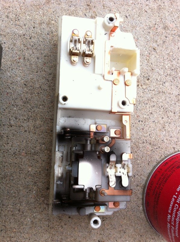

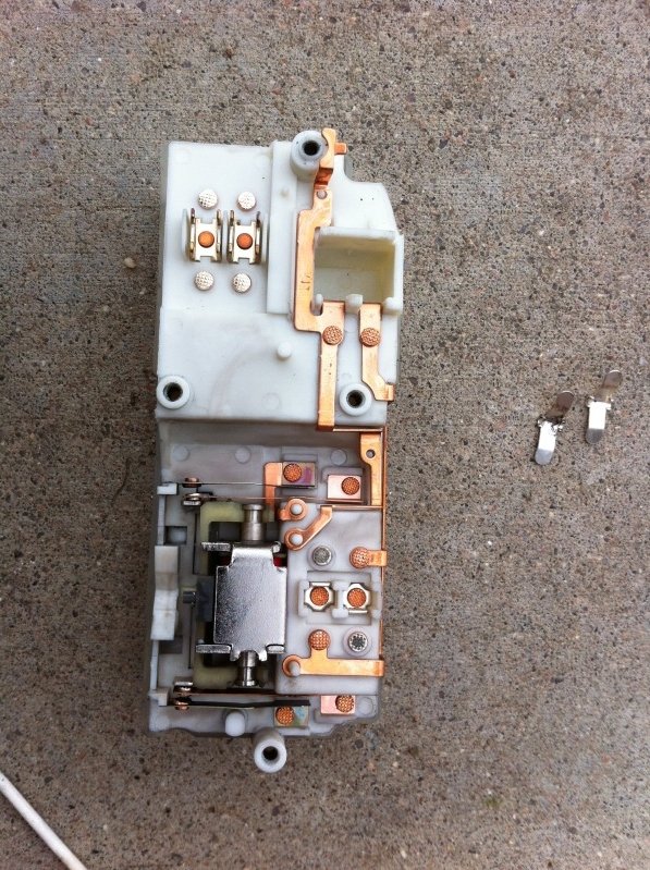

    Drivers side window switch gets the most use. Which means it gets the most carbon build up on the contacts. That build up causes the intermittent issues you are experiencing.
    Use electrical contact cleaner instead of compressed air. Should go back to normal operation.
    The dual plunger and two sets of double fins on the left is the drivers side switch. You can see how much more carbon build up is on it compared to the passenger side rocker switches.
