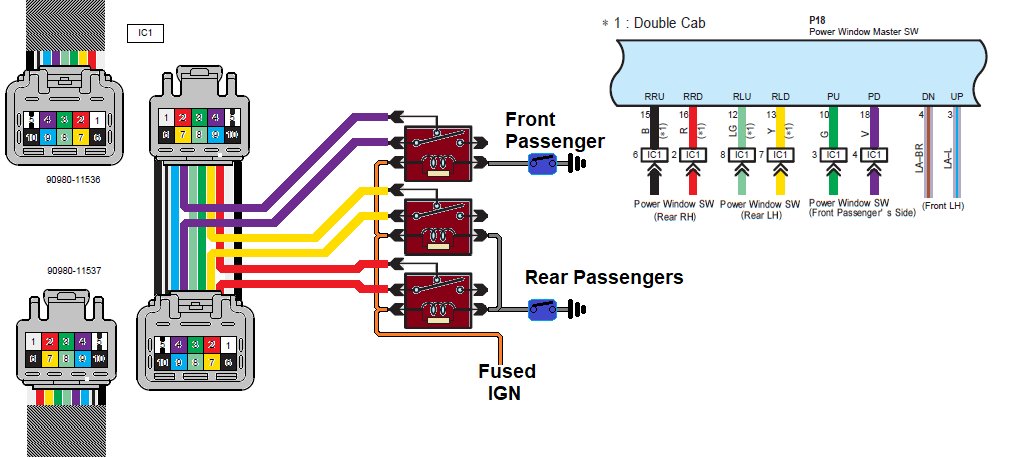

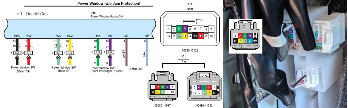

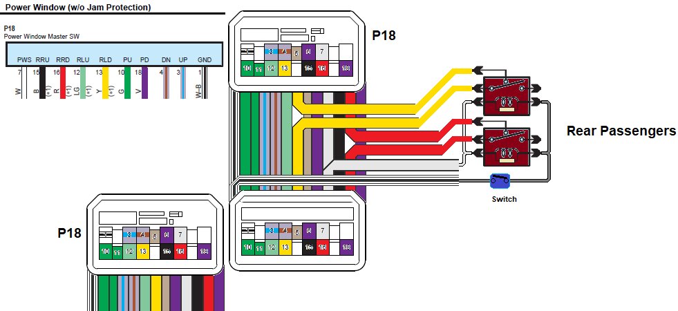

    You could assemble something like this:
    Intercept harness interrupts the window switch operation. The additional switches are what might break the deal.:burp:

    Interesting approach, but I'd prefer not having to add switches, if I can avoid it.
    I really can't understand the reasoning for disabling the driver's control, in the first place - it just doesn't make any sense, to me.
    Thanks for working that up, by the way!

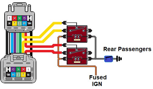

    If the kennel stays at the rear seats, it be only one added switch...
    Breknraj[OP] likes this.

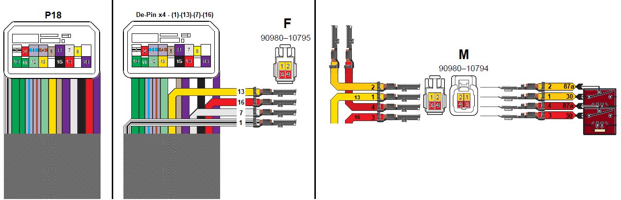

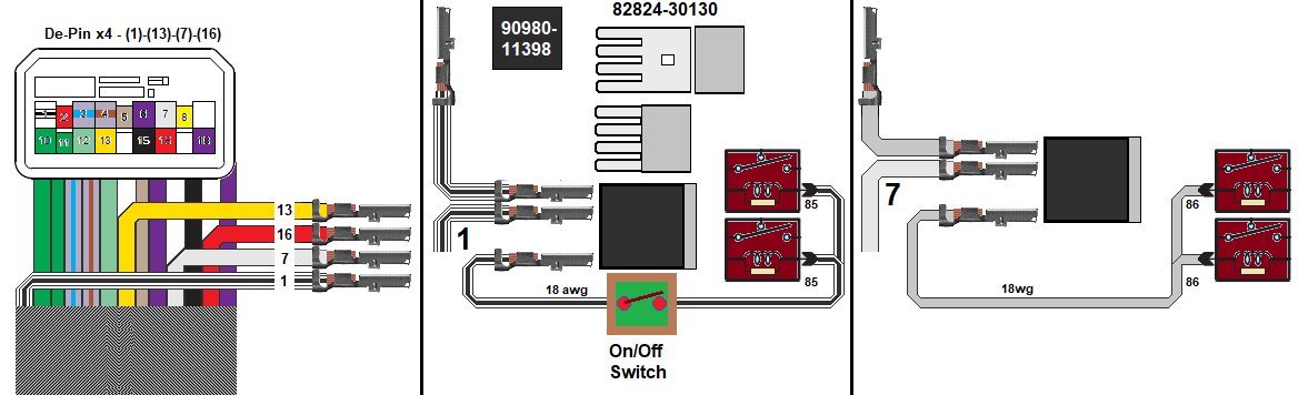

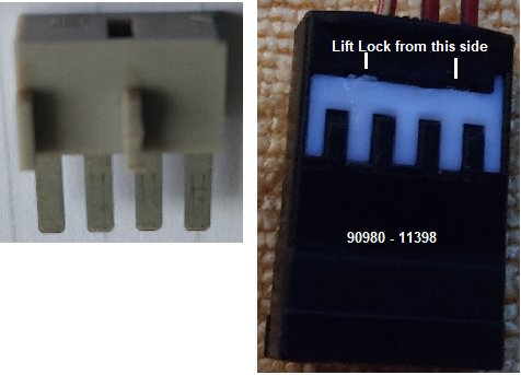

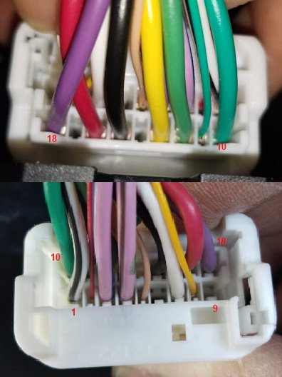

    Another iteration:
    Disconnect P18, de-pin the identified terminals, insert them into female connector (-10795)
    Crimp terminals to mating connector, measure length of location of added relays (plenty of room under door switch panel)
    This is ground and fused power to added relays. Small push button can be placed in door switch panel.
