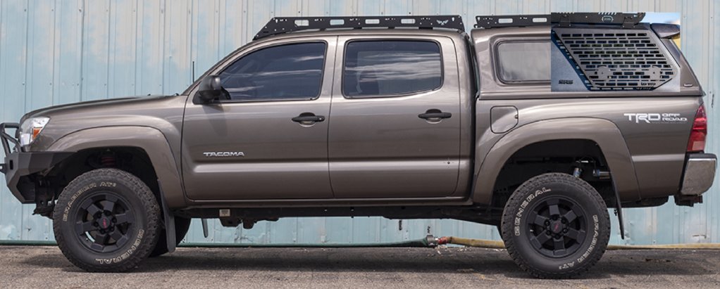

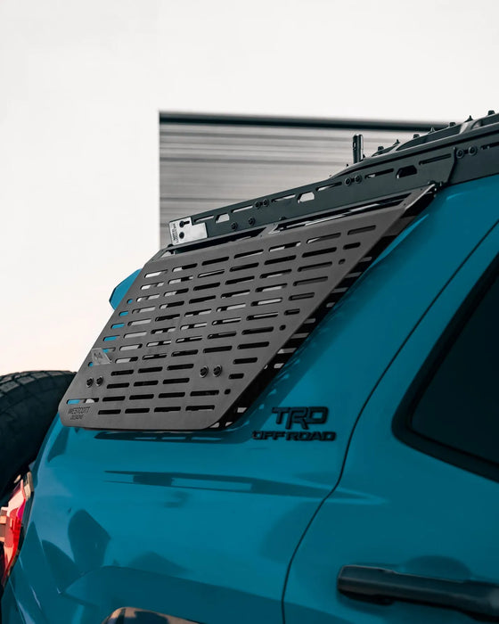

    Appreciate the response! Cover the glass, like the typical 4Runner or LC panels such as this one by Westcott Designs

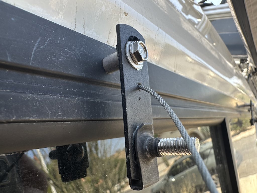

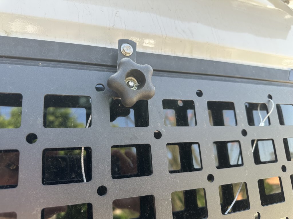

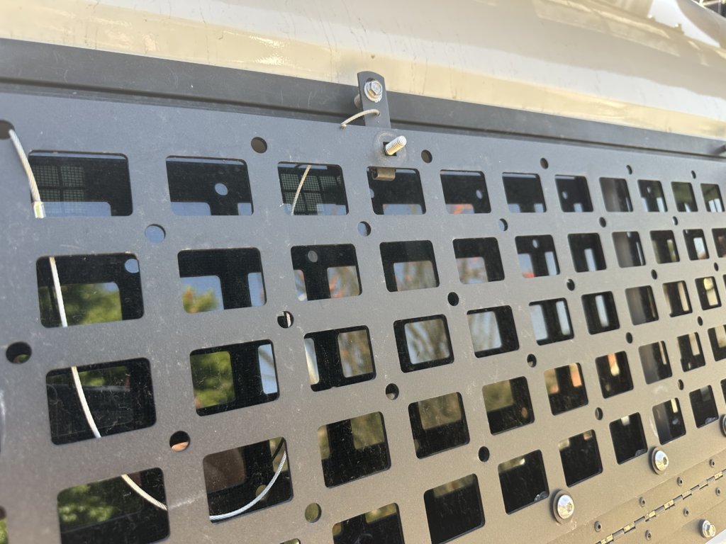

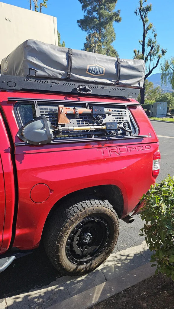

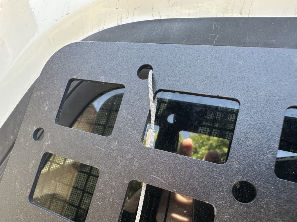

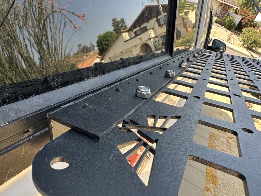

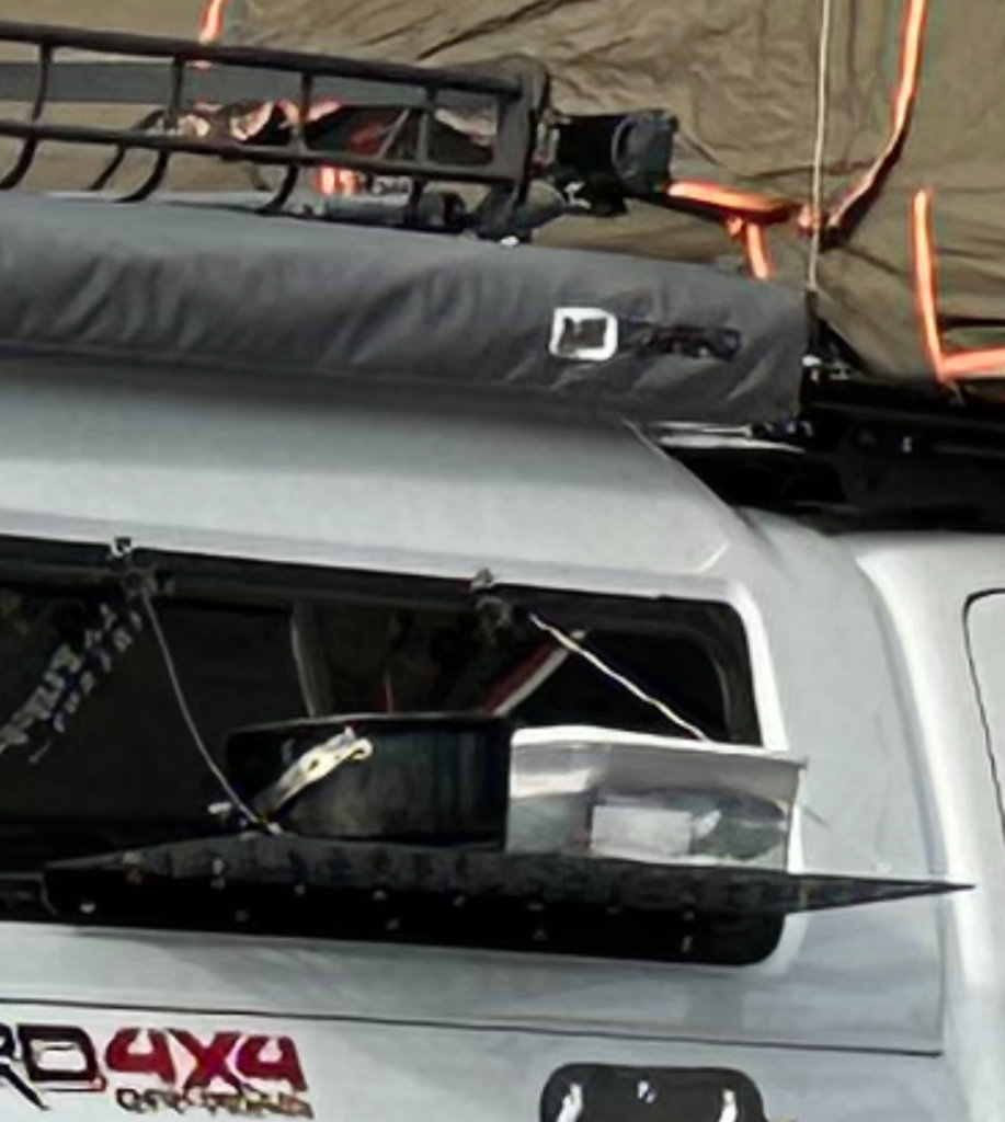

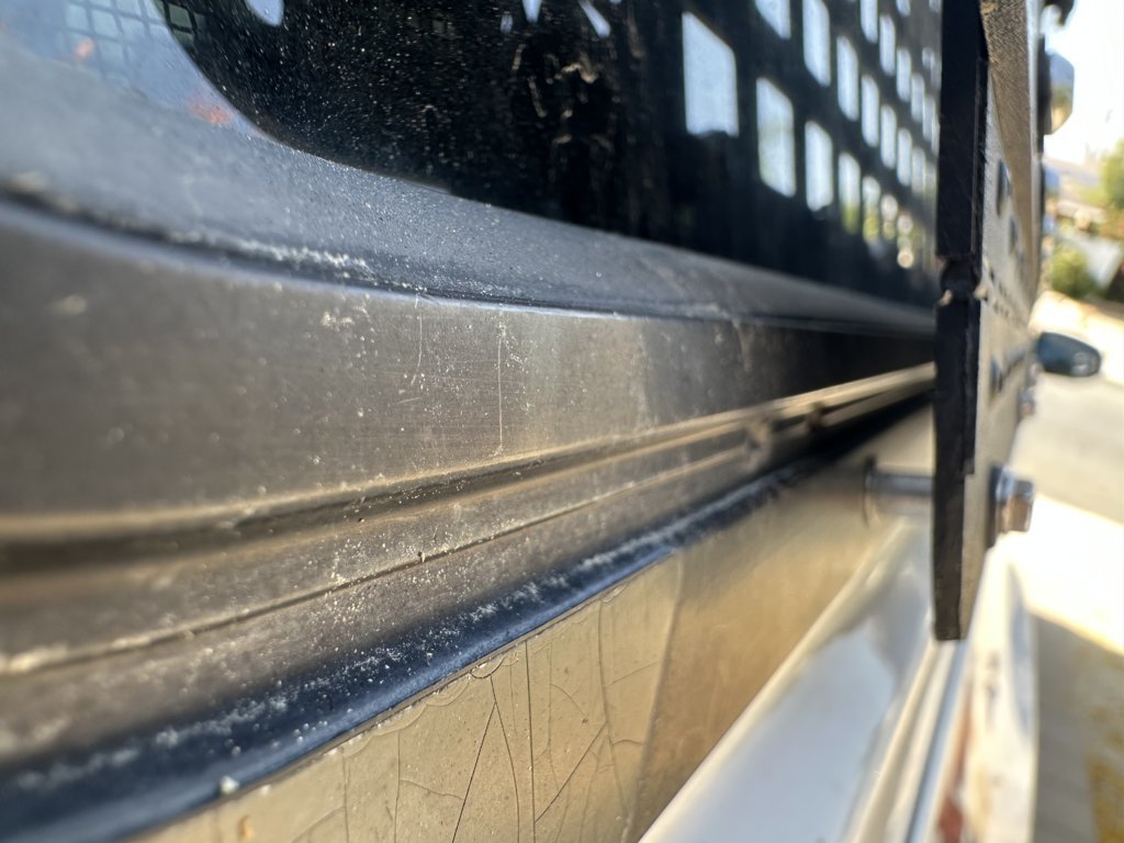

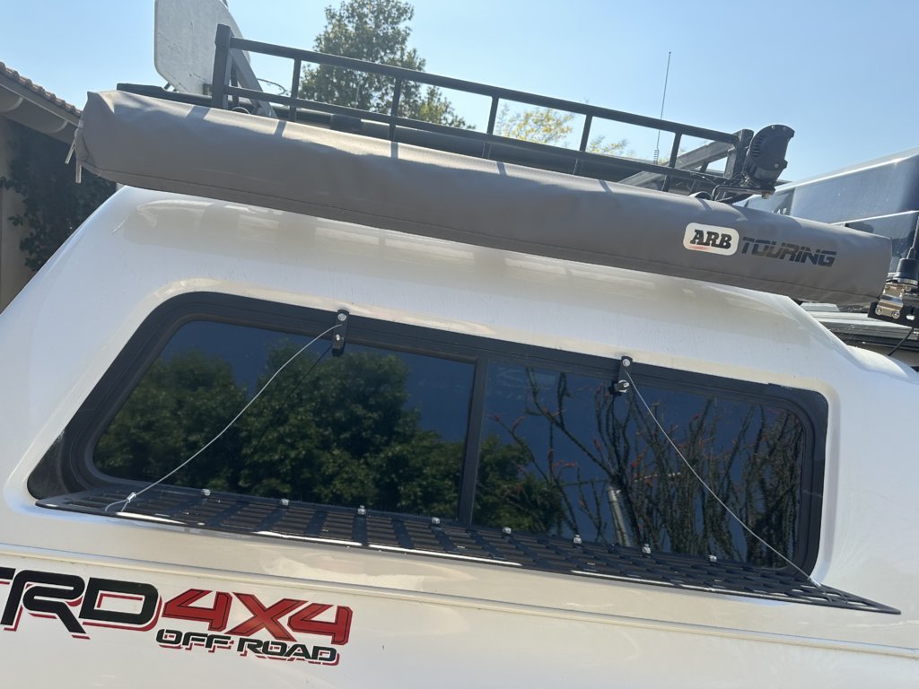

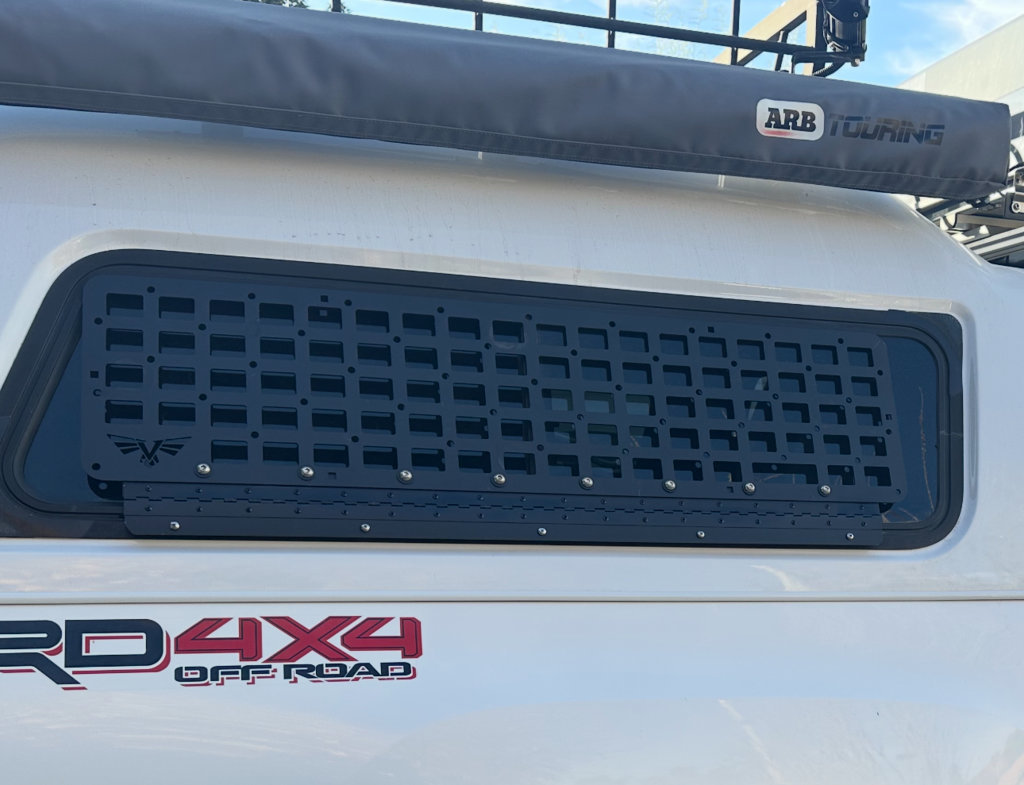

    You don’t have to drill holes in the fiberglass, I used the window frame. I made this as a folding shelf for my ARE MX shell (short bed) out of a @victory4x4 panel, it has a aluminum spacer bar (to get the top edge of the panel to lay over the upper part of the window frame) and a piano hinge across the bottom, with hand screws on top to hold it up (not shown here), and two light cable supports attached to it to hold it flat when open.
    the cable on the left looks loose but it’s just because the box on the right is heavy. There is some flex in the panel, but it holds a lot of weight, including a portable diesel heater for the RTT or my Jackery battery.
    The top and bottom frame mounting bolts have aluminum spacers to offset the panel from the window a bit:
    I used stainless pop rivets to attach both sides of the piano hinge onto the two spacer bars, and stainless bolts to hold the other end of the spacer bars, one to the panel and the other to the window frame.

    Thank you for the comment. Do keep in mind that I did drill holes in the aluminum window frame for this. They can easily be sealed up with caps if I ever take the thing off.
    if you don’t wanna drill any holes, you could easily do it with bars coming down from the Prinsu, in the bottom of those bars can be attached to a cross brace that is glued to the window.I did the same thing on the other side of my truck to mount a retractable solar panel on the side. You can glue a flat aluminum bar with silicone glue directly to the glass and mount The bottom part of your mole panel mount onto that. I’ll post some photos how I did it later today.
