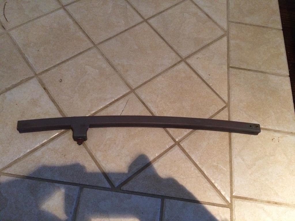

    Hi Everyone,
    I just bought my second Tacoma (the frame had rotted out on my initial one). Anyway the drivers side window was rolling up and down at an angle. I pulled the door panel off and found the forward window guide laying at the bottom of the door. I didn't find any hardware and have no idea how it mounts back to the door. Help?

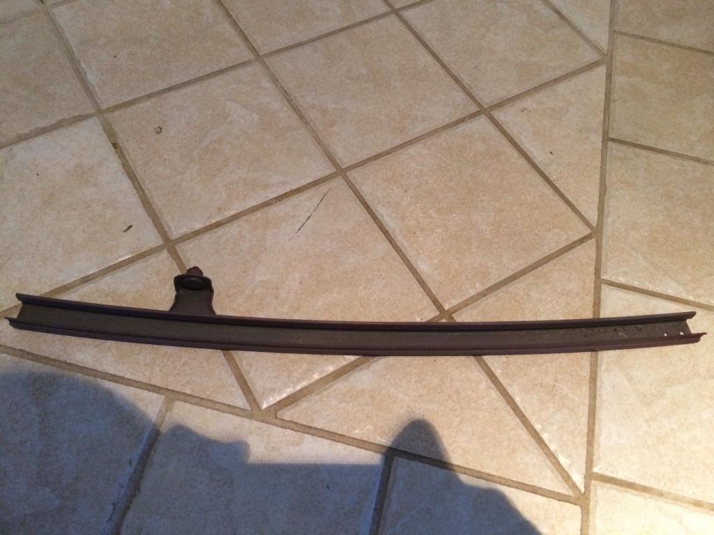

    I just figured atleast 1 part out... The holes visible on the guide were spot welded at the factory and the bracket broke away from the guide. As far the visible nut, I am wondering if pulled through the door. Thoughts?

    Answering my own questions to help others... The top bolt does indeed go through the door. My buddy is going to attempt to reweld the bracket back on for me and I am going to install a slightly larger washer.
    I believe a new one is $35 for that one guide...
