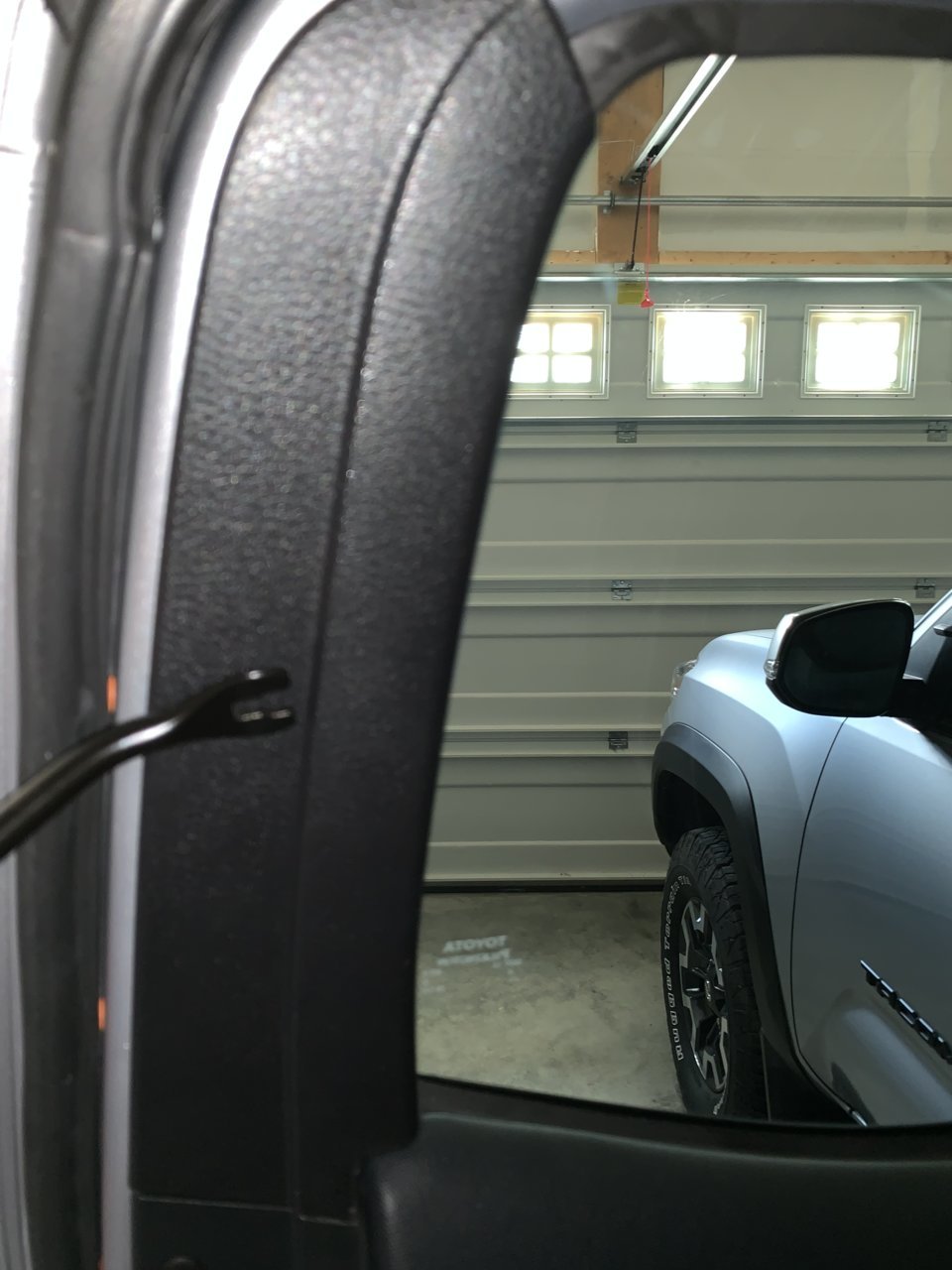

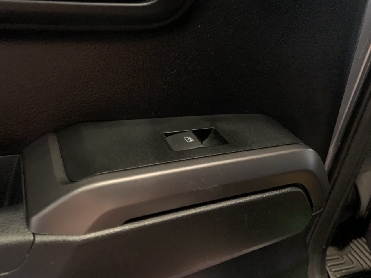

    Step 2: Removal of the top left plastic trim

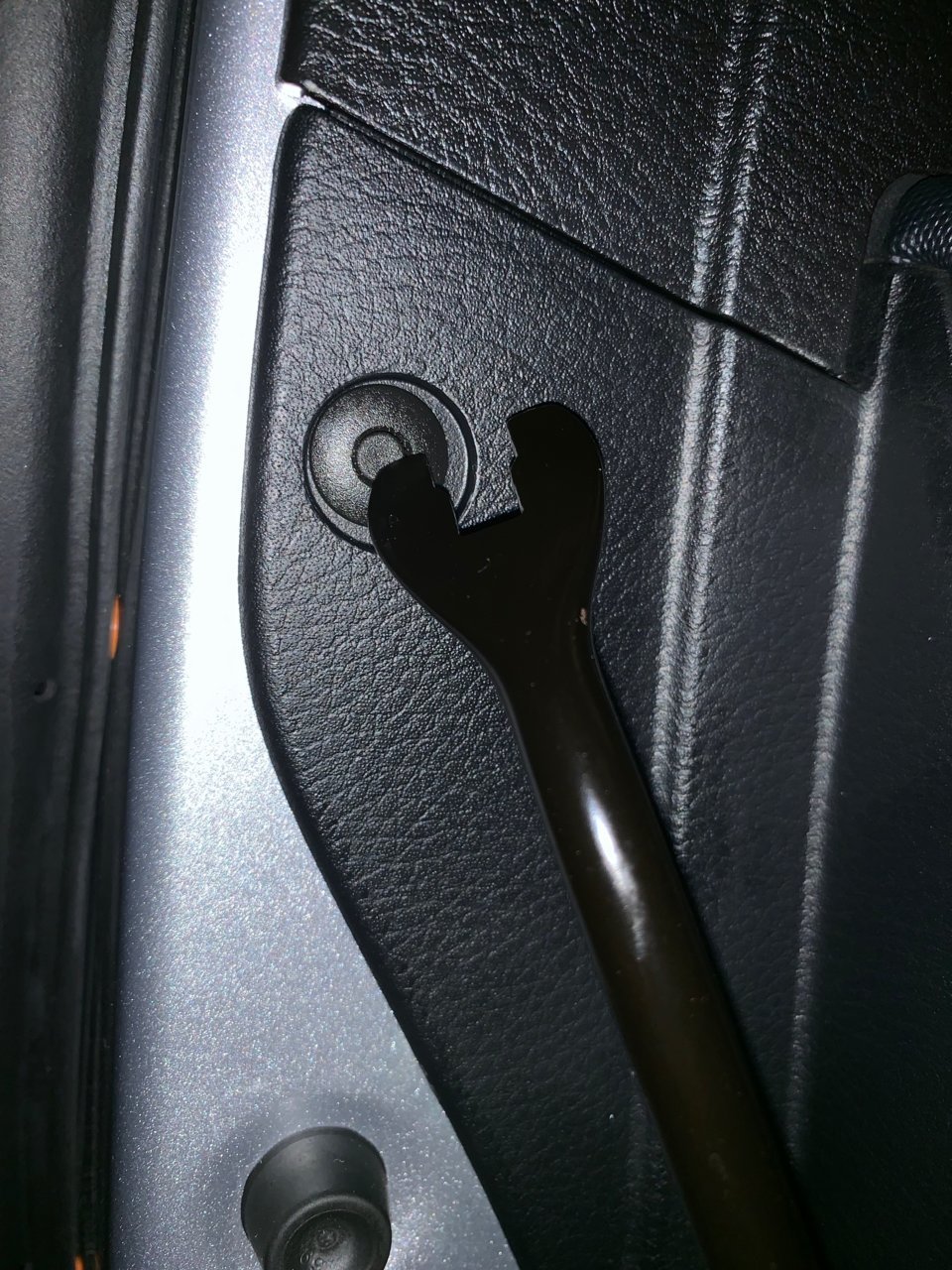

    Next Remove the Plastic push clip by depressing the center of the clip then removing

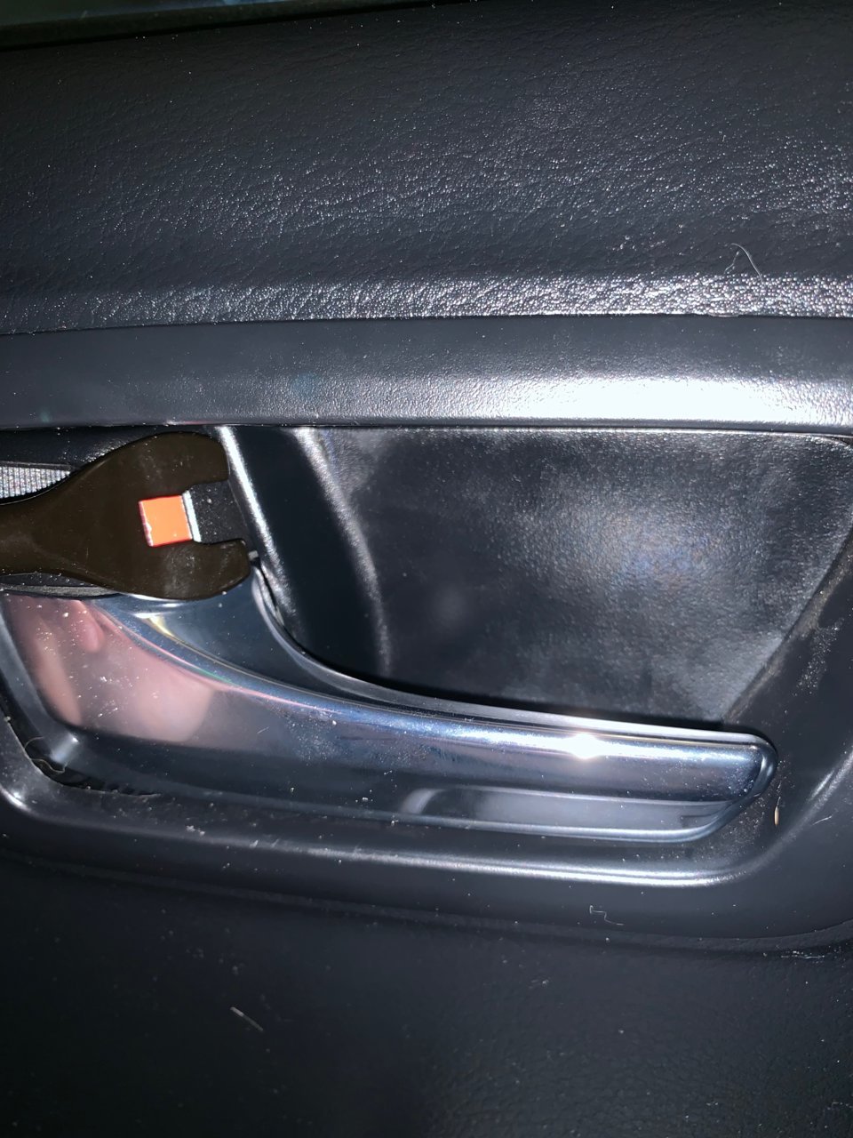

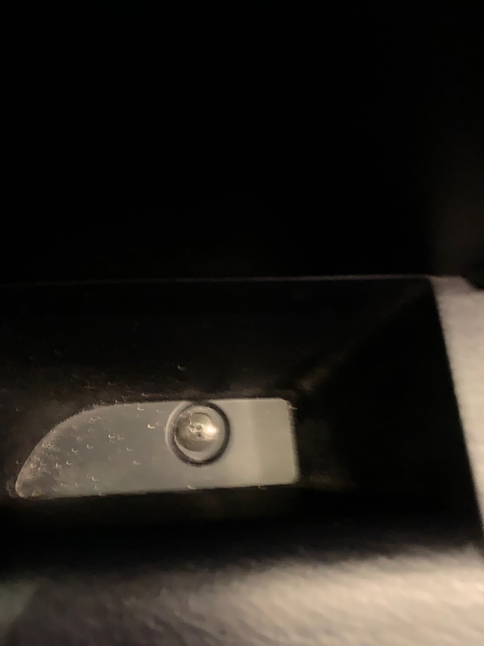

    Now remove the plastic cover behind the door handle using your door panel pryer and use a Phillips screw diver to remove the screw.
    Now its remove the felt piece and the screw underneath

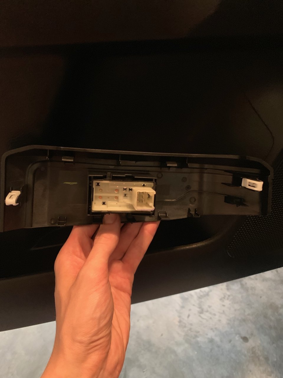

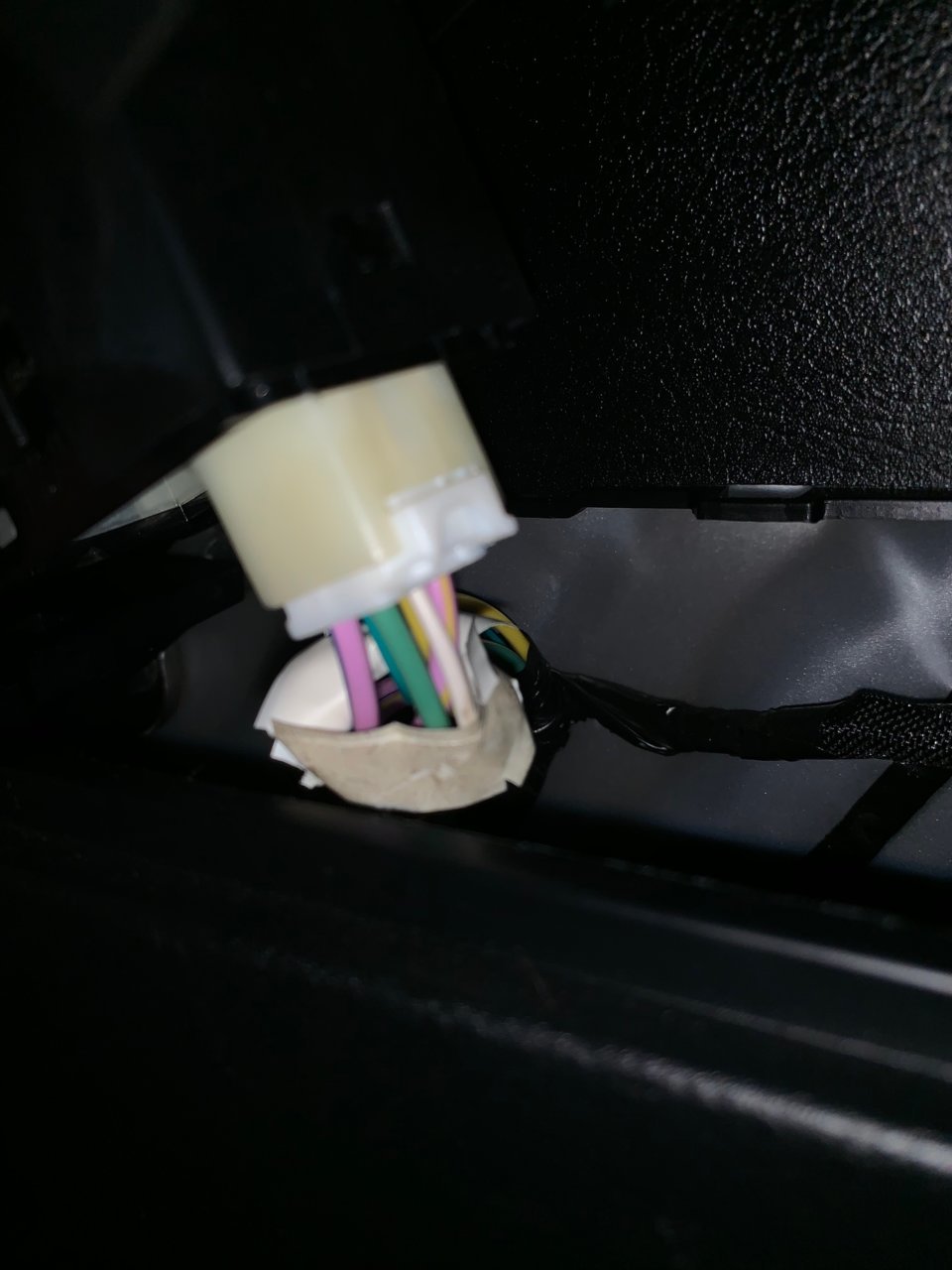

    Part 3: Removing the window control panel, simply pry up and unclip the connector. If the white plastic clips remain in the door card remove and place back on the windows control panel.

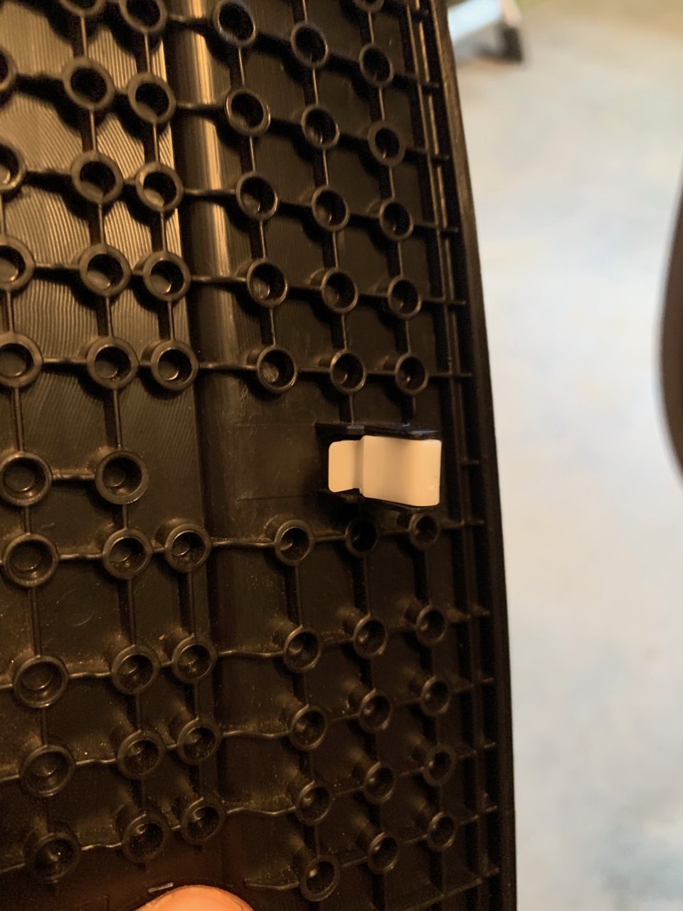

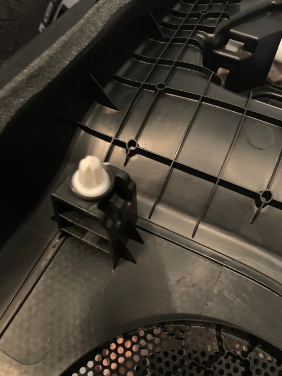

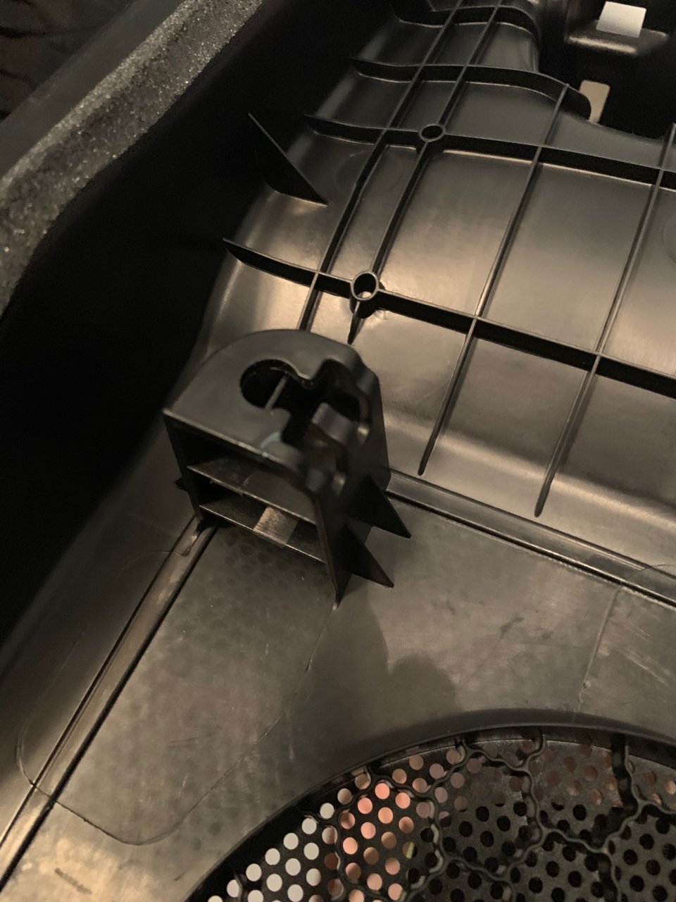

    : Now it's time to pry off the door card. There are a total of 8 plastic clips holding the door card in place. Once the door card is no longer held in place by the 8 plastic clips undo the door lock mechanism. Now that the door card is free remove any of the 8 white plastic clips and return to the door card.
    Below are pictures of the white clips and what they look like installed back on the door card. You will need to do this for the door card to clip back in place.

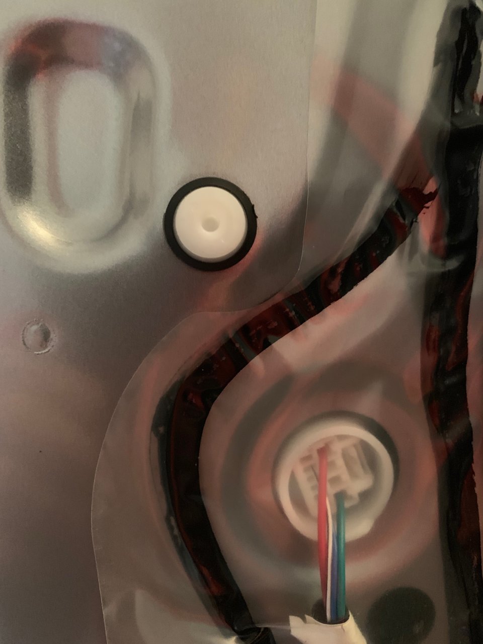

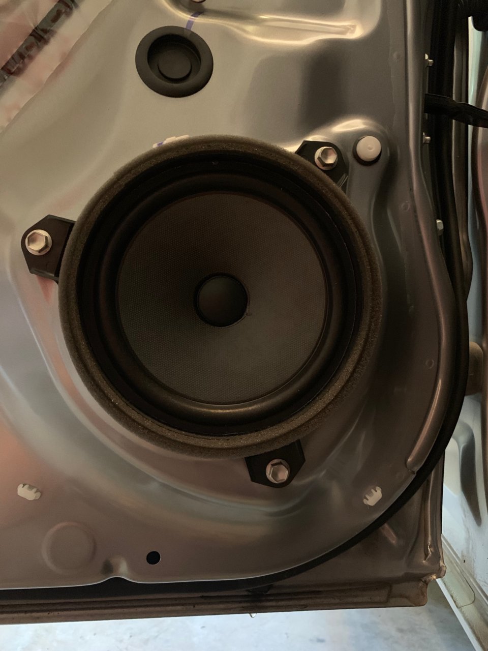

    Step 5: Removing the speaker first unclip the connector and then remove the three bolts using a 10mm socket.

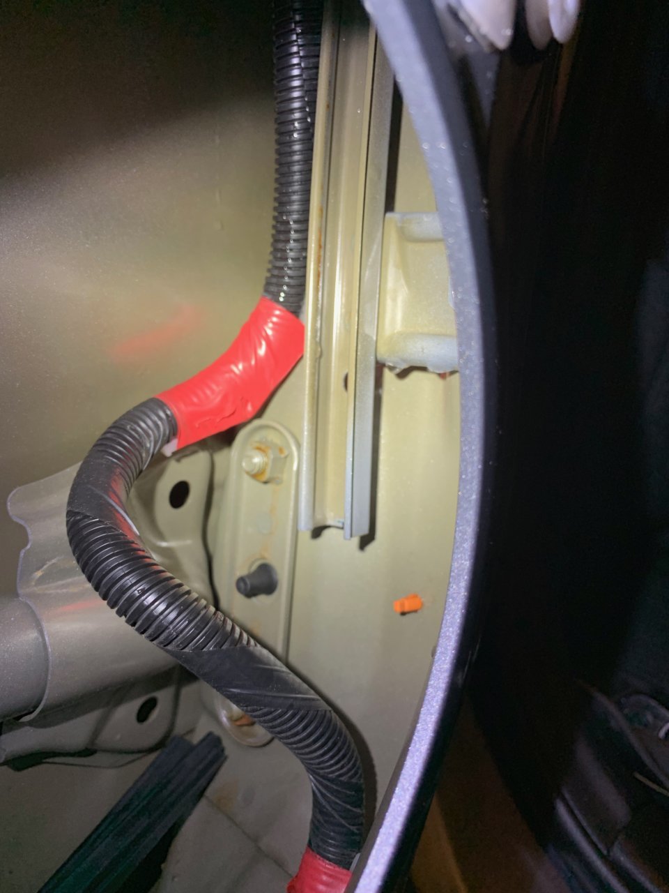

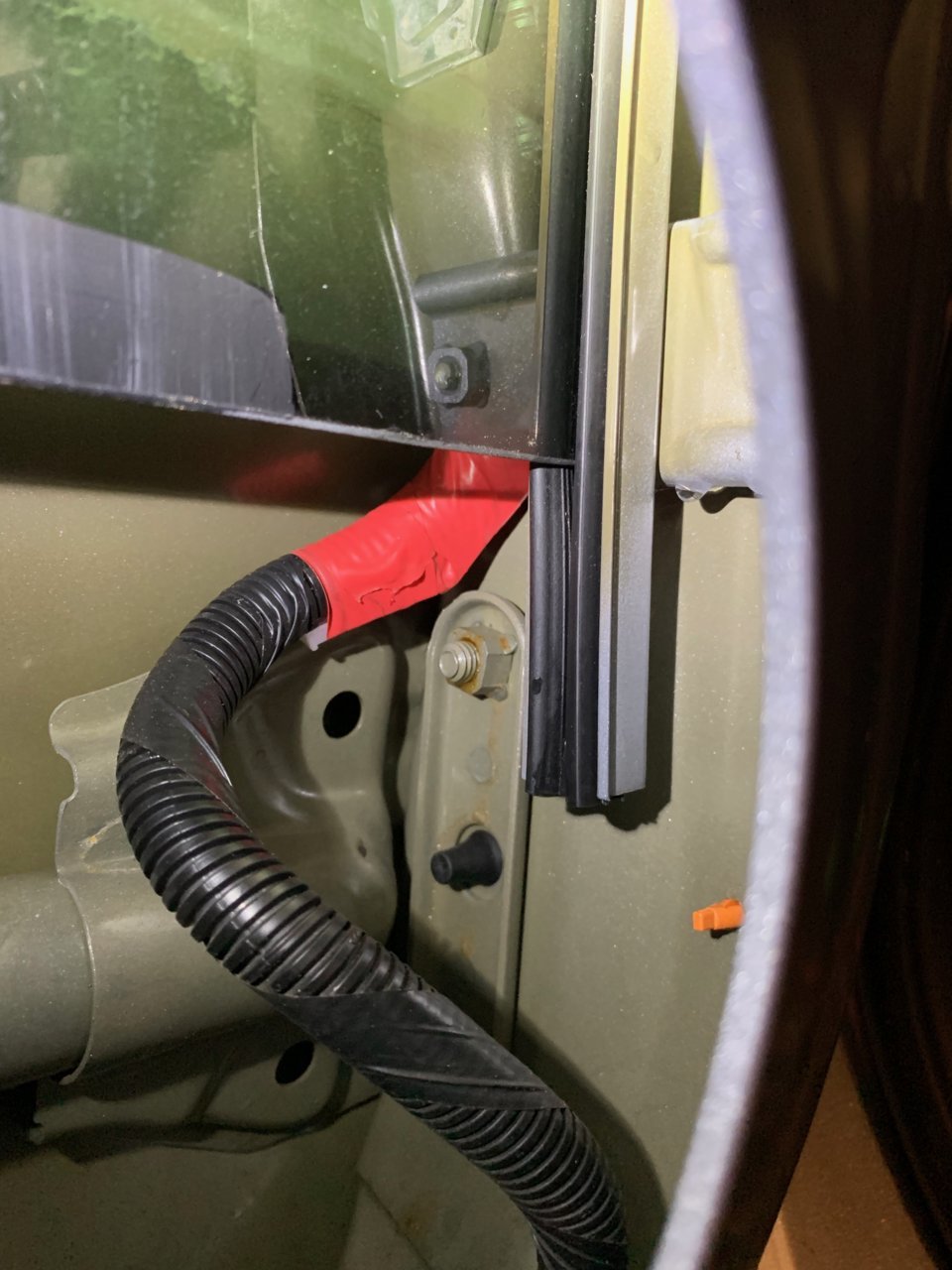

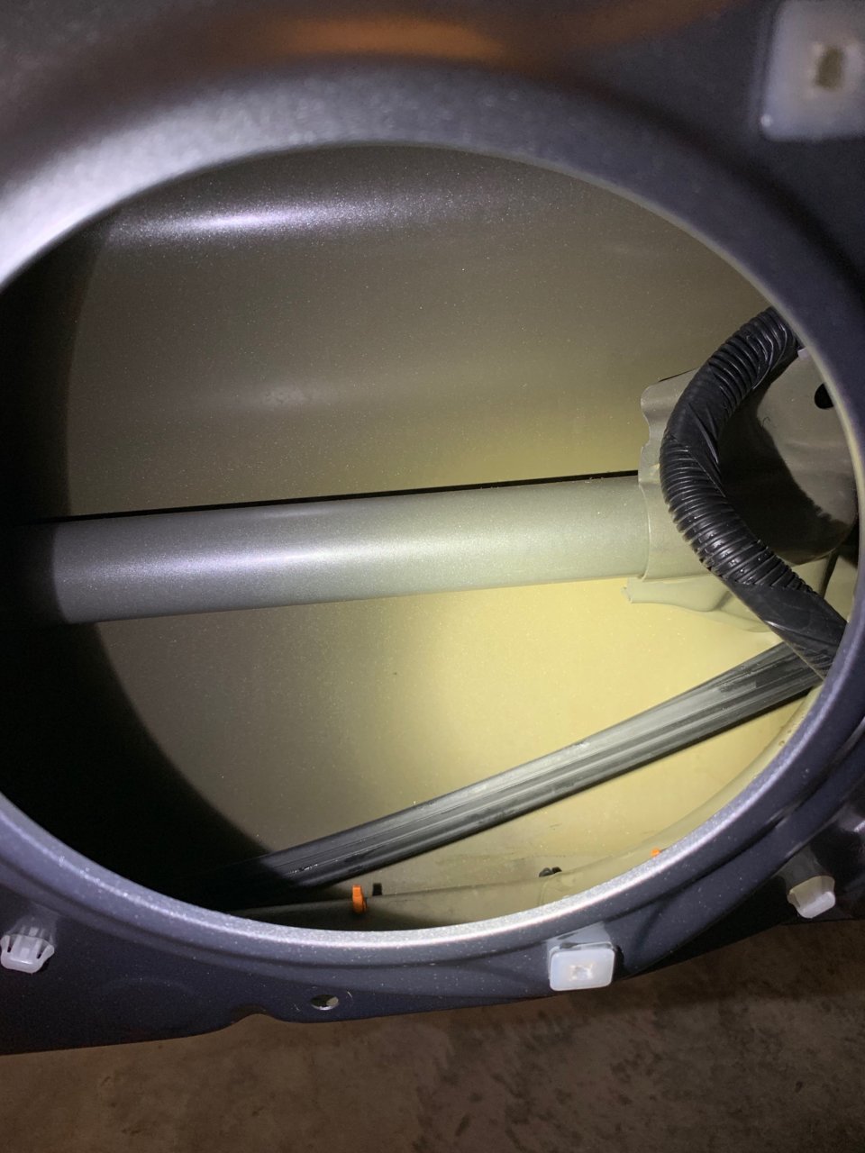

    Step 6: After removal of the speaker I noticed something odd. There was a piece of what looked like black rubber molding laying at the bottom of the door not attached to anything. Then looking over at the window tract there was a metal channel that looked like it would perfectly fit the weather stripping located at the bottom of my door. Wouldn't you know it fit perfectly.
    Step 7: Let's see if this worked and the window fit perfectly.
