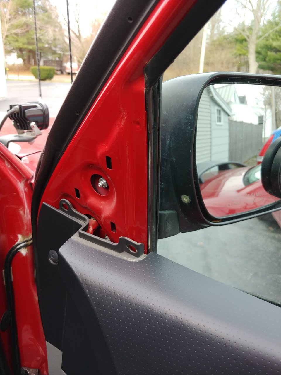

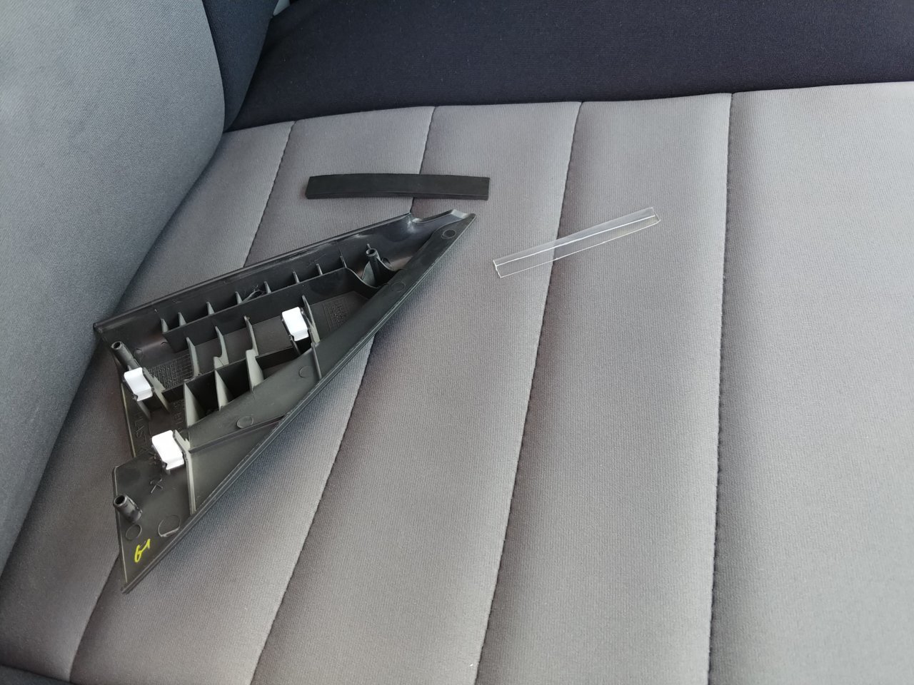

    Yes, sorry I should have been more specific. I shimmed it until the window struggled to raise/lower and then backed off on the shim thickness until it moved freely. It solved the rattle. Not the most technologically advanced solution, but it worked.

    Seems to have. Wont really know for sure until I get back onto some rough roads. But yeah I cant make it rattle any more by just grabbing the glass like I could before I shimmed
    Only need to take the triangle piece off. Not the whole door trim like I did. Three clips no problem

    Pro tip...
    Those little white clips must be on the plastic triangle when reinstalling. If they are stuck in the door after removal, pull them out and place them on the plastic triangle piece. May be common knowledge.... may not.

    Thanks for the pic. Is removal as simple as prying the triangle piece off?

    Yes.....but before replacing triangle piece, reference Halligan's post above yours about how to put it back on.

    Yes good point.
