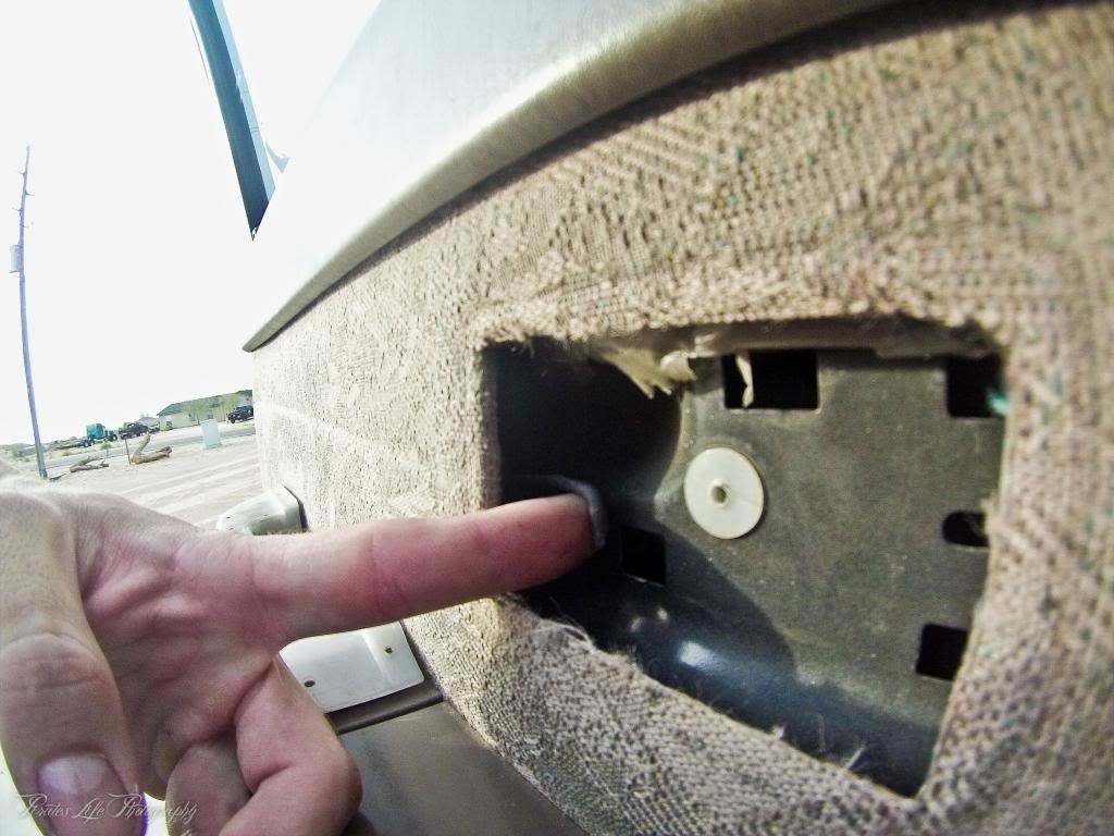

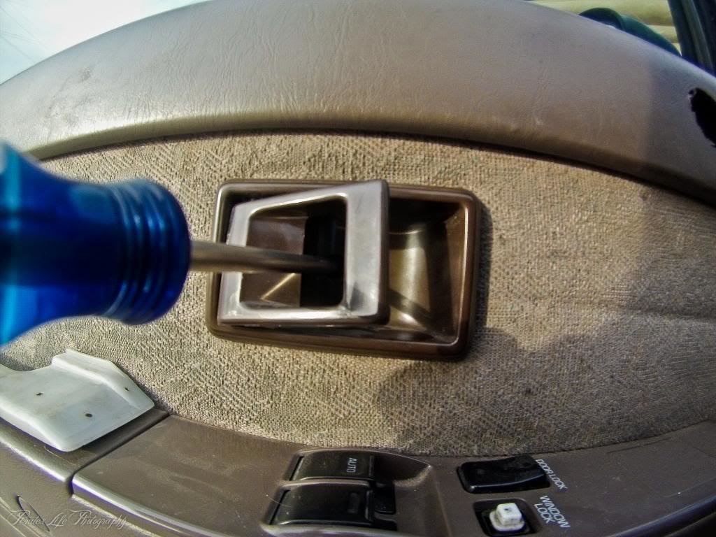

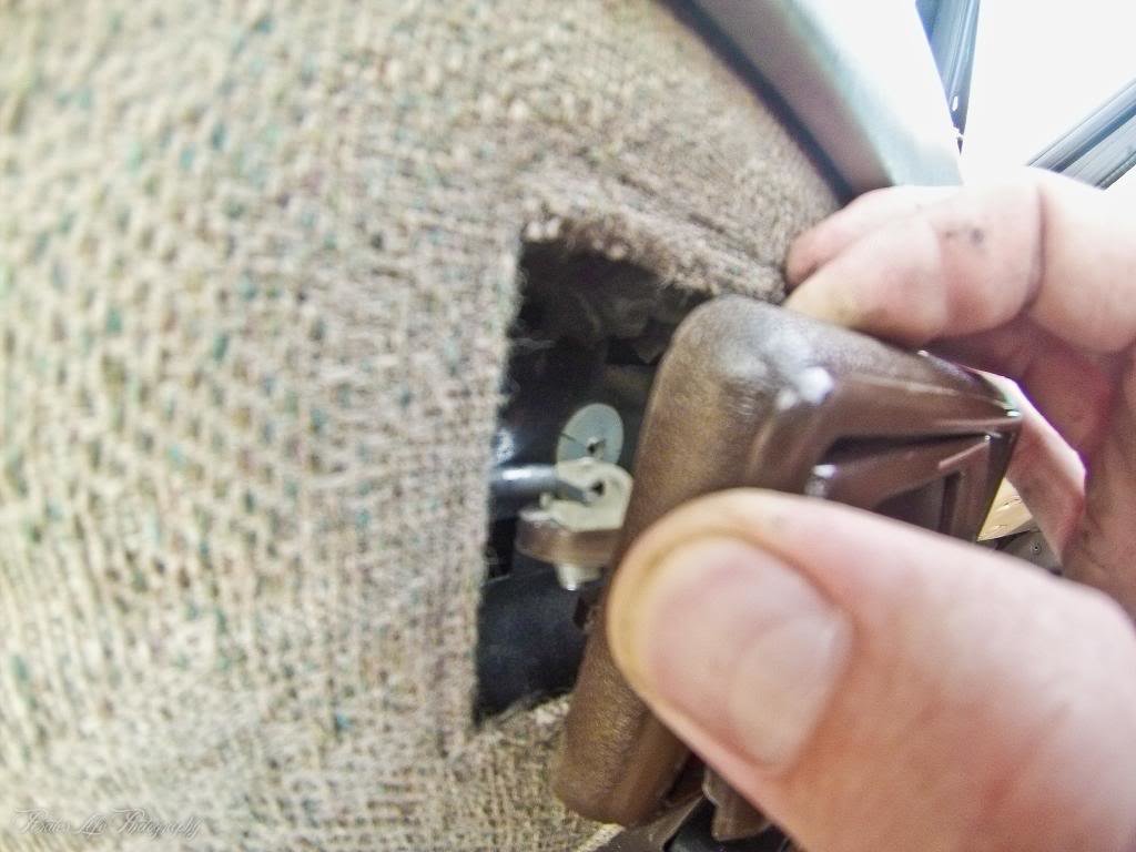

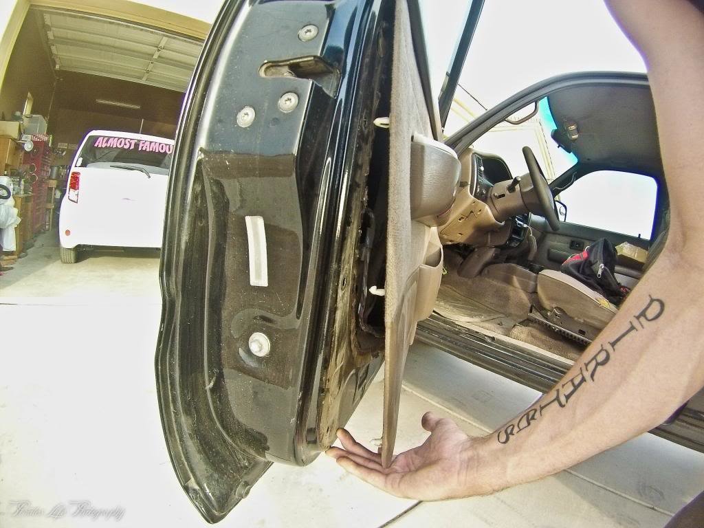

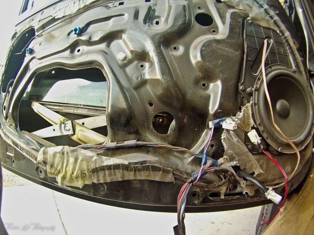

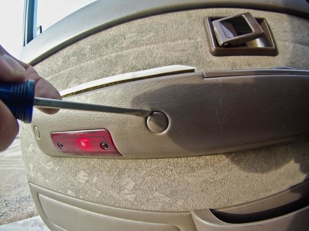

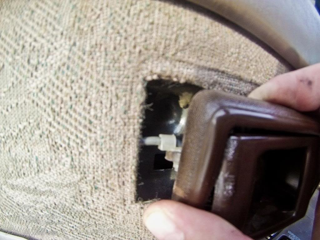

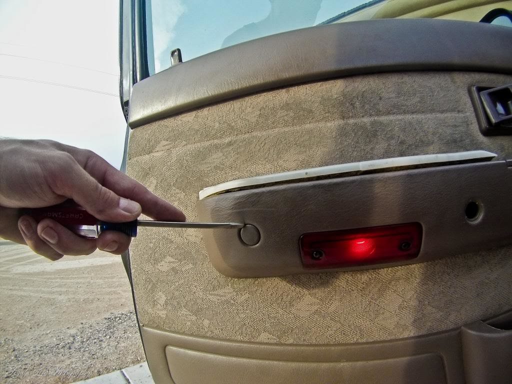

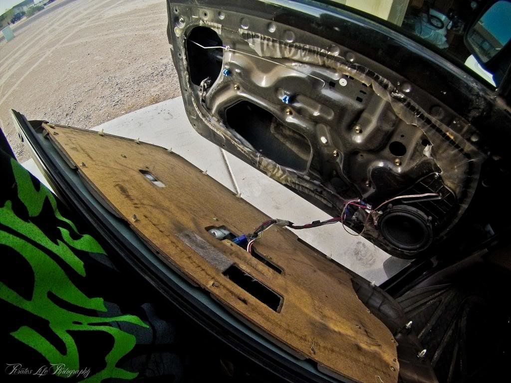

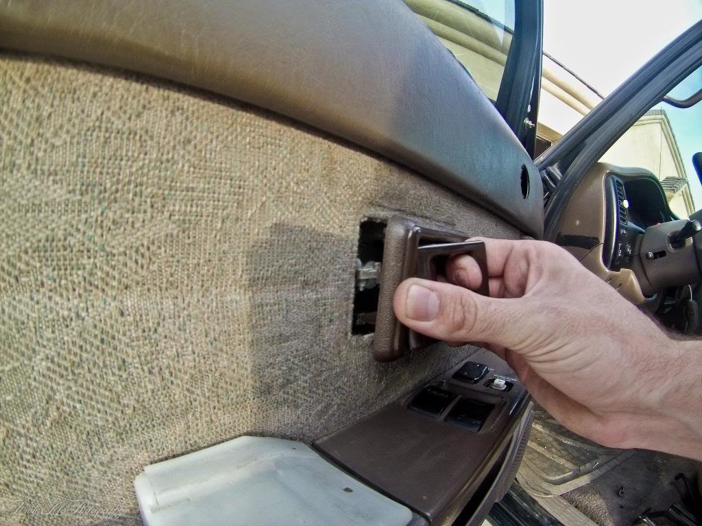

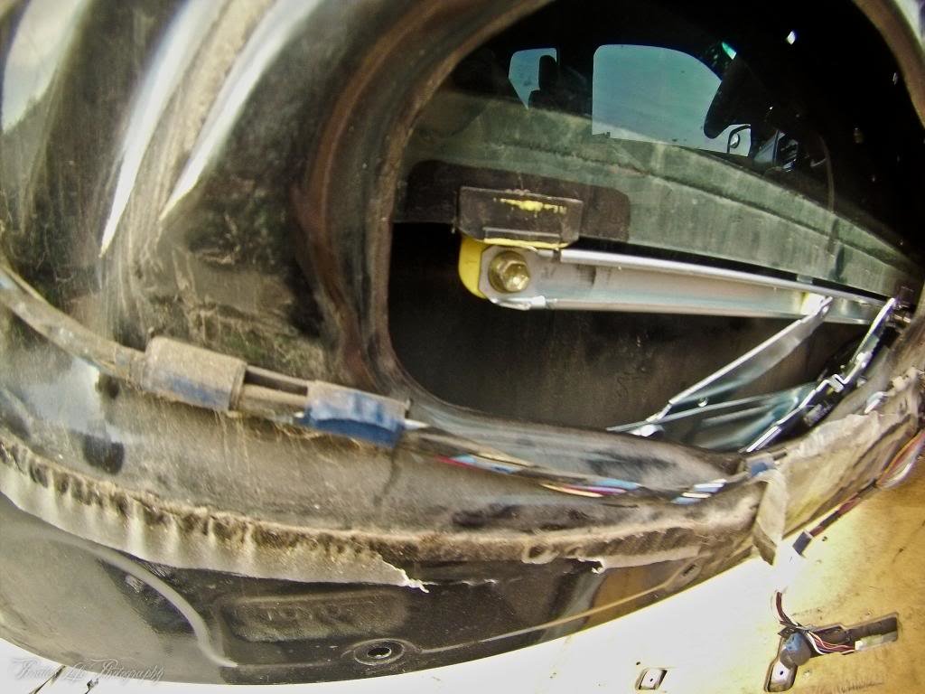

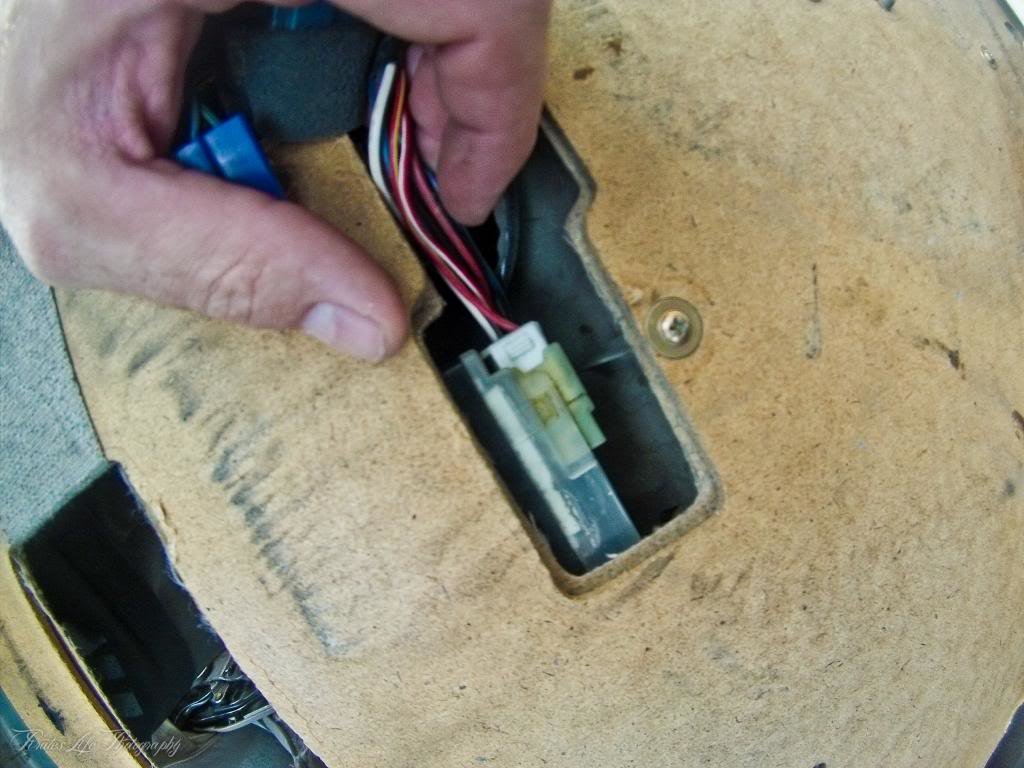

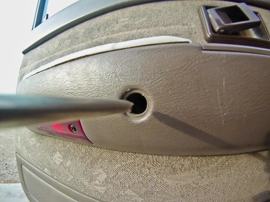

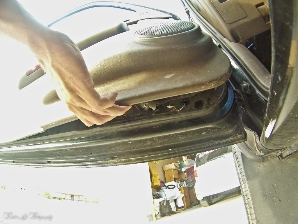

    first you unscrew the door handle
    pop out the two circle covers
    unscrew the two screws inside the door handle
    pop out the plastic clips that hold the door panel to the door frame
    slide the door handle to the inside of the cab to release it from the door frame
    make sure to swing away the clear/white clip from the door latch lever attached to the door handle so you can release the lever/bar from the handle

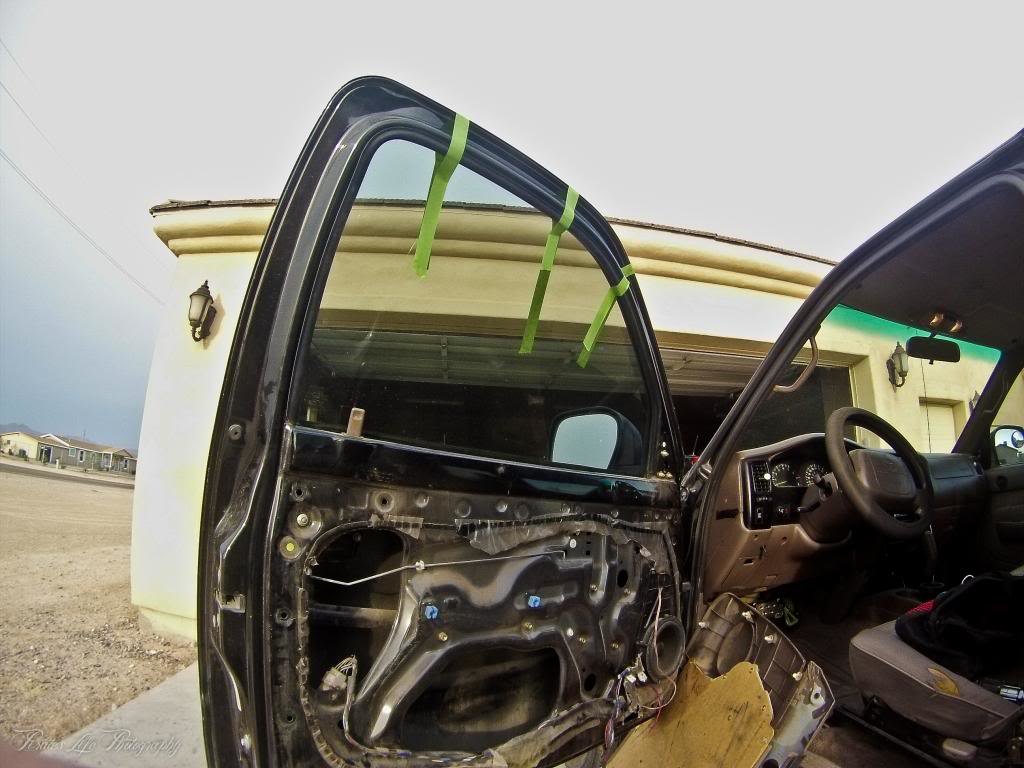

    release the rest of the door panel away from the door frame

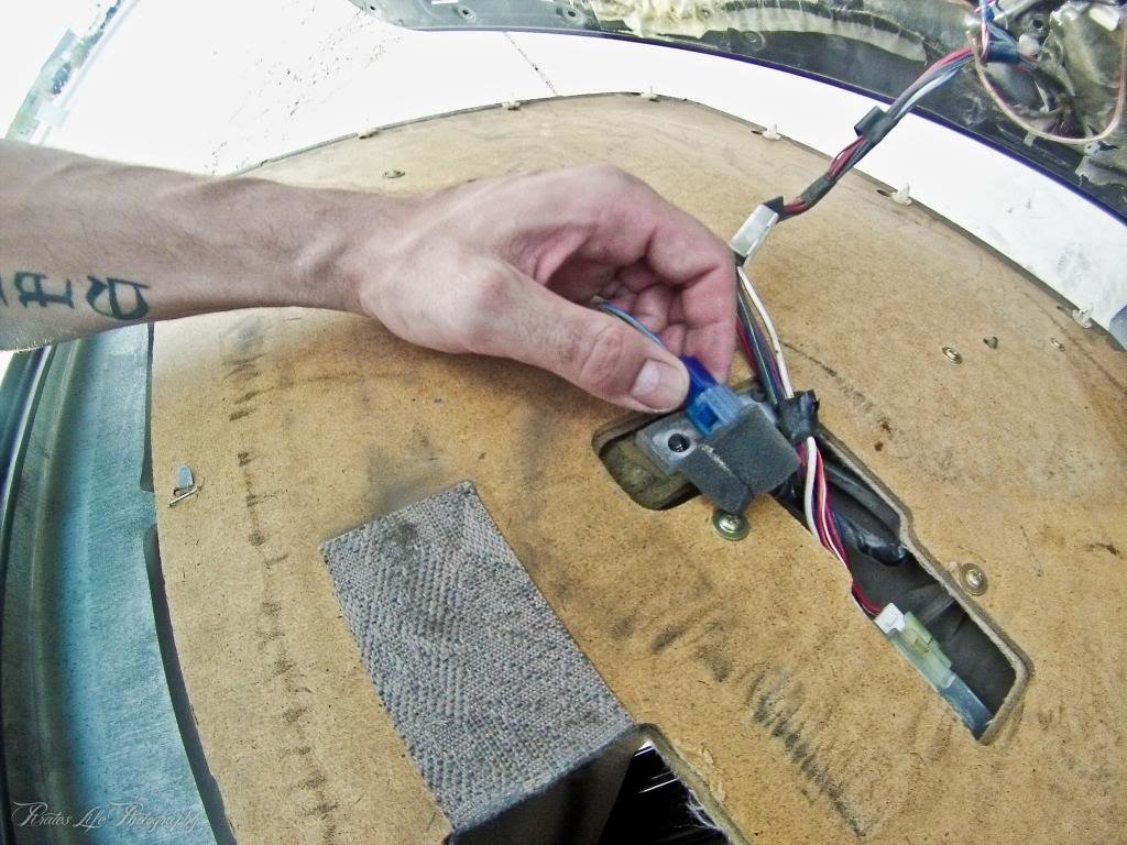

    if you are completely removing the door panel from the door frame be sure to remove the electrical connectors
    remove the connector that connects the window motor to the switch

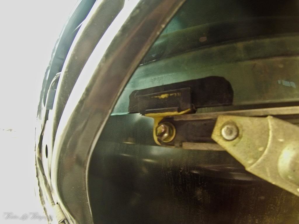

    push the window down to unbolt the window from the regulator
    i did this to help support the window when i removed the regulator bolts..

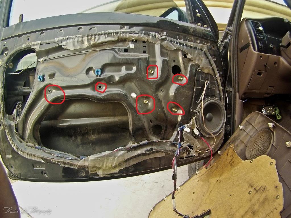

    unscrew these 6 bolts to release the motor/regulator from the door frame
    install is the reverse from disassemble..

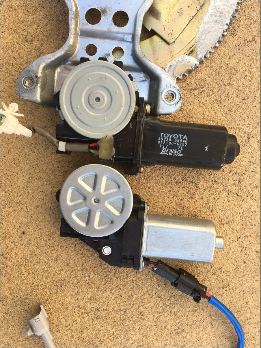

    My drivers side window would quit working every once in a while. It would go down fine but it would stop going up.
    When this happened I had to wait a few minutes and I could eventually get it to go up a little at a time.
    I replaced the Toyota motor with a Dorman 742-600. I reused the factory lift mechanism.
    I did not like the fact that the Dorman motor did not have screw holes to attach it to the lift.
    I guess the idea was that you would screw hard enough that it would create threads for the screws.
    I guess this is because the Dorman product is a universal so they couldn't put in a specific thread pattern.
    I also did not like the extra pigtail that was required to be used (blue wire in pic). It gets in the way so I had to tuck it in and tie it down.
    Really not crazy about the Dorman design but it was what my local auto parts store had and it seems to work and the window goes up and down so much better now.
