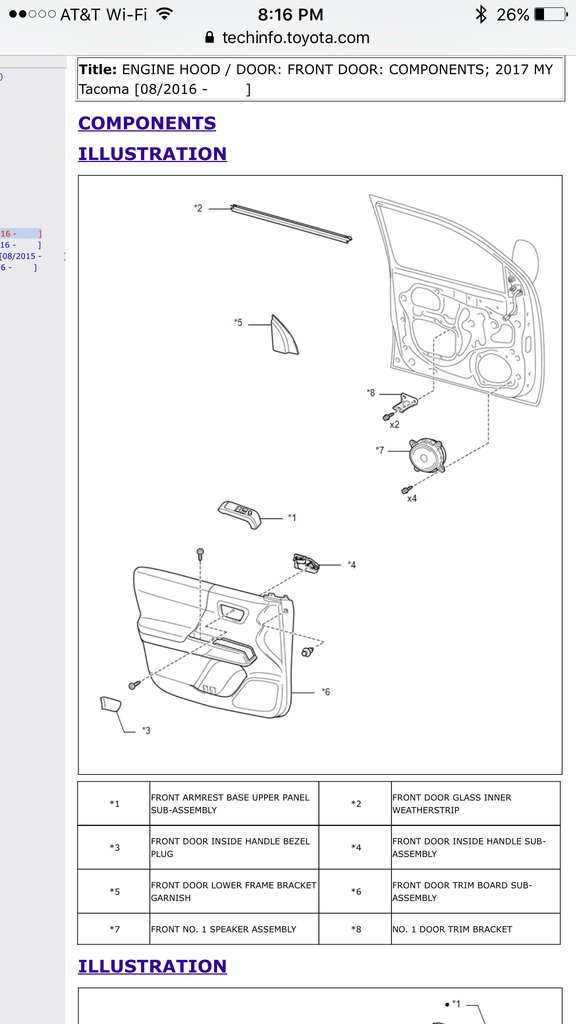

    turns out it's a $30 part per window. James @ truck shop helped out with that one. pretty ridiculous that Mossy couldn't figure that out and thought I'd bite on dropping $700

    You can pull the trim panel off the door and replace the innermoulding yourself in about 2 min
