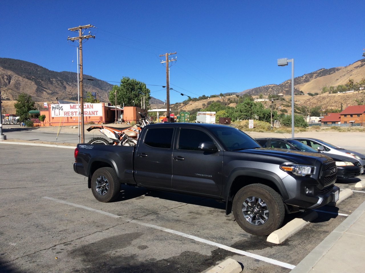

    It took me forever to find a place in socal that was under the $600-$500 I kept getting quoted.....that was to do all four doors, back window and sun roof.
    I went with the mid grade 3m film, I don't think it was the ceramic.
    Limo on the rear doors, sunroof and rear window, and I think two shades lighter on the front doors.
    It came with the back glass tinted but I like it as dark as possible and also wanted to maintain a difference between the front and rear doors....otherwise I would have gone limo all over.
    I guess it would have still been a difference if I did limo all over but I wanted to be semi legal.
    When I was there I decided to do the front windshield and I think it was a mid shade 3m crystaline....that was the top of the line film that rejects IR. Of course a week later I got a chip in the front windshield and thankfully it was repairable!
    factory...
    Limo rears, lighter front, & even lighter on windshield

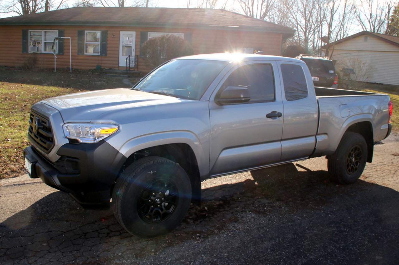

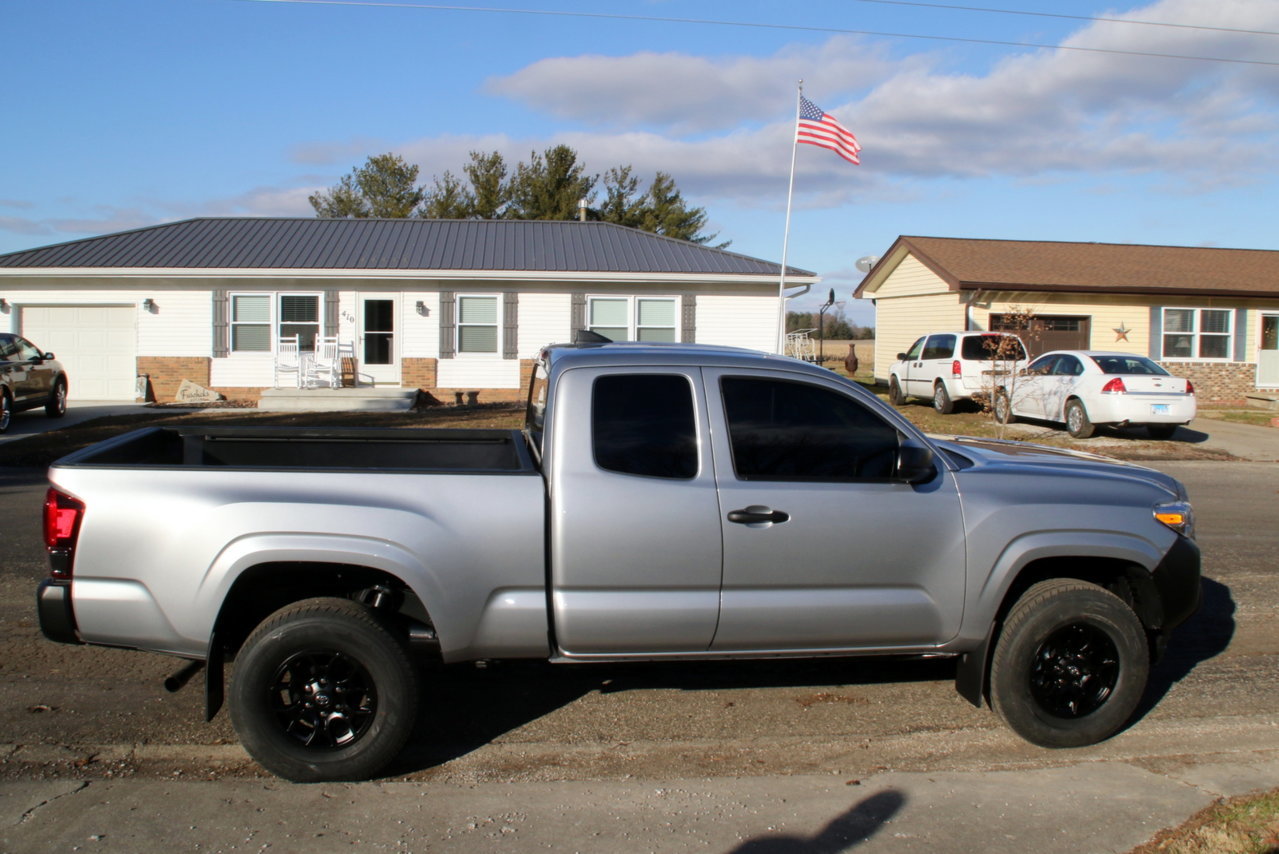

    I to wanted all 5 windows to match. I told him I wanted 20% on the front 2 and match the back 3 which have privacy glass to match the front. Tint guy has over 35 years experience so he knew what tint % to use on the back 3. He put 35% on the back 3 and 20% on the front 2. Afterwards he put the meter on them and all 5 read 14% VLT, (visible light transmission.) Just the look I wanted.

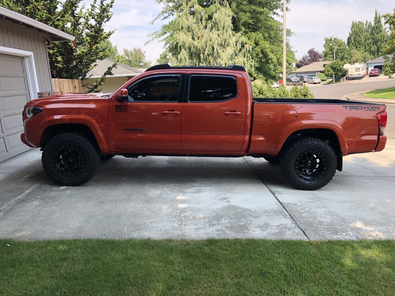

    Top is before, bottom is after.
    I went with 20% all around. The fronts are noticeably more see through but still dark enough for my liking. I think 20% is the sweet spot with not going too light or dark. They used 3M tint all around, non ceramic. They didn’t do the windshield as that seemed a little excessive to me, especially for night time driving. Ran me $200 flat and it has a lifetime warranty.
    For matching the rear you want 35%.
