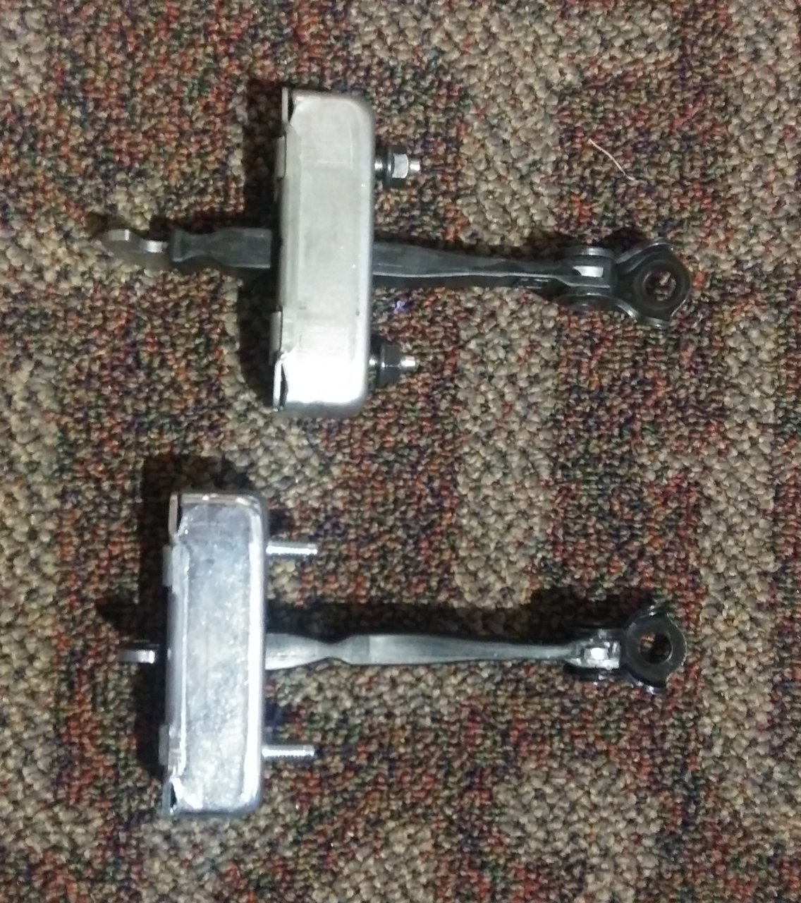

    I have a similar issue. One day I noted that my window would only roll down a few inches, there having been no incidents that I am aware of to have caused this problem. My neighborhood mechanic had me get a replacement window frame. The forward section was indeed bent, restricting the lowering of the window. So he replaced it and the window lowered properly. However, as soon as we closed the door the window would no longer lower all the way. After several efforts at mending the newly bent frame part it was discovered that when closing the door, the door check mechanism was pushing on the forward window frame, bending it again. His solution was to remove the door check completely. While this worked, I'd still like to have the door check put back, but do not want to have it bend the window frame again. Can anyone figure why this is happening? Is there a different model door check with a shorter arm (inside the door) that could be substituted?

    Your door check is bent. Probably due to the wind catching the door and forcing it open further than it should.
    Install a new door check and it will be fine.

    Well, maybe not exactly bent.... Here are the pictures of my old (top) and new (bottom) door checks. It appears that the old one had the 'waist' part pulled into the metal box, thus extending the section that put pressure onto the window frame. I would think that having the door open too much would cause the opposite to happen.20200305_111605.jpg
