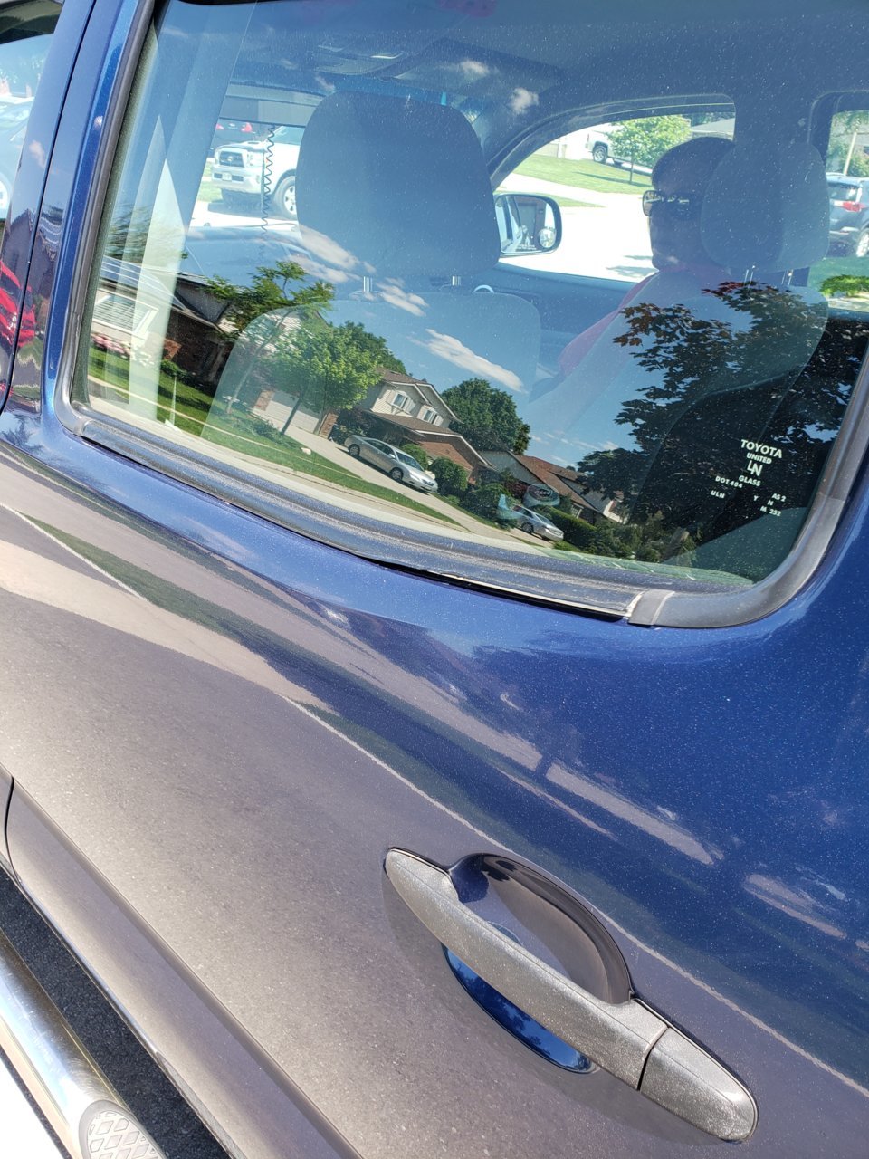

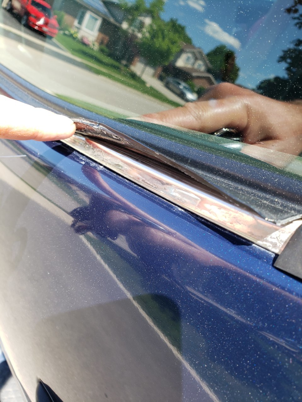

    I've tried tucking it back in or gorilla gluing it down. Nothing is working. Any other suggestions would be appreciated

    Remove old paint, sandpaper, and mask-off
    Black matt spray paint.

    I was thinking that. Doesn't the rubber keep the water out of the inside of the door though

    Time for new parts OP.
    This happens from a large number of things,
    Sun, attempted theft, age, cleaners....
    Not hard to replace, not to expensive. Patients and plastic trim tools really help

    Super easy fix. Get a new one and replace.

    Yes. It’s a replaceable part and has its own part number. Don’t have that. I’ve replaced mine. It’s was like a $ 30 piece I believe.

    68230C I believe is the part #

    You can use 3M Black Super Weatherstrip Adhesive. This stuff works great.

    I just replaced four of those on a Corolla. They just pop out and snap back in. The Tacoma looks a little more involved because a single piece runs all the way around the window instead of just a stick at the bottom. I did all the way around the driver window for about $100, then did the bottom trim piece only on the other three doors for a little more than that. None of it was hard.

    The Tacoma is a strip at the bottom called a Window Belt Trim. It snaps out and the new one snaps in.

    Replace with oem or 3m wrap it . I had a 2016 canyon with chrome trim and I hated it . I bought a roll of 3m black matte wrap and covered it and tucked the edges and then hit it with the heat no more chrome

    Yep. Just roll the window completely down. It can be removed from the outside. Snap the new one on.
