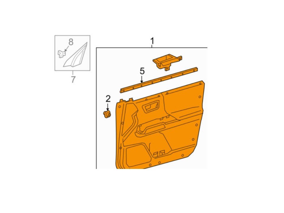

    Easy Fix.
    Just pop the plastic panel off. Go buy some 1/4" foam strips with adhesive backing. Attach to the door between the painted metal and window seal . It pushes the inside seal out and put pressure on the window.
    I initially tried 1/8" neoprene foam, however that compressed after awhile and the rattle returned. I doubled it up and it fixed it.
    You really can't tell the foam is there once you put the panel back on. The clips will stay in the door when you pull the panel. Take them out of the door and put back into the panel before you attempt to reinstall.

    My window didn't move at all front or back, it would push in an out. My tapping noise was the top of the window tapping the weatherstripping causing a noise when partially down. Reproduce-able by just grabbing the window and moving in and out.

    Thanks for this! How does the initial panel pull off? Is there a good play to pull it from?
    I'm guessing you roll down the window and pry off?

    Theres a push-pin that you need to access when the door is open. Press the center circle in and it pulls right off.

    Its just that A pillar panel for the side mirror. Its separate from the door panel. Item 7 in the pic
    You just grab the panel, you can catch the lip close to the window, and pull it straight out. There are only 4-5 of those red tab retaining clips that hold it on.
    having the window rolled down helps as you can push the inside seal out and install the foam behind it.
