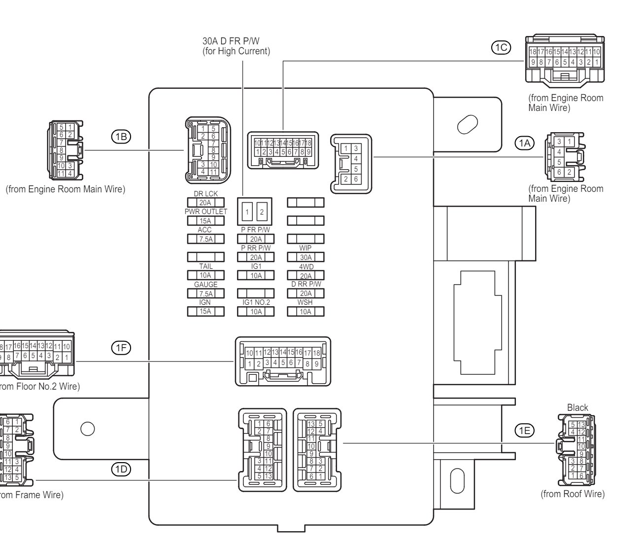

    Pull the 20A DR LCK fuse and see if the windows work.
    I doubt it will......But that fuse is tied to the windows.

    That fuse is on the drivers side, behind the little cubby door thing.

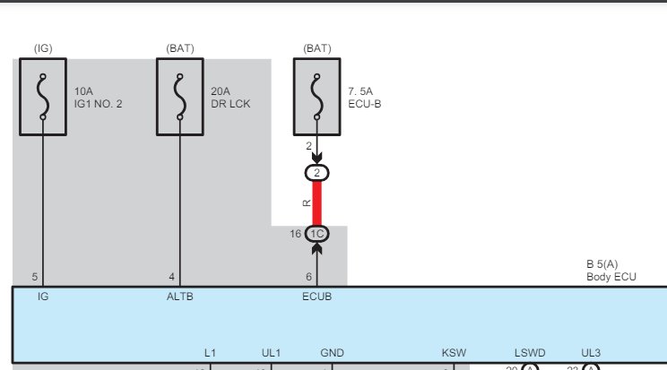

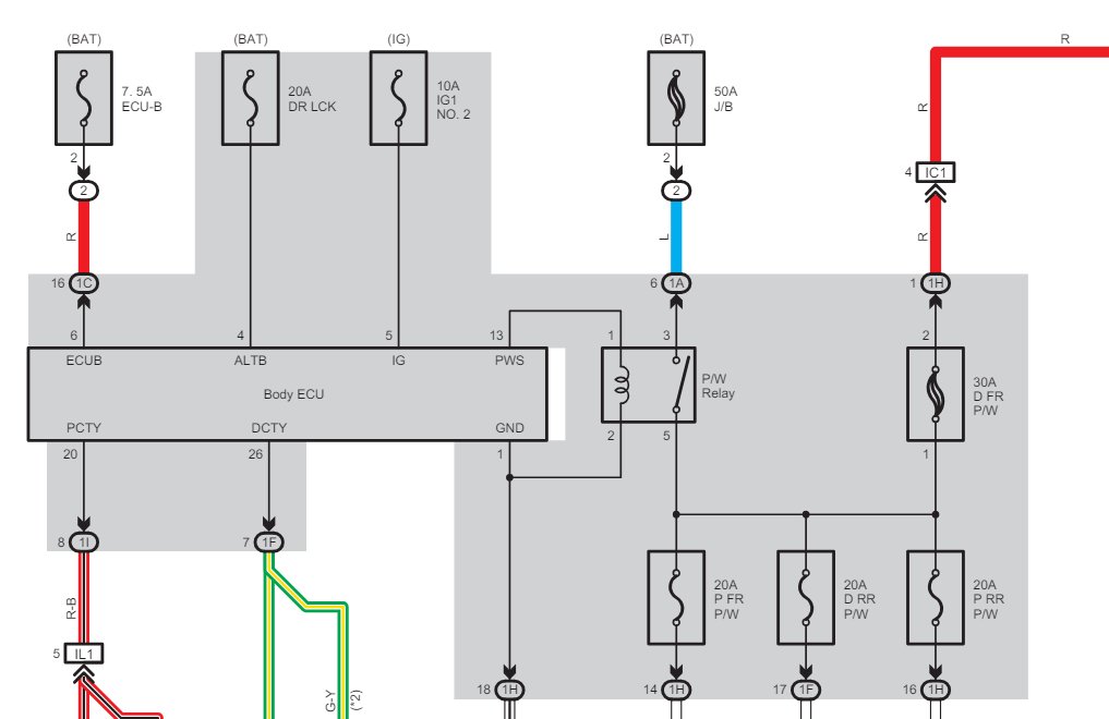

    Dropping this here to show the "commons" between the 2 systems.
    Focusing on the "kill power" system resets and works for a short time.
    A hint would be: Only a battery fuse "fixes" the issue. (batter disconnected)
    No need to focus on ignition powered fuses.
    Sticking Relay? Or Body ECU?
    Power Window
    Power Lock.

    When this happens. Pull the 7.5A ECU-B fuse. Then reinsert it.
    See if that makes them work again.
    I'm still trying to figure out power needs to be killed, to "temporarily" fix the issue.
