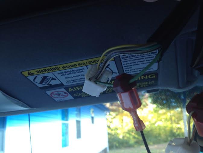

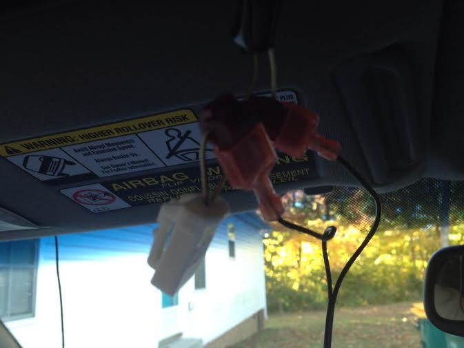

  11. Oct 29, 2014 at 7:05 AM
    bradforj
    bradforj Well-Known Member
    Oct 29, 2014
    #141282
    439
    TN
    07 4x4 v6 TRD Sport
    2011 grille 2014 steering wheel swap w/audio and BT controls 2014 power window controls 2014 lower center dash and radio bezel 2014 a/c controls Auto-dimming mirror Heated side mirrors Turn signal side mirrors Backup camera DNX890HD head unit Kenwood speaker system Kobalt slim toolbox In-channel Ventvisors N-Fab running boards
    This post originally asked for info on which wires above the compass were the ground, constant power, and ignition power. I have updated the post with the info since I have figured it out on my own. Hopefully this will help others.
    constant power: map light wire WITHOUT black stripe
    ignition power: green wire from compass
    ground: map light wire WITH black stripe
