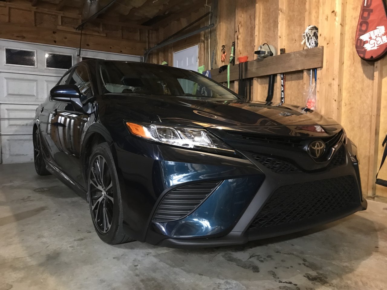

    Finally managed to get an appointment for getting the replacement glass installed. Dropped the truck off this evening and picked up the loaner. 1BCC21C1-2FDE-4608-8770-99D3609D19B8.jpg

    Hopefully you won't be stuck in a car too long and they will have your truck back, they stuck me in a Honda Fit last time...
