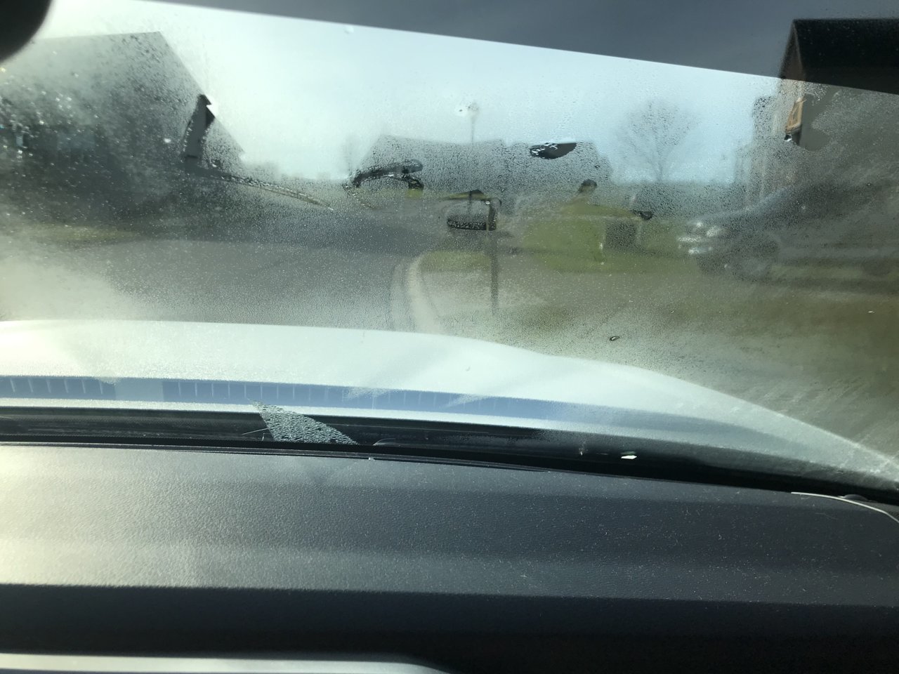

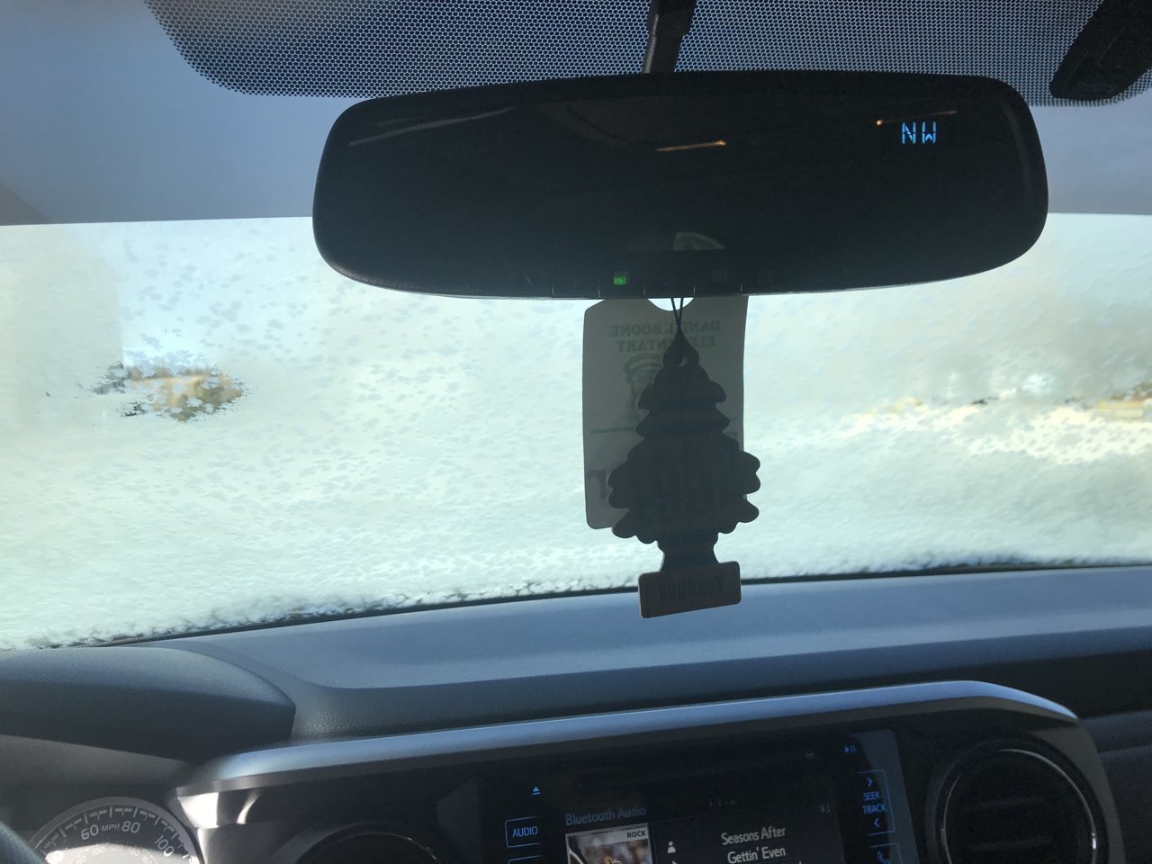

    2016 Tacoma limited, frost and condensation issues inside the front windshield. Dealership says normal. Toyota corporation says normal. I’ve never had a vehicle do this. No resolve from Toyota under the 3yr 36000 warranty.
