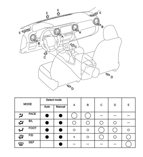

    Yep I believe there was a thread somewhere up here about this. It does it during certain temps/humidity levels because pretty much no matter what vent setting you have on, there is always a little bit blowing on the top vent (where it hits the windshield) and causes it to do this. I'll have to see if I can find the picture of the flows.
    Edit: Found what I was looking for. So it's actually a little different but you get the idea. Depending on your environment it will probably fog up. I've had plenty of cars do this at the same time every year due to the humidity we get here in the south.
