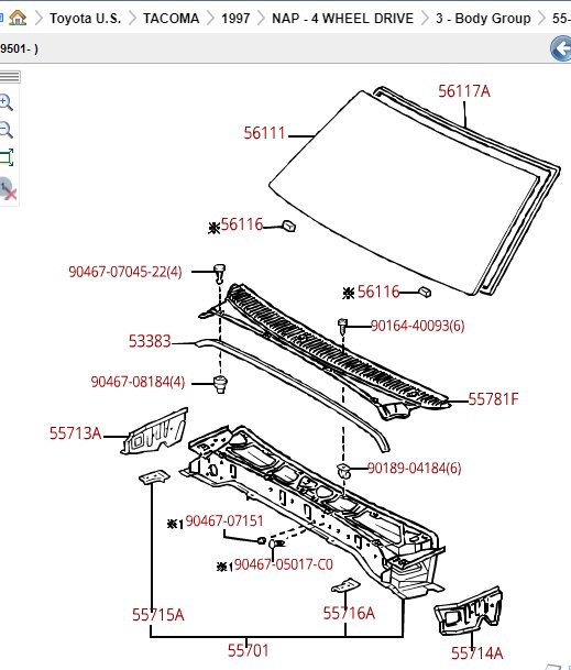

    Here's a little bit better picture with the part numbers to the clips.

    the rubber weather stripping (especially at the ends) i think is not very snug (the ends are quite loose and moveable) so now I think it was not reinstalled properly by the place that replaced my windshield
    maybe the clips that go into grommets? (part# 90189-04184(6)) and were broken and this is why everything seems loose

    Where can I order the 90456-07045-22(4) plugs online?

    The part number you're asking about returns nothing in a Toyota Database search.
    I assumed you just typoed and meant '90467-07045-22', I assumed this based on the matching numbers to the diagram posted above in thread. This '90467' number is common and you won't have a problem finding. It is used on 5 or 6 different Toyota models for securing that cowl piece.

    No sorry, I need 90467-08184(4)
