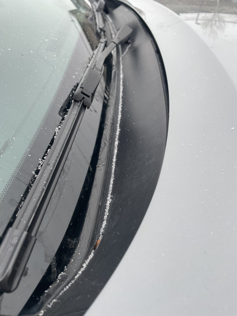

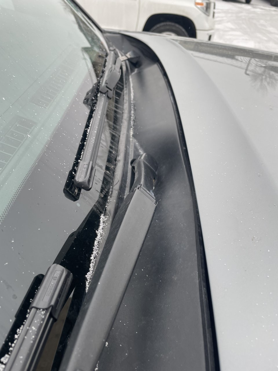

    Man that thing is so easy to replace… I pulled it off to seal the gap on mine and it took about 15 minutes all in. Pull the wipers off and it’s just a few clips. Water will drain right through those gaps onto the cabin air filter and eventually it seeps into the fan. If you have access to a garage there is no reason not to just change it. All this “reshape it” shit man cmon

    That rubber strip does play a part in directing rain water off the glass and into the trough where it can drain out via the wiper holes or the corners. Not sure the damage is bad enough to leak normally, but it might during heavy rain or a carwash.
    Id try a junk yard first for the part

    My guess is it’s not the labor but that fact that it costs 500-600 bucks for a new one. I’d certainly be trying a home repair before spending that much.

    yeah, closer to $700... but same shit.. too much
    agreed
