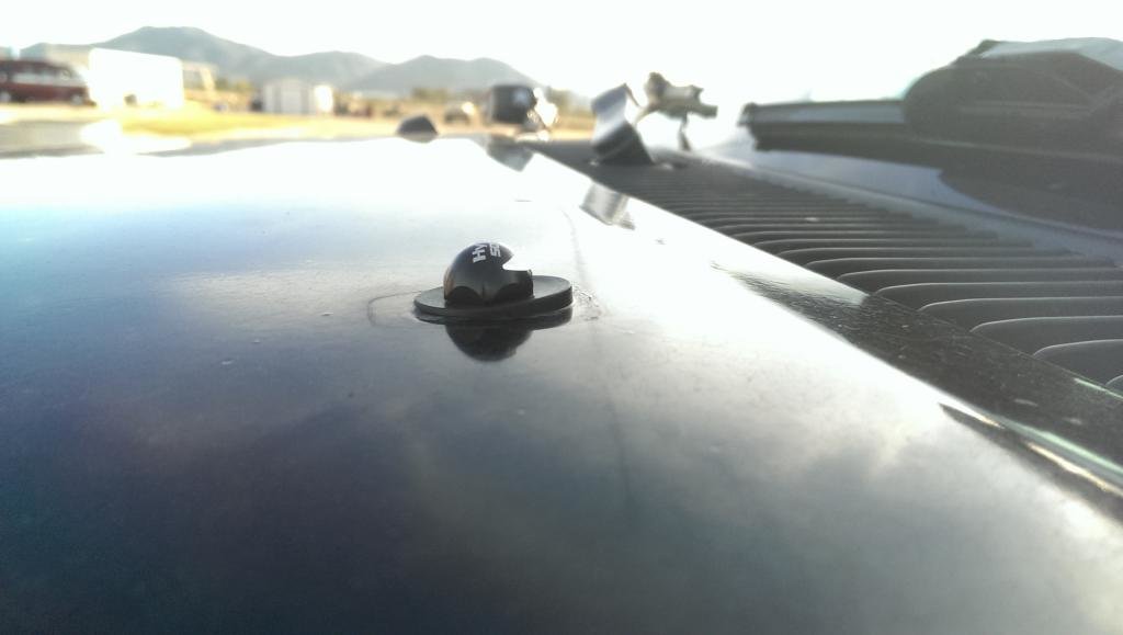

    Oh I see now. Hmm.. also I was looking on eBay, and saw some for the Tacoma that instead of two little jets, had a single little square in it. I wonder what those are? Maybe a single 'fan' spraying jet? See if I can find it again..
    Here it is, except these point forward too:/
    http://pages.ebay.com/link/?nav=item.view&id=301107070769&alt=web

    #25
  6. Dec 8, 2014 at 5:42 PM
    #26
    NightProwler
    NightProwler Well-Known Member
    Nov 12, 2013
    #116470
    3,447
    Harlan
    Maricopa, Az
    '01 Prerunner, '16 trd4x4, '09 R1, '03 cbr954rr, '03 rc51
    #26
  7. Dec 8, 2014 at 5:51 PM

    Hmm you should order those up. We can be the guinea pigs, then compare. I just ordered those hypersonic ones. $15 with shipping. I'd imagine the oem sprayer type is gonna be much better though. As long as they fit.. And these hypersonic ones have little locking washers, as well as the tapered rubber washer on top to adjust angle.

    Well I got those hypersonic sprayers in the mail today, installed, and they are worthless. Bummer.. Oh well. Worth a shot. Got a comparison of that one and the autozone one for ya. The autozone one isn't really that bad. It sprays pretty nicely, but does kinda spray to far. Ends up spraying out to the sides and over the roof. They are adjustable. But I found that it needs to be pointed at the highest to get a nice spread. And yes I know the passenger side autozone one is kinda adjusted too far left, but this was just a quick video to show the spray. I tried adjusting the nozzle on the driver side autozone one and I guess I screwed it up. It doesnt spray very good now.. I may just buy another set from autozone and call it good. Unless you guys found a good one yet??
    http://youtu.be/qVtDZSN_oOQ
