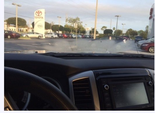

    Fogs like dis?

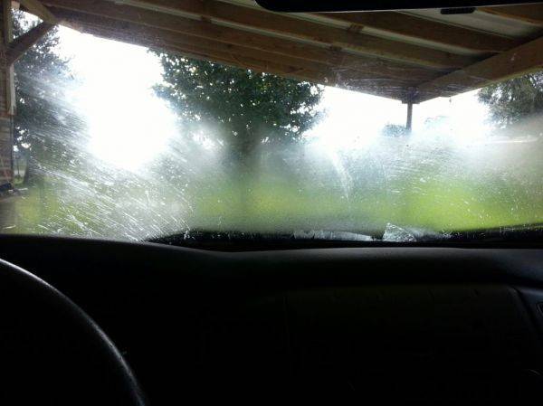

    I just went and started my truck AC on high because its freaking hot here came inside to write this, about to walk out to take the pic. My truck is under the carport, the temp is 84.6 feels like 97, humidiy is 82%.

    The fog is normally on the inside of the vehicle, same as in this picture. The inside of my whindshield is clean that nasty look in the picture is due to it being Love Bug Season! I normally clean the front of my truck every other day to help control the love bug stains. I'll look into the diverter door when I get a chance tomorrow.

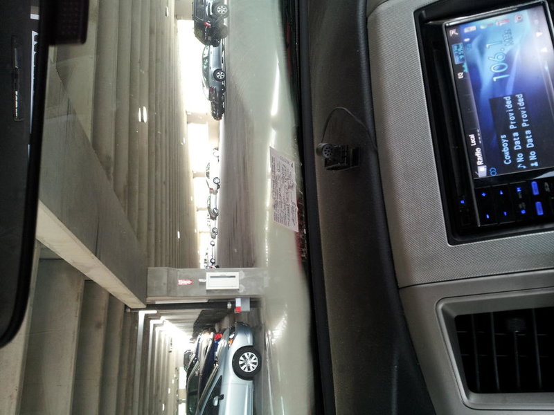

    EB8141C2-5C70-40E2-9D7A-7AF29883D600.jpg It’s not there when parked in my garage, it’s only there while driving/truck running with the AC on.
