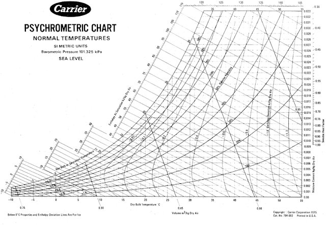

    Y’all are trying to correct something that you may limited success with correcting. Unless you can change the psychometric chart.
    Seen this on plenty of other vehicles.
