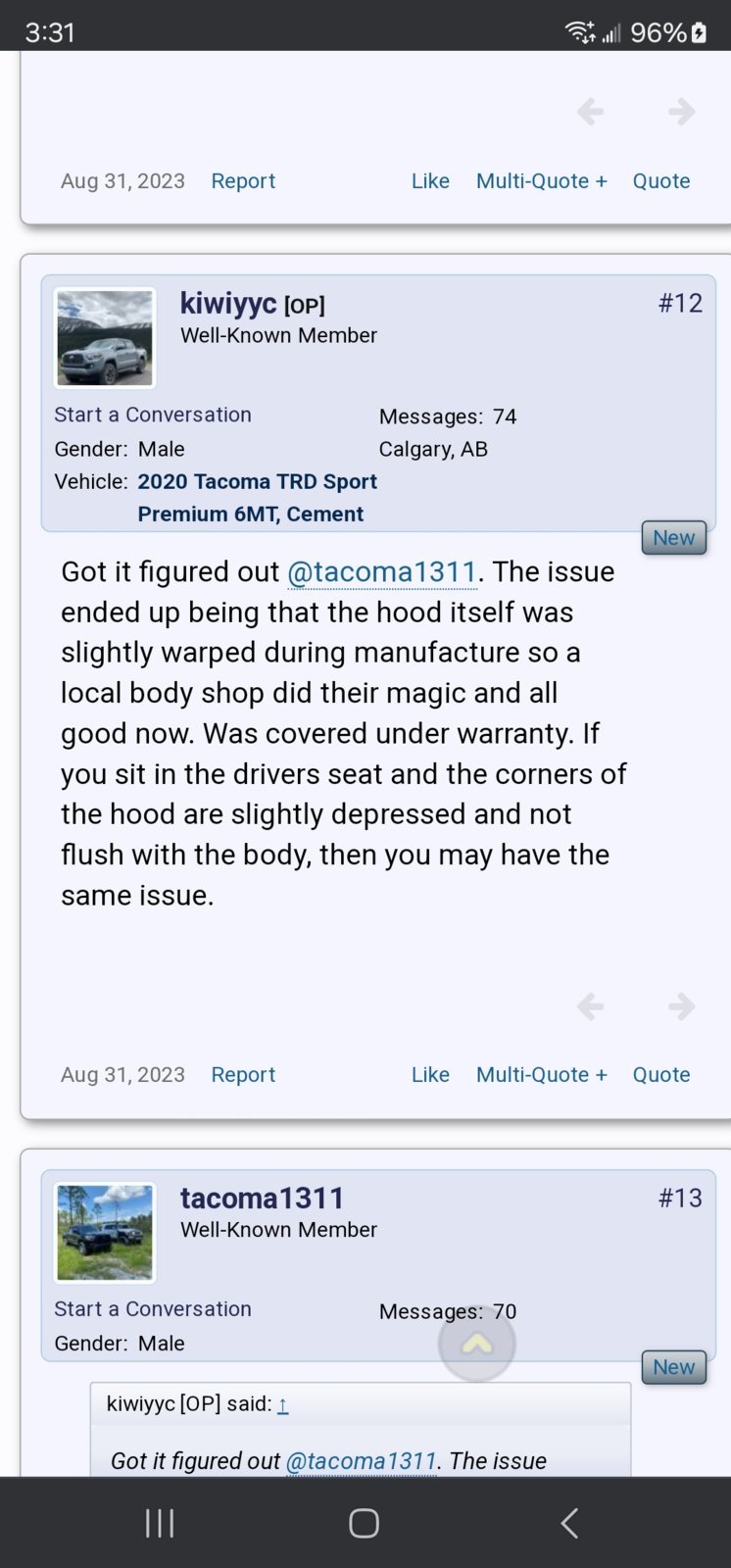

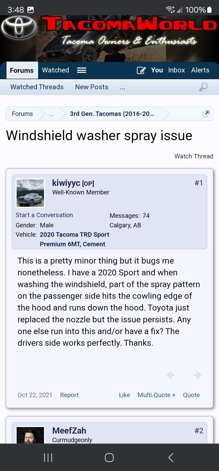

    Screenshot_20240322_153120_Chrome.jpg I did a little searching and found another thread with your same sprayer problem.
    kiwiyyc likes this.
