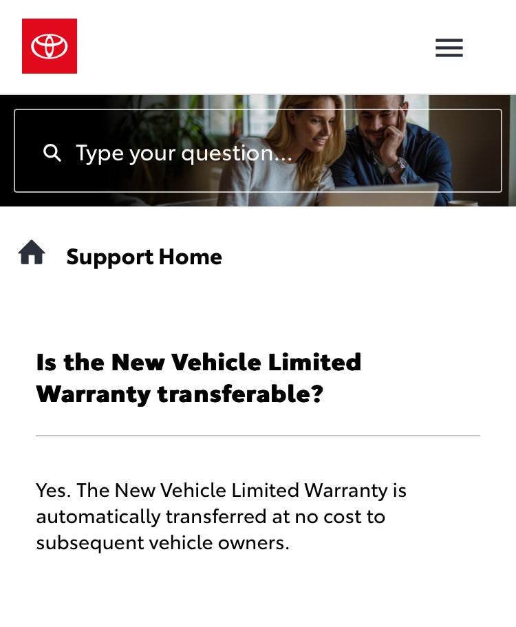

    Yup, saw this and showed the tech!

    I don’t think you’re catching on. The manufacturer bumper to bumper warranty in effect for the nozzle issue is a 3/36. The gold certified provides a 3/36 from date of purchase. I don’t know when the vehicle was first sold but let’s say six months. If so, paying for the vehicle to be certified, which ain’t cheap, would have only gained you six months of additional bumper to bumper.
    You think they give different service to a verified preowned than they do to a manufacturer warranty? Why would you think that? You think they roll out special red carpet service for certified? They’re both backed by Toyota and serviced by the dealership. They are, in that sense, identical. The service would be identical. The coverage would be identical. You should be thankful you didn’t pay the extra couple thousand bucks or whatever it is for certified. With the same money you could buy an extended warranty instead.

    I hear you. Truck was purchased by the dealer as a loaner to customers in Feb 2023. Sold to me on March 14th, 2024 with 6000 miles. I guess my confusion was that since its used, manufacturer warranty ceases and "used car" warranty comes in to play. Toyota has stated that new car warranty ONLY transfers to certified used. Hence my insistence of the certification. But I hear you. I will find out sure enough on Monday.

    Nope. The dealer is FOS. The original factory warranties stay with the vehicle regardless of you being the second owner. It does not need to be certified.

    Who told you the manufacturer warranty doesn’t transfer? They need to be fired.
