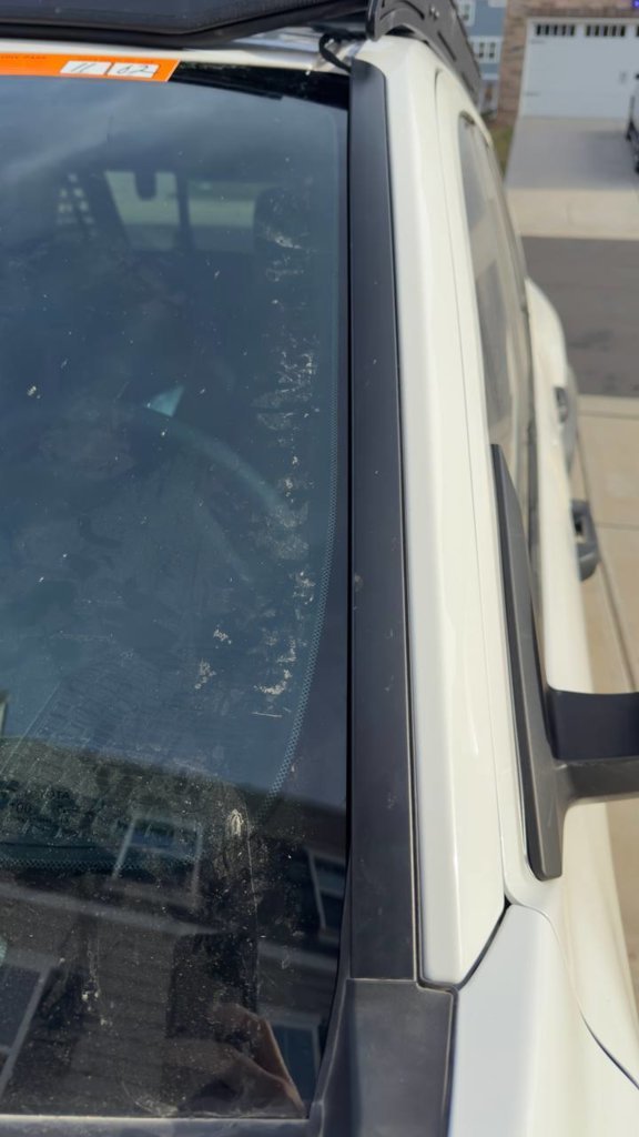

    Does anyone know how to remove these black plastic along side of the windshield? i looked at the but is hard to see and i dont really want to break it or bend it. Want to see if i can fit 14AWG light bar wires there

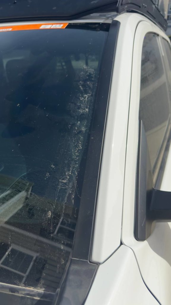

    i hid it under that plastic. looks good to me

    How did you get the wire under there? Did you remove the trim and reinstall, or were you able to flex it out of the way without removing it?
    Stevie17 likes this.
  6. Nov 5, 2024 at 5:50 PM
    sogtr
    sogtr [OP] Well-Known Member
    Sep 2, 2023
    #432624
    81
    2024 Tacoma Trailhunter Ice Cap
    i removed the trim and reattached it, but i think you can flex it enough to fit the wires with a plastic thin tool. i was able to fit 2 x 14AWG wires just fine. If you pull it up a bit with a tool you will see 2 small white tabs (hook like) and i used another need like tool to pry each of them and it came off. I think there is 4 or 5 total.
