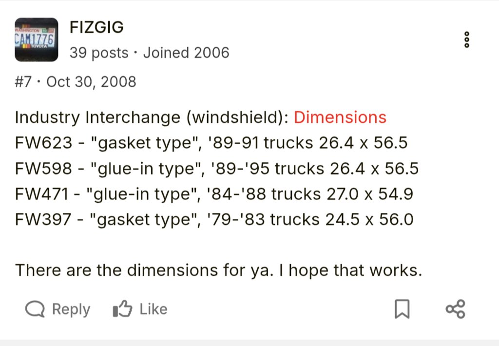

    84-88 and 1st gen 4Runner - gasket seal part number - 56121-89117
    Searching domestic (U.S) auto glass vendors, there is only one size windshield available for glue in apps for 84-88 that is too big to run the rubber seal / gasket

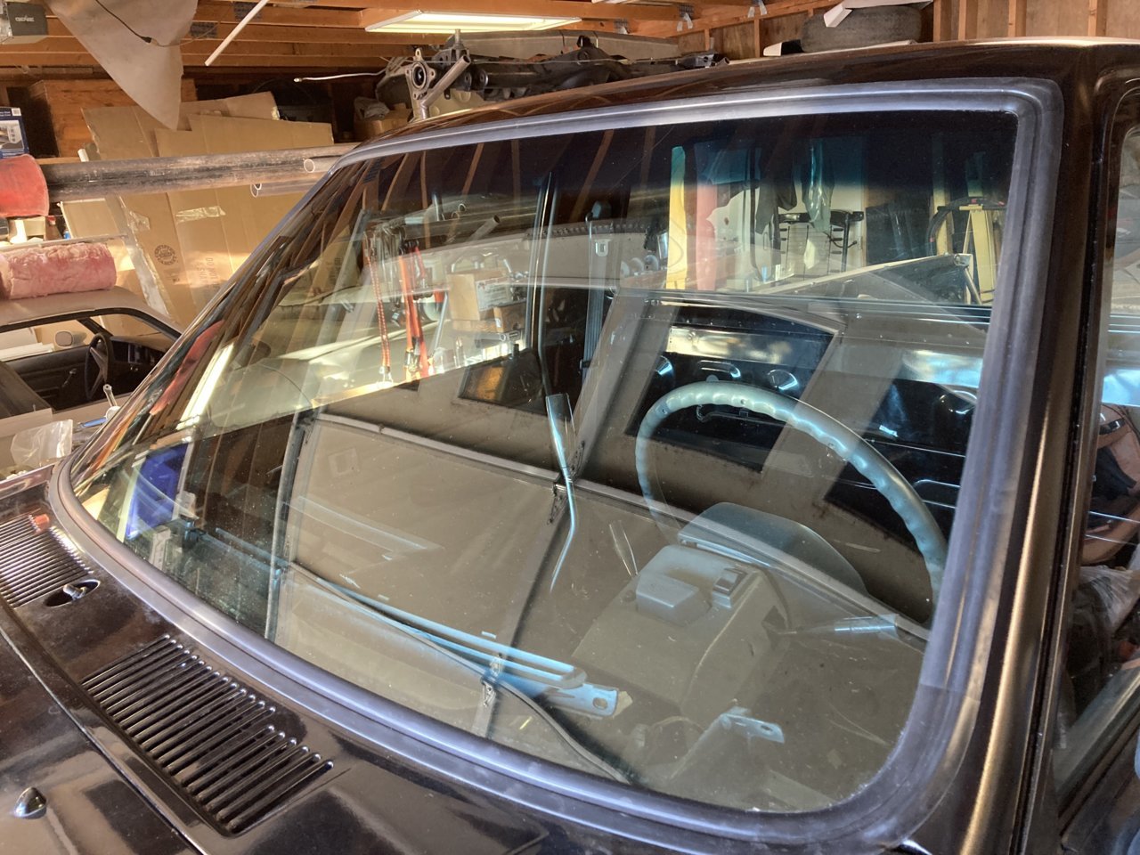

    My solution - I trimmed the cabs sheet metal lip , about 1/8th inch each side , maybe 1/8th to 3/16th top and bottom and got a great fit using the standard US “big” windshield
    if you’re going to do this, take your time, better to trim too little and then have to trim a little more than to remove too much and have to add material back
    Supposedly you can also trim the windshield glass to the smaller size but being a metal fab dood , trimming the metal cab lip was something I felt more comfortable trying
    89-95 info - gasket seal part number - 56121-89121
    Or browser search LN85 windshield seal rubber or something like that

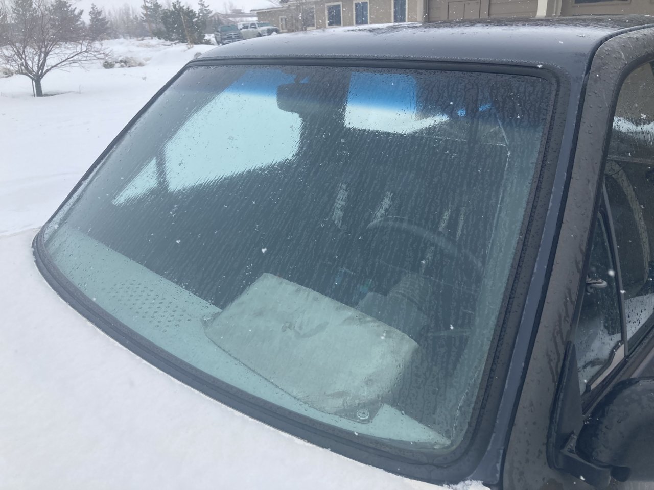

    You CAN buy the smaller windshield for 89-95 in the US needed to run the rubber seal

    My 1987 below where I trimmed the cab lip and used the bigger US windshield for glue-in apps
    My 1989 below where I ordered the correct and US available smaller windshield for rubber gasket seal apps

    I dont think the 84-88 and 89-95 windshield’s are interchangeable
    For my 87 i used a windshield for 84-88
    For my 89 i used a windshield for 89-95
    i thought my post was very clear but whatever internet

    Well, it sounded to me like the windshield themselves are not interchangeable. But the combinations of:
    larger windshield glued-in
    - or -
    smaller windshield w/ rubber gasket seal
    are interchangeable. Correct?
  9. Apr 8, 2025 at 1:44 AM
    Happysmiley
    Happysmiley [OP] Well-Known Member
    Jan 30, 2012
    #71746
    393
    Fabien
    Northern NV
    89 pickup 87 pickup 2016 4runner
    Yes I believe the cab / window metal is the same for both style windshields
    Yes bigger windshield for glue-in with the clip-in trim
    Yes small windshield is for gasket / boot install
    84-88 i could only find big windshield so i modified the cab metal window trim to fit the big windshield but using a gasket / boot
    89-96 you can get the find both the big and small windshield so pick your install style, glue in or gasket / boot and get the correct windshield to match

    Looking at the picture from Happysmilely of the rubber gasket install using the smaller windshield and corresponding gasket #56121-89121. Looks like that install was done on a 1989 Pickup with the next a Gen.5 body style. Just would like to confirm that combo works with the 84 thru 89 Gen.4 trucks as well. If that combo of the smaller windshield and the rubber seal works on my 1986 Pickup then it's a no brainer. Able to do the sheet metal work no problem but would prefer to maintain the original integrity of the stock frame and make it a plug and play mod. Happysmilely, words of wisdom?
