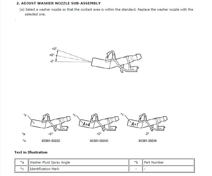

    The service manual shows three different washer nozzles available, in; -2, 0, and +2 degree spray patterns.

    Try to stick a pin in the hole and adjust the spray direction upwards, I have done that on all the vehicles I have owned. If that doesn't work, I guess you will need the part listed above by splitbolt. Good luck. Should be an easy, inexpensive fix.

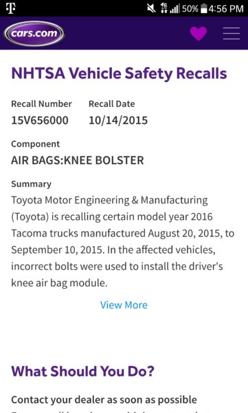

    That is an old recall notice, but its all I could find. Not sure if that's the one he is talking about.

    I haven't called the dealer yet, but I had a voice message saying that my 2016 tacoma needs to come in for a recall. Something about moisture intrusion into the air bag inflator assemble that can cause it to rupture in a collision and send metal fragments into the occupants, that's what the message said, and then to call a dealer to setup an appointment.

    I didn't see Tacoma on the current list of affected vehicles. There was an expanded list released a couple days ago, I haven't seen that one yet. Its really not a big deal, mainly if you live in a humid area. All that will be changed is the inflator cartridge. I'm surprised they have ample supply of parts available, I had to wait 6 months for my dodge to get updated, and I live in a priority zone( high humidity).
